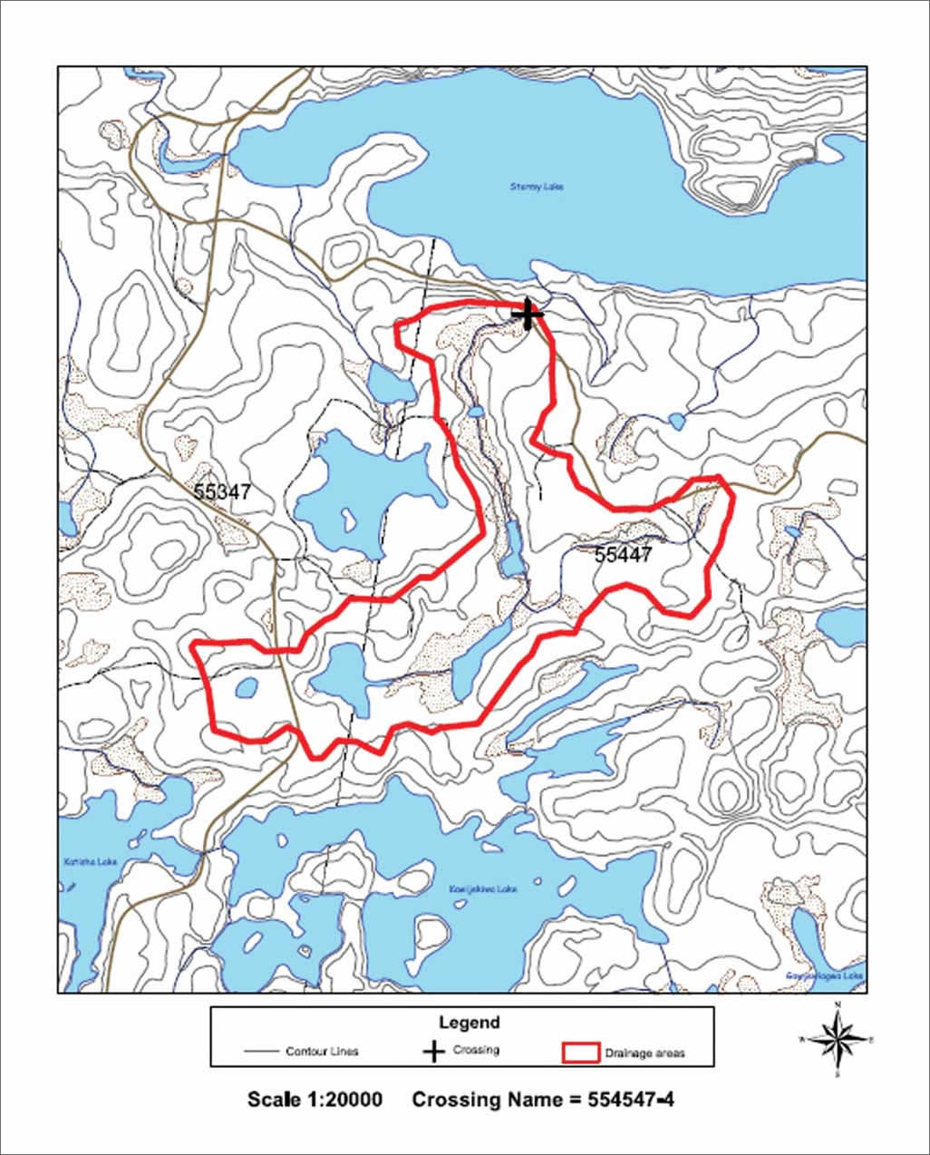

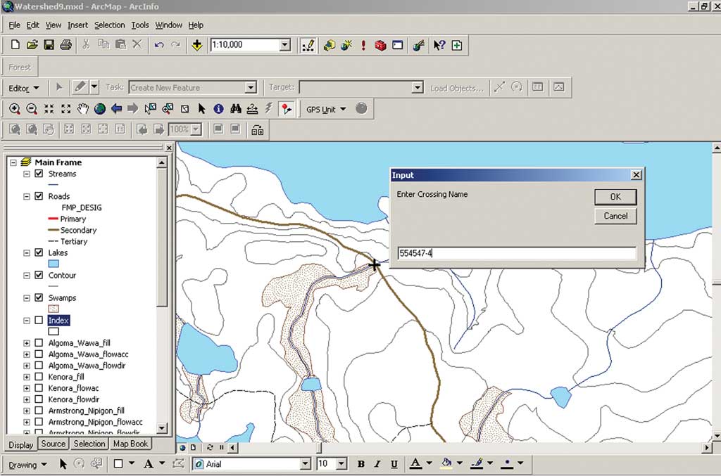

Foresters and forest technicians can click on a proposed crossing location, and the application determines the associated drainage basin by analyzing raster layer data. The data includes hydrologically corrected digital elevation model (DEM) data, flow accumulation, and flow direction along with Domtar's forest resources data.

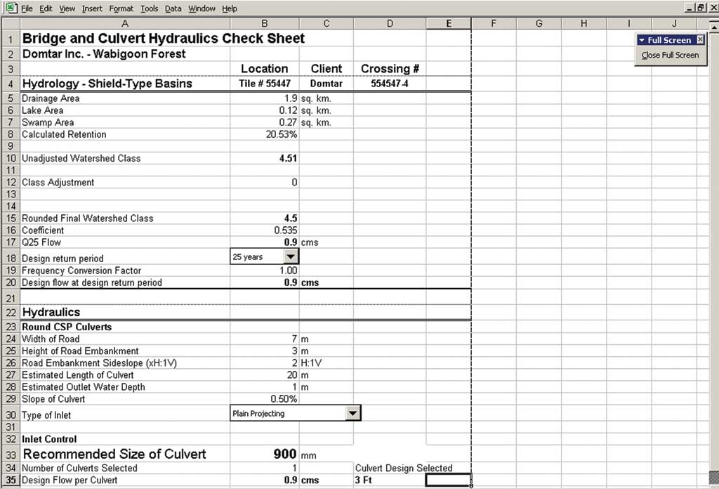

Domtar set out to improve the accuracy and timeliness of its road building activities by using GIS as a framework. The company created an application using both ArcObjects and the ArcGIS Spatial Analyst extension that automates the process of performing water crossing calculations. A proposed crossing location is identified by clicking on a map, and the application determines the associated drainage basin by analyzing raster layer data from Ontario Ministry of Natural Resources (OMNR). This layer includes hydrologically corrected digital elevation models (DEM) data, flow accumulation, and flow direction along with Domtar's forest resources data. The resulting information is used to populate a Microsoft Excel spreadsheet that is used to predict crossing type and size. A page layout in ArcMap is exported as a PDF. Shapefiles of drainage basins and crossing location results can also be produced for future analysis.
click to enlarge

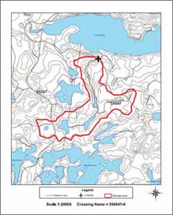

After processing the data about a proposed crossing, a page layout in ArcMap is created and exported as a PDF. Shapefiles of drainage basins and crossing location results can also be produced for additional analysis.

During two years of use, the application has undergone a number of improvements. Calculations for each water crossing now take as little as 10 to 20 minutes to process. The old manual approach usually required about an hour to perform the same calculations. This represents a 75 percent increase in productivity. Another important benefit is the ability to perform calculations on multiple crossings using batch processing. The forester or forest technician clicks a button to start the process and then is free to perform other duties while the computer performs the calculations.
click to enlarge
The results of crossing calculations can be used to populate a Microsoft Excel spreadsheet that is used to predict crossing type and size.
