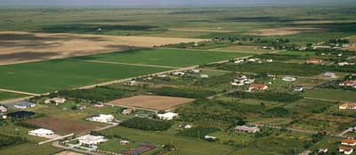

Aerial View of the 8.5 Square Mile Area that is frequently subject to flooding.
This small community is located west of a protective levee system designed to contain the Everglades and prevent floodwaters in the Everglades from flowing eastward into the urban areas of Miami–Dade County. Due to its proximity to the Everglades, low topography, and lack of drainage, the 8.5 SMA frequently floods for several months during each rainy season. Restoration of the Everglades National Park would exacerbate the flooding conditions without some remedy. In 1989, Congress directed the USACE to develop a flood protection system compatible with the hydrologic restoration needs of the park. For more than 10 years, federal, state, and local agencies have tried to develop an acceptable plan. In July 1999, the SFWMD requested that the USACE formally develop and evaluate a full array of alternatives that would provide flood mitigation for the 8.5 SMA.
