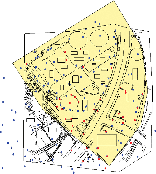

A case study illustrates the applicability of ArcGIS, with the ArcGIS Spatial Analyst extension, to determine the spatial distribution of potential hydrocarbon migration of NAPL at a former petroleum refinery and processing facility where known releases had produced five distinct oil plumes. Site characterization activities at the facility involved the installation of more than 50 soil borings and 35 groundwater wells as shown in Figure 2. Data from these locations indicated that several NAPLs were present at the site, and the plumes varied in composition from fuel oil to diesel fuel. Measured oil thicknesses ranged from less than 0.25 feet to more than 8 feet. In addition, the soils across the site varied from clay to medium sand. To further complicate the situation, the water table at the site varied daily due to tidal fluctuations in an adjacent inlet.

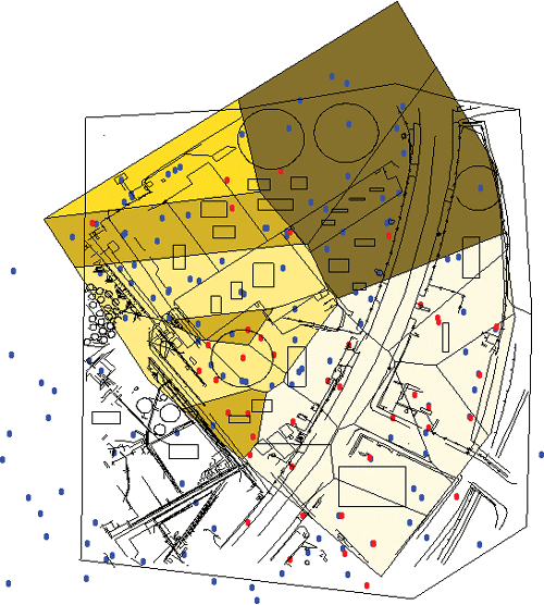

To define the spatially varying complex site conditions, thematic data layers were developed in ArcGIS to define the soil properties as shown in Figure 3 and viscosity distributions as shown in Figure 4. Data layers for product density distributions, free oil saturation distributions, temporally variable water tables, derived gradients from water tables, basemaps, and well locations with relevant attribute data were also developed.
