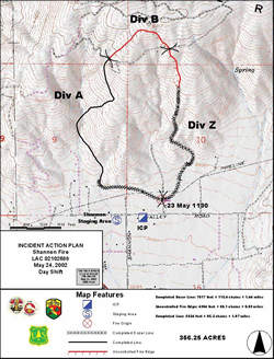

click to see enlargement

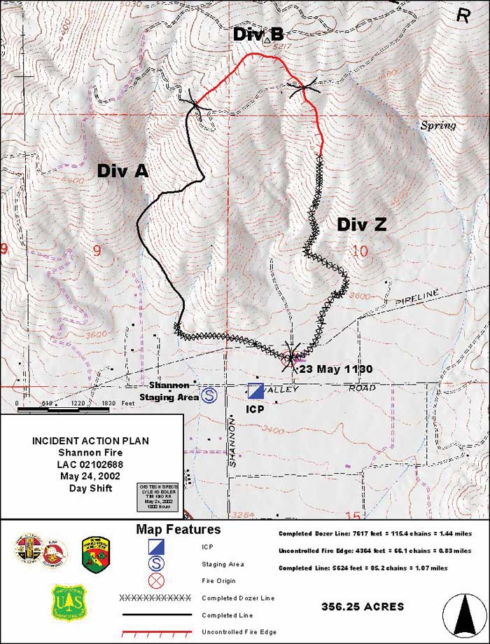

GIS can provide the IC with additional situational awareness by collecting and displaying timely and relevant information about topography, fuels, political boundaries, resource locations, fire perimeter, and assets at risk.
