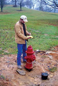

To minimize costs, it was agreed that HCWD 1 personnel would complete some tasks such as GPS data collection. To facilitate this work, SDI created a map grid of the district service area that helped organize the GPS collection process. HCWD 1 personnel collected actual field locations and attributes for each feature in the service area. The raw data was forwarded to SDI for postprocessing and integration with the master shapefiles. The processed data was imported into WaterWorks/FM.

| HCWD 1 personnel collected actual field locations and attributes for each feature in the service area. |
