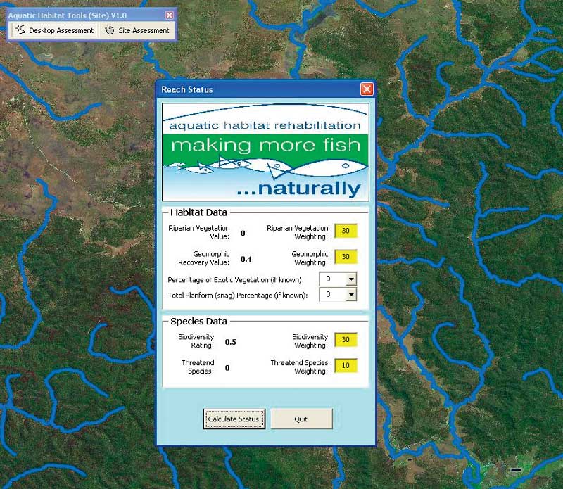

Figure 3: A screen shot of the catchment-level decision support tool. When the user clicks Calculate Status, suggested rehabilitation activities appear based on an area's potential for recovery.
ArcGIS was chosen for developing the decision support tool because of its ease of customization. The tool should be flexible enough to work at both the catchment- and site-level spatial scales. The prototype version was developed as an extension for ArcGIS Desktop 9 using ArcObjects with Visual Basic for Applications. This approach allowed for quickly coding and testing ideas, methods, and models. When the decision support tools in the extension had been sufficiently refined, the code was converted to VB.NET for secure distribution to the CMAs. A more detailed description of the tools in the extension follow.

Natural resource managers can use the Catchment-Level Decision Support Tool or Rivers Tool to identify catchments of varying conservation value across an entire CMA region and gain a broad understanding of the likely condition of these catchments. The Rivers Tool facilitates broad-scale planning and can be used to focus on particular areas of interest. It works exclusively with Esri shapefiles and allows the user to vary weightings for key environmental indicators. These indicators include aquatic biodiversity, riparian vegetation, river geomorphology, and species threatened with extinction. The tool uses a variety of aquatic habitat and biodiversity data that can be weighted toward various attributes as determined by the user to assign a conservation value to each area. The relative conservation value attributed to a region can then be used to determine whether further assessment using the site-level decision support tool may be necessary.

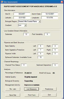

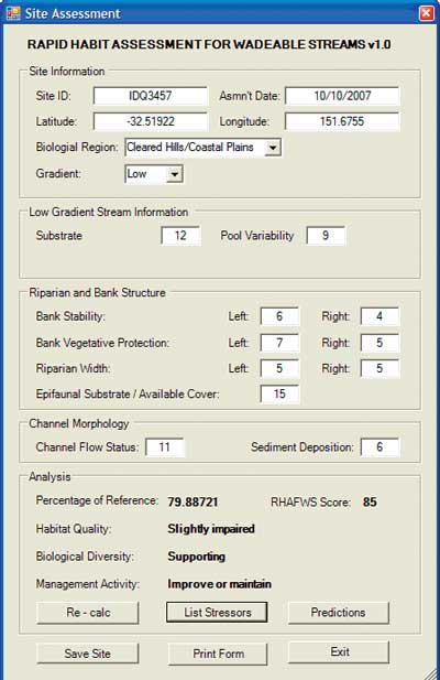

Figure 4: The site evaluation tool uses the Rapid Habitat Assessment method.
The tool for evaluating aquatic biodiversity at the site level was designed to provide a framework for making management decisions and reporting on the potential biodiversity benefits at the site level. It uses the Rapid Habitat Assessment protocol for conducting site assessments. This protocol was developed by the United States Environmental Protection Agency to evaluate the habitat integrity of rivers and streams at the site level. This protocol was adopted for evaluating aquatic biodiversity at the site level because it uses river habitat as a surrogate for aquatic biodiversity, requires few resources from managers with respect to expertise and equipment, and is time efficient.
Prior to conducting a rapid habitat assessment, the rivers and streams in a CMA region are separated based on the biological region and stream gradient they fall within. This is done because regional and stream-size variability affects the flow, substrate, and channel morphology of rivers. This categorization also ensures that the measured parameters are appropriate for the region under consideration. The biological region and gradient for each river provides a context for establishing river condition for a region. This approach enables CMAs to set targets for maintaining healthy aquatic ecosystems or, in the case of degraded systems, use the Rapid Habitat Assessment Approach for setting goals to bring about significant improvements in the condition of a water body.
Rapid habitat assessment emphasizes the potential faunal diversity present by measuring various habitat parameters that influence aquatic biodiversity such as riparian complexity and width, epifaunal substrate (in areas that likely include fish habitat), in-stream condition; and stream substrate complexity. Parameters are measured and the condition is identified based on the relative location of the river in the CMA region. Ten habitat parameters are evaluated visually at each site and given a Rapid Habitat Assessment for Wadeable Streams (RHAFWS) score, a numerical rating between 0 and 20. Scores for the 10 parameters are then summed, resulting in a total score that ranges from 0 to 200. These scores are compared to a reference score that reflects a habitat without degradation to provide a final habitat ranking. Higher scores reflect better quality habitats.

Using the Rapid Habitat Assessment protocol, natural resource managers can evaluate the potential faunal biodiversity associated with aquatic ecosystems at a particular site and gauge on-site threats that may be limiting aquatic biodiversity. To use this approach, natural resource managers can use personal digital assistants (PDAs) loaded with custom ArcPad 7 forms to record data for specific parameters of the Rapid Habitat Assessment protocol. Data collected in the field can be transferred to a desktop machine running ArcGIS with the Rivers extension tool so scores on habitat condition at the site level can be loaded. These site level river condition scores can be used by natural resource managers to identify potential stressors to river condition with respect to overall catchment condition.
