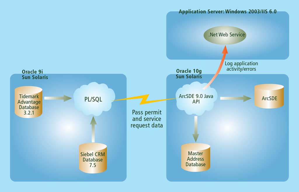

SAGA, like TAGG, is a server-based application developed as a Java-stored procedure. It is executed via a set of triggers within a Siebel database. Like TAGG, it is stored within an Oracle database schema on IndyGov's enterprise ArcSDE Server. When a service request is created, SAGA triggers a link to the ArcSDE Server and executes the Java procedure that creates geographic data based on the service request information gathered from the Siebel database. For service requests updated within Siebel, an update trigger is executed that queries the matching GIS feature within a Request for Service layer and updates the necessary attributes.
SAGA, using ArcSDE's Java functionality, generates GIS features for viewing within the Siebel interface. The application automatically generates geographic data within ArcSDE upon successful creation of a service request by the MAC call center within the Siebel customer relationship management (CRM) database. The geographic features are based on data gathered from the newly created service request in Siebel.
Siebel Call Center users create new service requests within the Siebel CRM software. The record is saved in the database. The user moves to the next service request and repeats this process. Meanwhile, an automated process is happening behind the scenes. As a new service request is saved to the Siebel database, a database trigger is executed that creates a connection via a database link to Oracle on the ArcSDE server.
click to enlarge
TAGG/SAGA/GIS environment
Unlike the TAGG application, a trigger is also executed as information is being updated on existing service requests in the Siebel database. As a database connection is created on the ArcSDE Server, related information is passed from Siebel to the Java procedure stored within Oracle. The Java procedure is executed and connects to ArcSDE.
If the process being executed corresponds to a new service request, the location of the service request cannot necessarily be related to a particular parcel. In this case, the address of the service request is geocoded and this location is returned as an x,y coordinate. The Java procedure then creates a new point feature that corresponds to the new service request and assigns the necessary attributes. If the process being executed is the result of an updated service request, a corresponding point feature already exists in the service request feature class in ArcSDE. The Java procedure queries for the matching point feature and updates the attribution that was updated on the record in the Siebel database.
Both the TAGG and SAGA applications consist of two main server environments and also access a third server environment. The Tidemark Advantage and Siebel CRM databases both reside in the Oracle 9i environment. As new information is added to each database, PL/SQL code is automatically executed to access the Java procedure stored within Oracle on the ArcSDE Server, which resides in the Oracle 10g environment. The Java procedure then uses the ArcSDE 9 Java API to interact with ArcSDE. If the new permit is a new building permit, then the Java procedure also inserts address information. Finally, if any errors occur in the Java procedure, then the error information is logged in a separate database using a Web service written in Visual Basic .NET.
