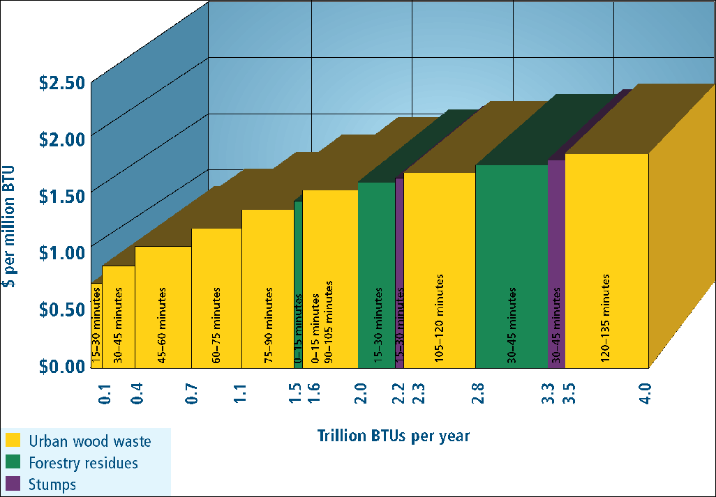

Prices, quantities, and resource haul category composition of the first four trillion BTUs, based on the average of all 27 counties
Assessing the economic availability of biomass requires information about production costs and the physical availability of biomass resources in the area of interest. The methods used are composed of the following three components: calculation of transportation costs and haul times, determination of physical availability and geographic distribution of biomass, and creation of biomass resource supply curves.

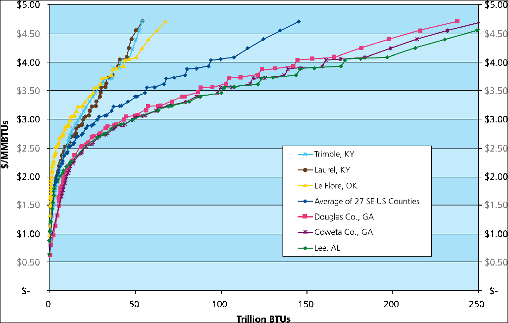

Example of low, high, and average woody biomass supply curves of selected counties. Biomass sources include urban wood waste, forestry residues, stumps, and pulpwood within a four-hour haul radius.
