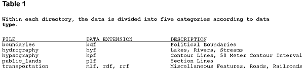

Each 30-by-60 minute quadrangle, 15-minute tile, and data type is coded into each file name using the following convention: [3 character quad code]. [3 letter data code][2 digit 15 minute code].opt.gz.
The "opt" suffix indicates optional format and "gz" indicates "government zip," a zip format. The files are automatically unzipped by some browsers, or can be manually unzipped using utility programs such as WinZip.
All five component files boundaries, hydrography, hypsography, public lands, and transportation, should be downloaded into a single directory for all of the 15-minute tiles that you need. By understanding and following the USGS file naming conventions, you can track the data. Data will automatically be kept separated until read into a common DXF file as explained later.
The processing software is a DOS program called DLGLX149.exe. Consequently, files MUST have eight character names, followed by the extension .dlg. Strip unnecessary characters out of the file name when unzipping the file. The unzipping utility will prompt the user for the name of the contained file. For example, the file EO1.BDF03.opt.gz should be unzipped and saved as EO1BDF03.dlg. Following this convention retains the meaningful file name AND is DOS compatible.

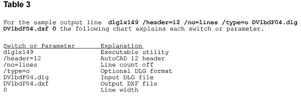

The following switches work well with AutoCAD 12, 13, and 14:
/3d /h=12 /no=lines /no=comments /type=o
You may want to experiment with switches that serve special purposes, such as the /G switch to convert UTM to geographic latitude/longitude coordinates in NAD 27. In automated mode, the program first prompts for the AutoCAD version. Version 12 is the recommended default. Enter Switches [H=12]: <RTN>. Additional switches may be added here.
Next you are prompted to enter the file names of the input files. Type the path and name of the DLG file you wish to process. If you use wild cards such as *.DLG or DV1*.DLG to process several DLG files into one drawing, make sure the resulting file will not be an unwieldy size.
The program then prompts for the output file name. Enter the first eight characters of the input file name and add the DXF extension. The USGS convention is recommended (e.g., DV104.dxf for multiple data types or DV1hpf04.dxf for single data type).
Finally, the program prompts for line width. A value of zero (0) is recommended. Enter line width [0]: <RTN>. Sit back and watch the program execute.
An alternative to using an interactive DLG to DXF conversion procedure is to use a DOS batch file to automate data conversion. The batch file calls the DLGLX149 program, applies necessary switches and parameters, and specifies input DLG and output DXF files. The batch file is first created in a text editor and should be stored in the same directory as the DLG files and the conversion utility. Each batch file line includes seven items. A separate line is created for each input/output desired. A single line from a typical file is shown in Figure 3.
The batch file automates extraction and permits the user to quickly repeat a conversion step if the first pass does not execute properly. If certain DLG files do not convert properly, simply delete the incorrect resulting DXF file, edit the batch file to fix any errors, and rerun the corrected batch file. Correct DXF files in the project directory will not be rewritten. The batch file can also be copied to a new project area, edited, and used as a template for additional conversions.
