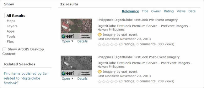

  3. In the search box on the top right, type "digitalglobe firstlook".
    You will see two services DigitalGlobe provides for humanitarian purposes, emergency response, and recovery operations. One service contains imagery taken before the typhoon battered the Philippines, and the other provides imagery of the same areas after the disaster. Below are the full names:
    • Philippines DigitalGlobe FirstLook Post-Event Imagery
    • Philippines DigitalGlobe FirstLook Pre-Event Imagery
    DigitalGlobe FirstLook pre- and postevent services are listed in ArcGIS Online.

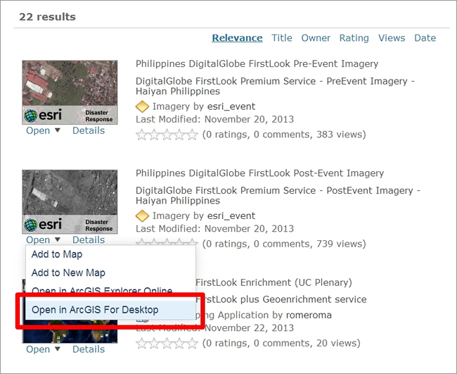

  4. Choose one of the services you're interested in, click the small arrow next to Open, and then click Open in ArcGIS 10.2 for Desktop.
    Services listed in ArcGIS Online can be added directly to ArcMap with just one click.
    This will download a Portal for ArcGIS item to your browser download folder called item.pitem.
  5. Double-click the file to open it in ArcMap. You may be prompted to sign in to your ArcGIS Online account from your ArcMap session if you're not already signed in.

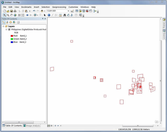

    "The service will be available in the table of contents (TOC), but you will see only the wireframes (red outlines of the imagery) because the imagery is loaded at the full extent. The imagery will be displayed only when zoomed in below 1:800,000.

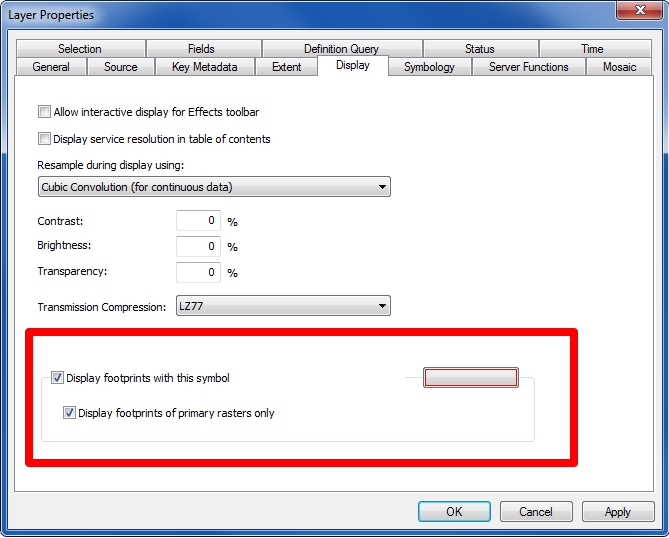

  1. Right-click the layer in the TOC and select Properties.
  2. In the properties dialog box, select the Display tab.
  3. Check the check boxes for Display footprints with this symbol and Display footprints of primary rasters only. Click OK. <>You can use image services to display the footprints and modify other display characteristics in ArcMap.
    The footprints for the service should now appear in your data frame. Each polygon in the map represents an individual image.

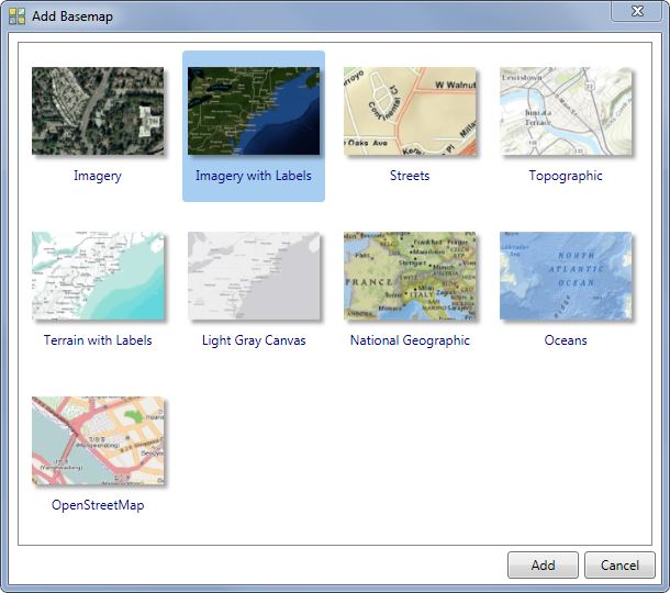

  4. On the Tools toobar, click the Add Data drop-down menu and click Add Basemap.
  5. Click Imagery with Labels to add a basemap for reference. <>Basemaps from ArcGIS Online, accessible from ArcMap, provide context to your exising geographic information system (GIS) data.

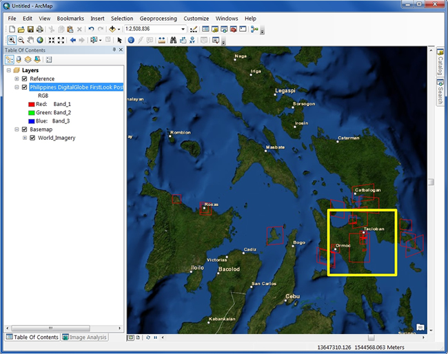

  1. Zoom in to Tacloban City where there's a high concentration of imagery. See the screen shot (below) to find the area of interest.
    Image Footprints Overlaid on Top of an Imagery Basemap

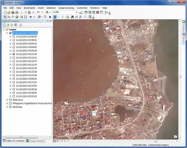

  2. After you zoom in, use the Select Features tool on the Tools toolbar and select all the scenes in the data frame.
  3. Right-click the layer in the table of contents and choose Selection > Add Selected Rasters to Map.
  4. In the dialog box that appears, give the group a name, such as FirstLook WV2 Tacloban.
  5. On the Layer name based on drop-down menu, select AcquisitionDate for the Layer Name and click OK.
You'll now have a separate group layer with all the individual scenes listed by date, starting with the earliest.
Tip: To collapse all the scenes in the group layer, hold the Ctrl button on your keyboard, then click the minus sign next to one of the images. This will shorten your group layer list for better organization.
Suggestion: Hold the Alt button on the keyboard, then click the check box next to the layer to turn images on one at a time. Go down the list of images to visualize the images with no overlap.
Optionally, right-click the new group and save it as a layer file to reuse.
Go back and change the query definition in the layer properties to visualize other sensors or combinations of sensors. Save your favorite query definitions as layer files to save time in the future.
WorldView-2 Imagery from DigitalGlobe over the Peninsula in Tacloban City, the Philippines
