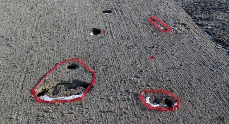

In Wyoming, the Abandoned Mine Land (AML) program oversees the reclamation of lands with unused mines on them and works to restore those areas to safety. For abandoned mines that are at risk of collapsing, AML can conduct grouting operations. This is when holes are drilled into old mines and filled with a cement-like mixture to reduce the likelihood that the roofs of the mines will cave in. But these operations can cause ground movement in the areas where they’re being done. What’s more, subsidence—or the gradual sinking of land—can happen when mine roofs fail, leading to sinkholes that form near infrastructure and towns.
Small sink holes in a raked area of dirt
When the roofs of abandoned mines fail, it can lead to the formation of sinkholes.

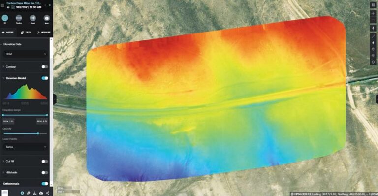

Some of the products derived from the aerial imagery of mines in Carbon and Converse Counties include orthomosaics, digital terrain models, digital surface models, contours, volumetric calculations, cut-and-fill operations, hillshades, and 3D mesh scenes. All of these—which employ ground control points to ensure accuracy—help leaders at AML plan projects and make decisions.
Imagery of mine land with a red, orange, yellow, green, and blue elevation model on top of it and information about the area on the side of the screen
Digital surface models derived from the aerial imagery stored and processed in Site Scan for ArcGIS help leaders at the Abandoned Mine Land (AML) program plan projects.

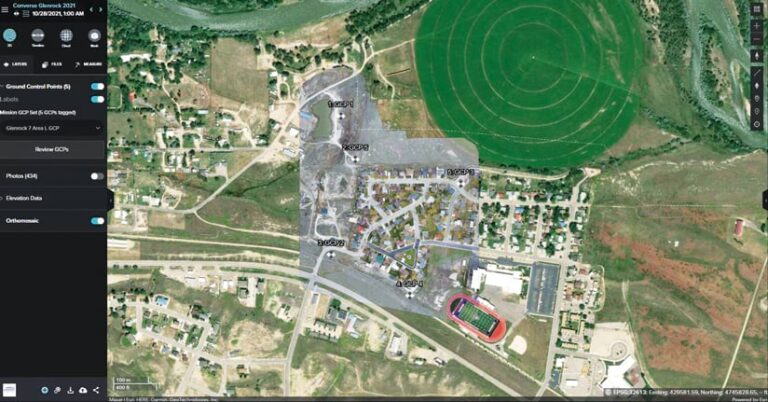

Aerial imagery of a town with ground control points on it and information about those points on the left side of the screen
Orthomosaics employ ground control points—known points used for georeferencing—to ensure accuracy.
Thanks to Site Scan, the team at Brierley can now create products for various clients that demand high-resolution imagery and give them access those products anywhere, anytime.
