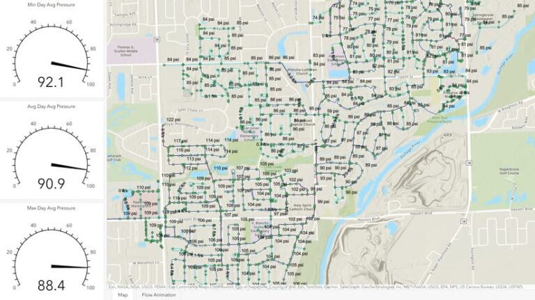

A map of a mostly developed area shows thin dark lines and small circles against a light-colored background showing roads, open areas, water, and other features. On the left are three labeled pressure gauges, each showing a number ranging from 88.4 to 92.1.
Created by Esri partner Aquanuity to run as an ArcGIS Pro add-in, AquaTwin Water Pro shows the Metropolitan Utilities District’s system hydraulics across spatial areas.

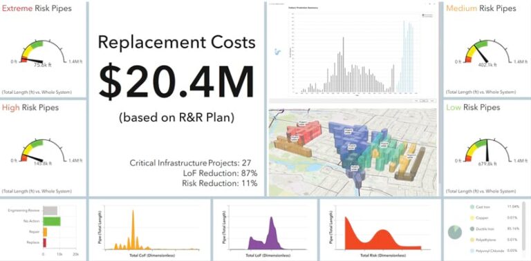

A dashboard shows 11 boxed charts with titles such as Extreme Risk Pipes. An adjacent text box reads, Replacement Costs $20.4M.
An AquaTwin dashboard displays Metropolitan Utilities District pipe replacement costs.

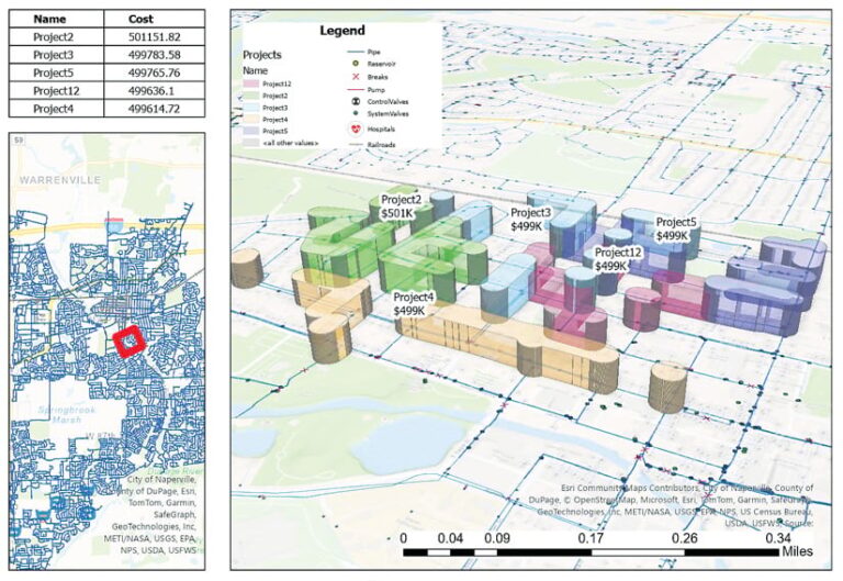

Using ModelBuilder, district staff can combine several GIS features to create a single, comprehensive table that they can use to easily update the risk models generated by AquaTwin. These models combine service taps (smaller pipes that run from water pipelines to houses), break rates, and break counts (the number of individual breaks in a pipe), and normalize the data based on water main age. Staff then add the results to the AquaTwin products’ models.
Two maps and a text table show a city with a red square, a zoomed-in area showing five color-coded project locations and costs, and a list of the projects and costs.
AquaTwin Water Pro shows prioritized Metropolitan Utilities District projects based on asset risk levels.
The consequence-of-failure factors make use of a powerful AquaTwin tool called Saved Selections, which allows AquaTwin users to select pipe features, such as line features representing water mains. Users then save those selections and assign risk scores. AquaTwin Asset Pro quickly combines likelihood-of-failure and consequence-of-failure data into risk-priority scores, which staff can then display in dashboards.
This linear asset risk model helps the district prioritize water main renewal and condition assessment projects. It also assists in monitoring areas of highest consequence for active water leaks. Since it’s not always economically feasible to replace just one high-risk block of water mains, engineers can choose to also replace surrounding medium-risk mains to create a more efficient and economical project.
