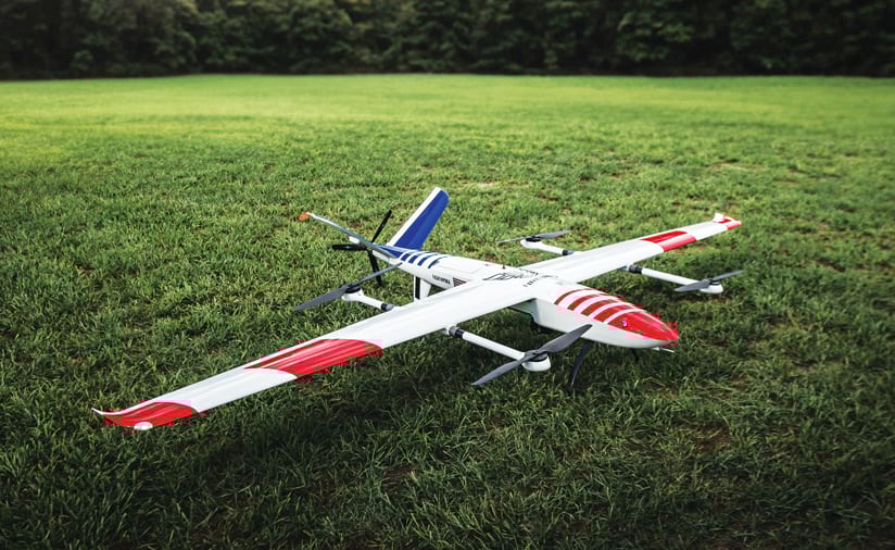

These are issues that Esri startup partner Fire Neural Network is addressing with help from ArcGIS Online and ArcGIS Dashboards. The company’s High-Risk-Lightning detectors provide location data on strikes that is then combined in ArcGIS Online with other wildfire-related variables. When viewed in dashboards, this data helps firefighting services allocate resources, such as deploying one of Fire Neural Network’s high-speed drones to take a closer look at the strike site.

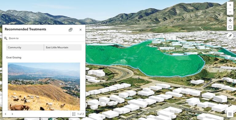

A 3D map of a populated area with a hill highlighted in green and an image of the hill with goats on it in the bottom-left corner of the map that’s labeled Recommended Treatments
Fire Neural Network created an ArcGIS technology-enabled community wildfire protection plan with built-in high-risk lightning detection functionality for San Bernardino County, California.
When possible, Fire Neural Network also employs ArcGIS Hub to help communities incorporate lightning strike information into digital, GIS-enabled wildfire protection plans.

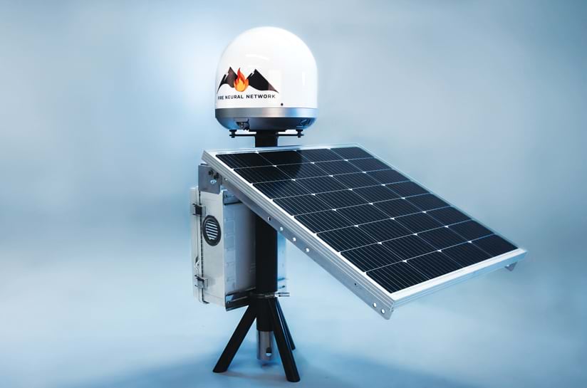

Fire Neural Network’s solar-powered lightning detectors pinpoint lightning strike locations and detect the presence of long-continuing-current lightning. The detectors are usually installed as an array of six ground-based units that collectively cover about 1,544 square miles (4,000 square kilometers). Connected to the company’s proprietary network, the detectors can identify lightning strike locations within 131 feet (40 meters) of the strike in 40 seconds or less. These are the only sensors on the market that can accurately detect the duration of a lightning strike and its associated heat characteristics.
To evaluate wildfire risk, Fire Neural Network uses ArcGIS Online to pair strike location vector data with more than 30 weather-related raster data layers—for flammability, humidity, vegetation, and rain data, for example—in real time. This data is then converted to a dashboard built with ArcGIS Dashboards and made available to subscribers in wildfire-prone areas such as California, Florida, Australia, and Brazil. From lightning strike to dashboard availability, this data is generally displayed in about 40 seconds.

CWPPs are typically lengthy, highly technical documents that are distributed as PDFs—and they often fall short when it comes to improving community engagement. Considering this, San Bernardino County Fire Protection District fire chief Dan Munsey and deputy fire marshal Adam Panos wanted to transform their static CWPP into a dynamic and interactive online platform that integrates spatial analysis and can be updated in real time. Their goal was to give stakeholders access to up-to-date wildfire risk maps, recent mitigation projects, and resource allocation recommendations.
Fire Neural Network helps communities with this transformation by taking CWPP PDFs and converting them into GIS-enabled solutions. By using these solutions, community members can investigate current mitigation projects on hub sites created using ArcGIS Hub and use ArcGIS Survey123 to fill out mitigation recommendations or feedback forms for local fire departments.
San Bernardino’s new CWPP solution, which went live earlier this year, has been a success, according to Panos. “GIS-enabled CWPPs not only improve emergency planning capabilities but also ensure that vulnerable communities receive the support they need before and during wildfire events while enhancing community resilience,” he said.

ArcGIS technology-enabled lightning detection also supports Fire Neural Network’s work with GatorX, a Florida-based partnership between the company and the University of Florida, NVIDIA, Satlantis, SwissDrones, Archer Aviation, SWIR Vision Systems, and N5 Sensors. GatorX has developed a solution that reduces risk for wildfire first responders. By using AI with satellite imaging, lightning and smoke sensors, and drones, the GatorX solution can quickly detect and verify hot spot locations before deploying a drone-tethered autonomous fire extinguisher that can put out emergent wildfires before they spread.
