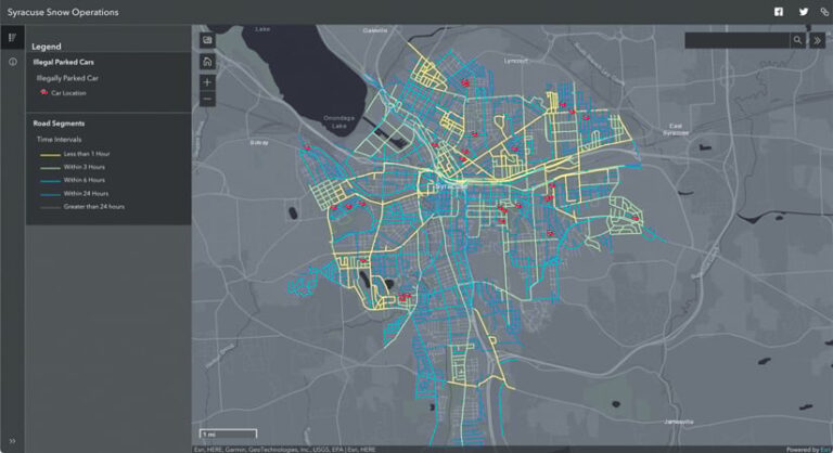

A map of Syracuse streets colored blue, teal, green, yellow, and red and a legend indicating what each of the colors means (i.e., how long ago each road was plowed)
During snowstorms, a new public-facing map lets Syracuse residents see which roads have been plowed recently.

The data also feeds into a public-facing web app that was built with the Minimalist template in ArcGIS Instant Apps, available through the Winter Weather Outreach solution. This simple map, posted on the city’s website, shows a live view of when all the streets in Syracuse were last plowed. Yellow indicates streets that have been plowed within the last hour; green and teal show streets that have been cleared within the last 3 or 6 hours, respectively; blue indicates streets that have been plowed within 24 hours; and gray shows streets that haven’t been plowed in over a day.

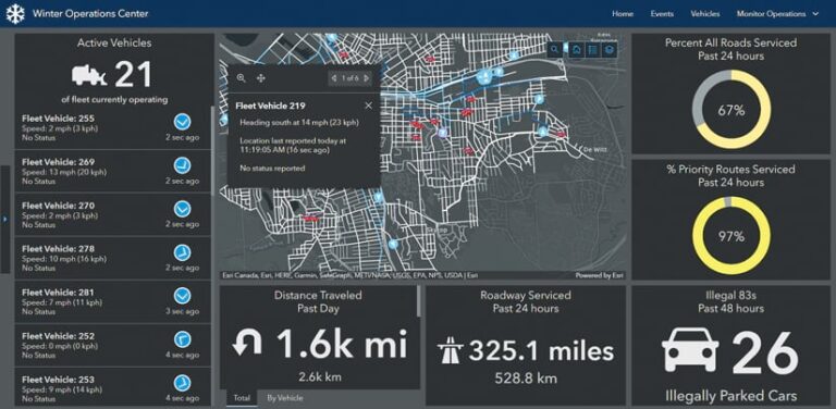

A dashboard showing snowplow fleet operations during a snowstorm, including a map of where the snowplows are located, real-time information about each plow, the percentage of roads services in the last 24 hours, and more
The Department of Public Works (DPW) uses dashboards to monitor and make decisions about snowplow operations.
“We figured out pretty quickly that this provided much more functionality than what we currently had in terms of fleet management and performance monitoring. It was also much more robust and accurate,” said Muldoon. “Now, we’re looking to continue to iterate off this tool and have it fit the unique needs of our community.”
