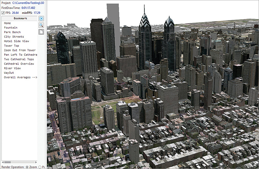

ArcGIS Pro delivers a great interactive experience when working with 2D and 3D data. When users pan and zoom, the smooth animation feels remarkably gamelike. These visualization capabilities are also a way users can measure how well the program works in DaaS.

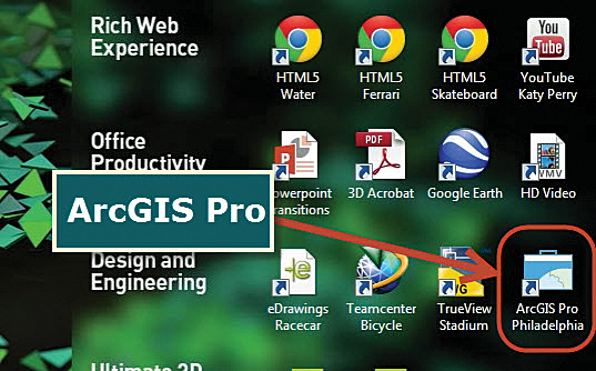

ArcGIS Pro has been preinstalled in several leading DaaS deployments, including NVIDIA Test Drive. Allocated from multiple data centers around the world, NVIDIA Test Drive furnishes an entire Windows desktop with multiple graphics-intensive applications already installed to demonstrate how graphics-intensive applications can be successfully delivered and provide an impressive user experience.
ArcGIS Pro is one of the installed graphics-intensive applications. Its rendering engine, which uses DirectX or OpenGL libraries to render, drives the program’s fluid, highly animated visualization. Those are the same libraries used for gaming software, and when used with GPUs, their capabilities are maximized.
The ArcGIS Pro user experience in the NVIDIA Test Drive DaaS is enhanced because the virtual desktop provided by the DaaS is supported by a shareable GPU. The NVIDIA Test Drive environment uses NVIDIA GRID cards that are specifically designed for virtualization environments.
