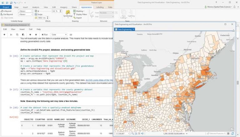

Python open-source integration has long been a feature of ArcGIS Pro, but with built-in Python notebooks, you can more readily explore all that open-source integration has to offer. Create pandas dataframes, data visualizations with libraries like Matplotlib, or read in large datasets using Dask. The interactive notebook interface gives you instant feedback on code execution without requiring debugging of the entire script, making it ideal for iterative analysis and data discovery.
Switch seamlessly between ArcGIS Notebooks and the ArcGIS Pro UI. You can use ArcPy to call layers from an ArcGIS Pro project from within its notebook. Results from the notebook can be added to the ArcGIS Pro map view. In addition to moving data and results back and forth, the notebook pane can be docked within the ArcGIS Pro interface, so it can be displayed at full screen or viewed alongside maps, charts, and data. This centralizes the analytics pipeline in one place.

In ArcGIS Pro 2.5, you can create or add a notebook to your project simply by choosing Insert > New Notebook to create a new notebook or add an existing .ipynb file to an ArcGIS Pro project. Open an ArcGIS Notebook file using the Catalog pane.
