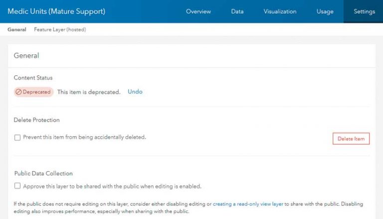

Go to the Settings tab in the item description and click Mark as Deprecated to discourage the use of this item. When an item is marked as deprecated, it also can’t be found in ArcGIS Online searches.
