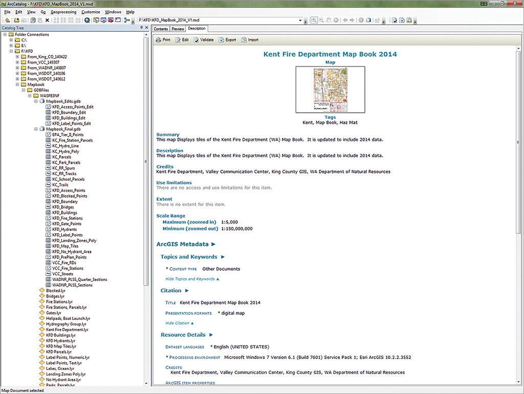

Coordinate Systems and Metadata
When I receive data, I immediately open it and review it in ArcCatalog. I look for metadata created by the provider. If adequate metadata is not available, I use ArcCatalog to create new metadata or to validate and edit a minimal set. If metadata is available separately from the provider, I download the file and import it or manually merge it into the source data. Sometimes, I return to a provider’s site several times to ensure I have all available supporting information.

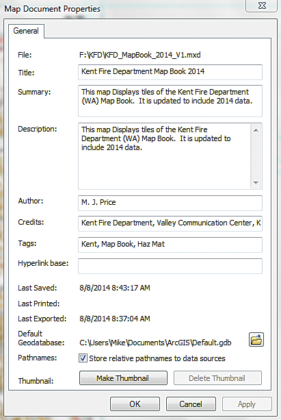

In a new or existing map document, it is very important to set several Map Document Properties as soon as possible. To set document properties in ArcMap, go to File in the Standard menu and choose Map Document Properties. In the dialog box, fill in the Title field and as many fields as possible.
Use Customize > ArcMap Options > Data View to change the number of numeric characters to the right of the decimal point that are displayed for coordinates in the status bar.
ArcMap uses the Title field to assign a default title to the map layout. You can change the title later if you wish. The other fields populate the map document’s metadata. Take your time completing this task. If you plan to use hyperlinks in the map and all photos or other objects to be linked will reside in a single folder, you can set the hyperlink base using the Map Document Properties.

Still in the Map Document Properties, look at the Default Geodatabase specified. If you set a default geodatabase when you opened the Normal.mxt template, you might not need to do anything. If you didn’t set it or realize you need to change the default geodatabase, do it now.
Next, locate the Pathnames box in the dialog. If your data is organized so that all data for the layers in your map resides in folders that are organized in a hierarchy, you can check the box to apply relative paths to search for the data in the map using that structure. If you store the ArcMap document at the base of the folder structure, ArcMap will search out folders located in this structure to find the data used in the map.
By default, ArcMap does not retain the relative path setting for all documents. If you prefer relative paths as your default, click Customize in the text menu, select ArcMap Options, click the General tab, and check the option Make relative paths the default for new map documents.
Save your project after verifying or manually setting the coordinate system and setting the Map Document Properties.

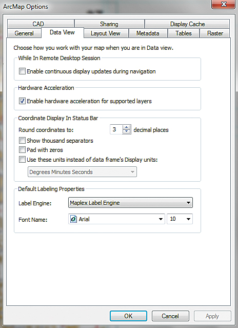

Before considering geoprocessing options, make certain that Maplex, Esri’s powerful labeling engine, is available. With ArcGIS 10.1 for Desktop, it became part of the core software and is available to all ArcGIS for Desktop users.
By default, new ArcMap documents use the Standard Label Engine, so change this returning to the Standard ArcMap menu. Choose Customize > ArcMap Options and open the Data View tab. Near the bottom of the dialog, set the Label Engine to Maplex Label Engine.
Make sure you set Maplex as the labeling engine.
Now is also a good time to consider a different font name and size for labeling. I recommend using a simple, sans serif font such as Arial for default labeling. Consider increasing the default size to 10 points.
Remember, updating these properties for the current map will not change the label engine and font for existing map documents. Set Maplex as the labeling engine for existing maps by right-clicking on the data frame, opening Properties, selecting the General tab, and changing the Label Engine to Maplex.
While in Customize > ArcMap Options > Data View, you can also change how the coordinates display in the status bar by modifying the number of numeric characters to the right of a decimal point. If you display decimal degree units derived from GPS, you might want to limit the number of places shown.
If you want to obtain one-meter precision with decimal degree coordinates in the middle latitudes, specify five characters to the right of the decimal point. With label engine and coordinate display set, save the map document.

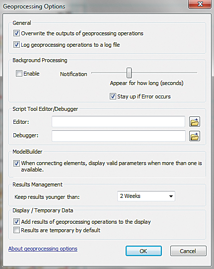

Setting Geoprocessing Options
ArcToolbox provides powerful and highly efficient geoprocessing tools, but to use them properly, you must set certain geoprocessing options and environment variables.
In the ArcMap Standard menu, choose Geoprocessing > Geoprocessing Options. Check the box so geoprocessing results will be written to a log file. It may be desirable to overwrite the output files from intermediate geoprocessing operations. By default, ArcMap will not overwrite existing geoprocessing output, so eliminate lots of intermediate files by checking the Overwrite box.
In Map Document Properties, fill in as many fields as you can.
If you want to run geoprocessing tasks in the background, check the Background Processing Enable box. You can also turn geoprocessing notification on and off and change the length of time a message displays on your screen. Alwaysdisplay all error messages so you can figure out how to fix errors.
Experiment with these options and decide what works best for you. Keep final geoprocessing results for at least two weeks. For most processes, add the results to the map.
If you elect geoprocessing in the background and you are unsure of the status of a process, you can choose Geoprocessing > Results in the Standard menu to check it. Look at the top item in the Current Session. A small hourglass indicates that the process is running.
