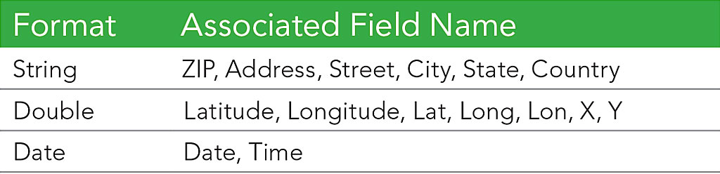

ArcGIS Online evaluates the first few rows of data in a CSV file to determine which field type to use for the resultant hosted feature layer. The field type can also be established if the field name matches the common field names associated with specific field formats shown in Table 1.
Table 1: Common field names associated with specific formats
Other field names may be recognized when geocoding in locales other than the United States. For example, “prefecture” will match if the selected country is Japan.

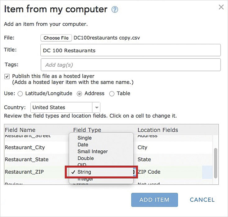

ArcGIS Online does a good job choosing field types for CSVs, but there are some cases where you may need to override the suggestions. For instance, a ZIP field in your CSV might be named “Office ZIP+4 Code” or something else that ArcGIS Online doesn’t recognize. Another case is when a field that contains dates is set as string. In that case, the Enable Time option is not available for the layer.

To pick field types for a CSV dataset, publish the file using the Add Item button on the My Content page. Then review the field types in the list and click any types that you want to change to select a different type.

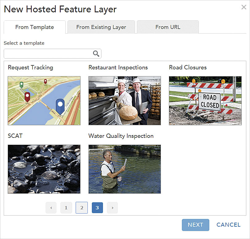

If you are creating a layer for collecting information, the data collection templates available from ArcGIS Online provide an empty feature layer with a focused set of fields and field types that can simplify the layer configuration in some cases. To use these templates, log in to your ArcGIS Online account and go to My Content > Create > Feature Layer and choose an appropriate template from the From Template tab.

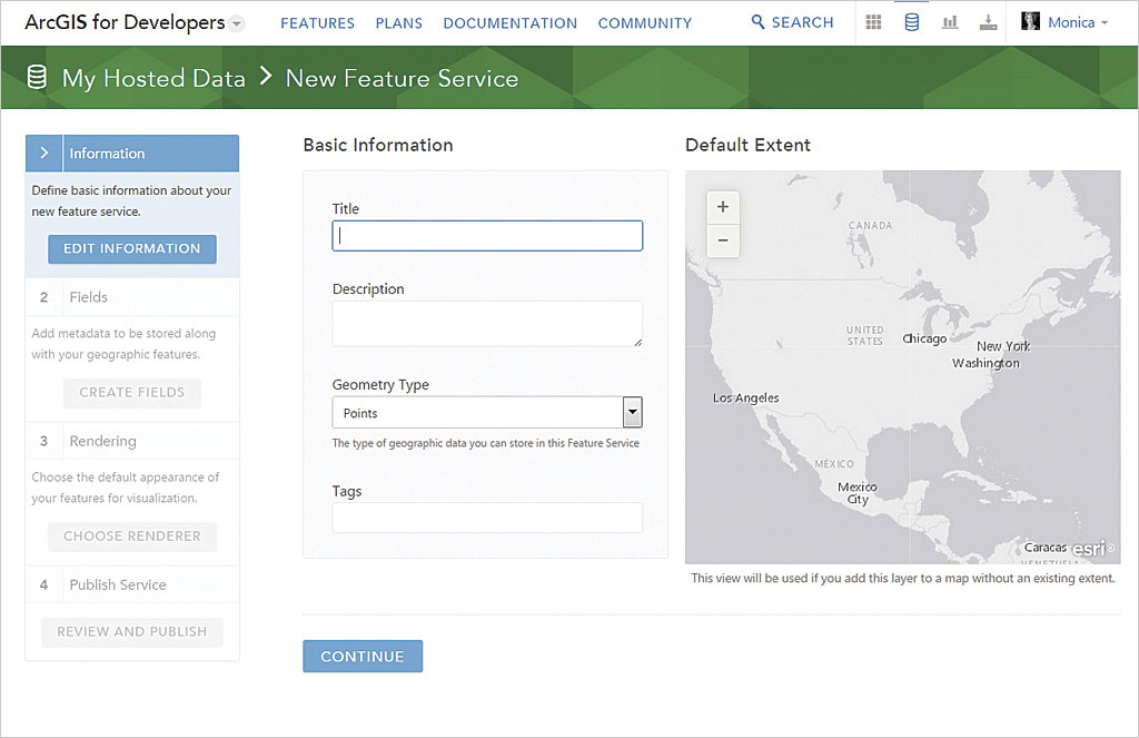

Create feature layers from scratch at the ArcGIS for Developers (developers.arcgis.com) website. You don’t need a Developer account to use this site. Log in with your organizational account, click Hosted Data (the cylinder icon at the top right of the page), then click NEW FEATURE SERVICE and enter the information to define your new feature service.
