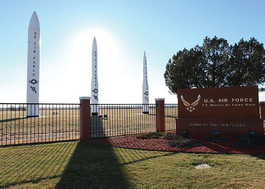

Warren AFB is part of the ICBM program. It is the installation of the 90th Missile wing, controlling one of the three missile fields. The static display of Peacekeeper, Minuteman-III, and Minuteman-I missiles is located at the front gate. Photo courtesy of 90th Missile Wing Public Affairs Office
