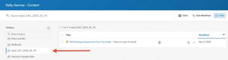

Once a transfer is completed, the content will no longer be visible in the My Content section of the person transferring items. The person receiving the content will have a new folder with the name of the person who transferred items and the transfer date on their My Content page.
When the transfer is complete, the person receiving the content will have a new folder on their My Content page. The new folder will contain the transferred items, and the folder name will have the name of the person who transferred the content and the date it was transferred. The person receiving the content is the new owner of the items and can freely modify them.
