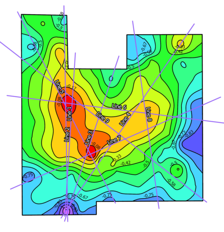

From 2018 through late 2019, Argis worked to create an ArcGIS Pro extension containing a customizable tool that takes accurate measurements of a home’s elevation and creates a small-scale elevation model of the foundation.
With the home survey measurements, 2-10 engineers use the tool to draw lines across the elevation model. These lines help engineers determine the most significant foundation deflections and tilts. The engineers then generate a custom report with easy-to-read graphs, tilt and deflection ratios, and offset calculations for deflection using the computations and imaging that the program creates.
A 3D map
An ArcGIS Pro extension creates topographic contour maps that show relative floor surface elevation data for residential structures.

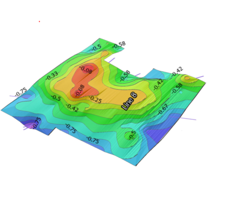

In 2023, 2-10 decided to take the program a step further and add 3D modeling capabilities to make tilt and deflection reports even more user-friendly for claims adjusters and claimants.
Argis used ArcGIS Pro SDK for .NET to build an add-in tool for ArcGIS Pro that creates a 3D model. The tool generates an elevation image built from a CSV file containing x,y coordinates and the coordinates’ elevations. Then, the user overlays the elevation image with a PNG file of the home’s foundation blueprint. The tool generates a three-dimensional side view that shows exaggerated terrain relief in different colors. Red indicates the highest elevation and purple indicates the lowest. The color-coded 3D view gives nonexperts a visual reference, helping them quickly understand the severity of a home’s tilt and deflection.
A 3D map
In addition to topographic contour maps, the ArcGIS Pro extension creates 3D relief maps that show relative floor surface elevation data for residential structures.
“The 3D view shows the shape of a home’s floor system. It adds another dimension to support understanding versus a flat two-dimensional model,” Vialpando said. “Claims adjusters aren’t engineers. They need to be able to interpret and explain this very nonstandard engineering task to claimants for claim resolution. We had to be able to translate a very high-level analysis into something that could be used and understood by nonexperts.”
