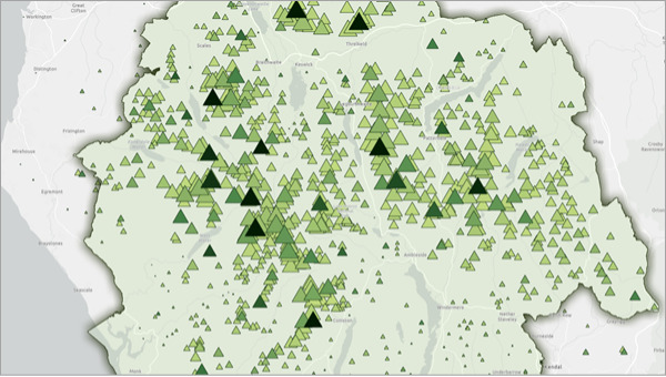

The following Lake District National Park 2 web map uses the Light Gray Canvas basemap and depicts the mountains of the Lake District National Park in England. Its simple design and neutral colors allow it to support thematic data without distracting from it. However, while it provides information about towns and roads, it does not depict terrain—the primary focus of this map.

Please note: The point symbols on the parks layer are scale dependent, meaning they only appear on the map at certain scales. If trees don’t appear, zoom in using the plus sign in the lower right corner.
A light green map of a park in England with scattered green and black triangles

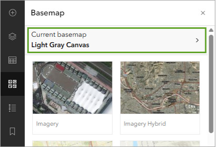

4. On the Contents (dark) toolbar, click the Basemap button to open the Basemap pane.
5. At the top of the pane, choose Current basemap: Light Gray Canvas.
Many basemaps are made of multiple layers. In this pane, you will see the layers that make up the basemap and remove, reorder, or modify them.

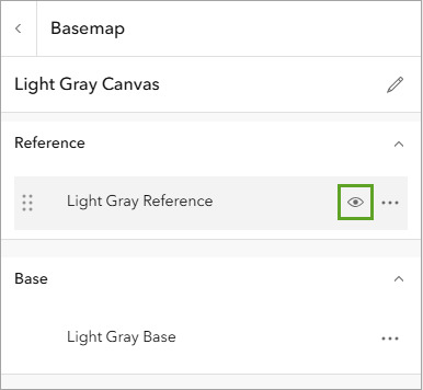

6. Move the mouse to Light Gray Reference and click the visibility button to turn this layer off. The labels will disappear from the map.
A basemap toolbar with the options reference and base displayed
7. Turn the Light Gray Reference layer back on.
This layer is in the Reference category, which means it draws on top of all the other layers in the map. The Light Gray Base layer is in the Base category, which means it draws beneath the other layers.

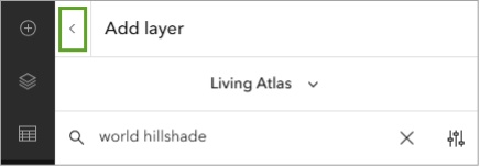

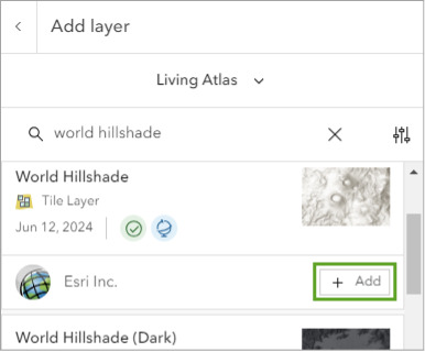

9. Click My content and choose Living Atlas. Type “world hillshade” in the search bar.
10. In the search results, on the World Hillshade card, click Add.
An add layer toolbar with the world hillshade option selected
The hillshade appears on the map.

11. At the top of the Add layer pane, click the Back (arrow) button.
An add layer toolbar with the words world hillshade in the search bar

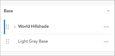

In the Basemap pane, the World Hillshade layer has been added to the Base category. It is placed above the Light Gray Base layer.
On the map, the hillshade layer hides the Light Gray Base layer, so you can no longer see roads or lakes. You’ll change the blending property of the hillshade to allow the rest of the basemap to show through.
The words world hillshade in bold black text and selected in blue
12. In the Basemap pane, ensure that World Hillshade is the selected layer. The selected layer will have a blue bar on the left side.

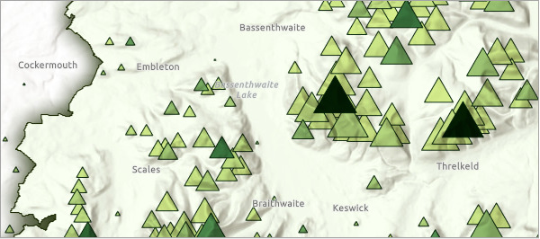

14. Under Appearance, change Blending from Normal to Mulitply. You can type “multiply” in the Filter results bar to find it. Close the Blending menu by clicking the X in the upper right corner.
The word multiply in black text surrounded by a green box

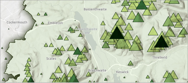

Blend modes determine how a layer interacts visually with the layers underneath it. The Multiply blend mode acts similarly to layer transparency, but it allows both the affected layer and the layer underneath to remain equally visible.
On the map, the roads and lakes are now visible as well as the hillshade.
A light green map with scattered black and green triangles
