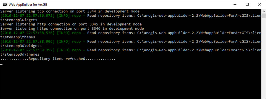

Double-click startup.bat to start Web AppBuilder for ArcGIS Developer Edition.
This opens a Command Prompt window called Web AppBuilder for ArcGIS.
It also opens your web browser, where Web AppBuilder for ArcGIS Developer Edition appears.
Minimize the Command Prompt window.

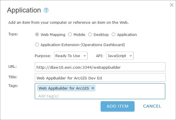

Go to the My Content page > Add Item > An application.
The Application dialog box appears.
Enter the following parameters:
Click ADD ITEM.

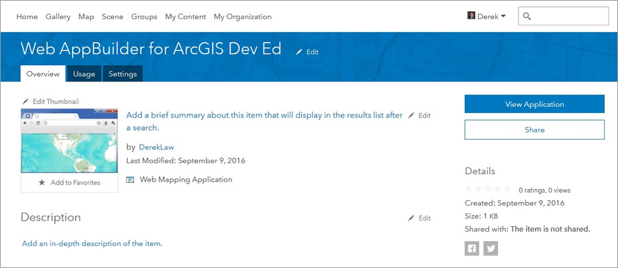

A new item for Web AppBuilder for ArcGIS Developer Edition appears in your ArcGIS Online organization.
On the Web AppBuilder for ArcGIS Dev Ed Item Details page, click the Settings tab, scroll down, and click Register.

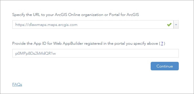

Return to the web browser window with Web AppBuilder for ArcGIS Developer Edition and the setup panel.
For the URL, enter the URL of your ArcGIS Online organization.
The URL is validated by Web AppBuilder for ArcGIS Developer Edition, and a green check mark appears. Then the app ID input parameter appears.
For the app ID, paste the app ID value you copied from the Item Details page.
Click Continue.

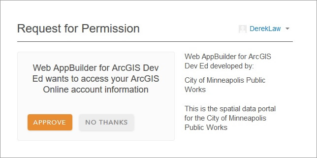

The Request for Permission dialog box appears; this is to verify that you approve that Web AppBuilder for ArcGIS Developer Edition can access the ArcGIS Online organization.
Click APPROVE.

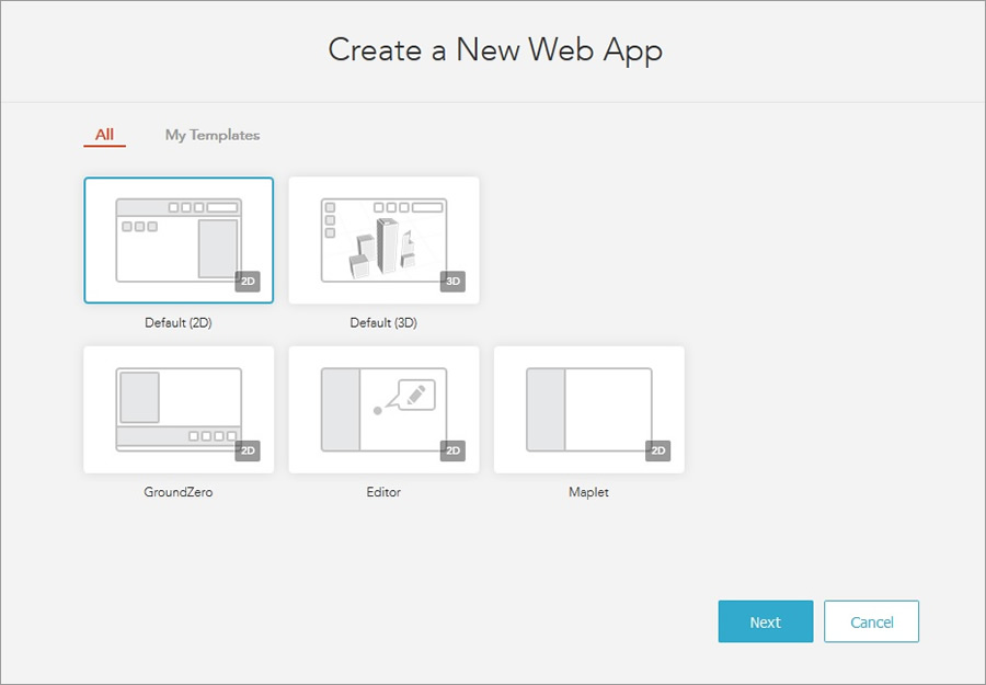

The Web AppBuilder for ArcGIS Developer Edition user interface loads, and you can now start to create new mapping apps for the web!
