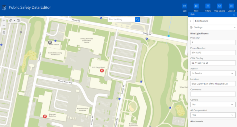

One of the tools Adams and the rest of the public safety staff have taken advantage of is ArcGIS Experience Builder. It was used to create a data editing application hosted on URI’s ArcGIS Enterprise portal. With this app, public safety staff don’t need to be trained in GIS to edit their GIS data. They use the edit widget to perform basic editing tasks: marking a security camera as out of service, creating a feature for a newly installed blue light phone, or moving an existing AED to a different location.
The ArcGIS Experience Builder application used by public safety staff to edit their GIS data.

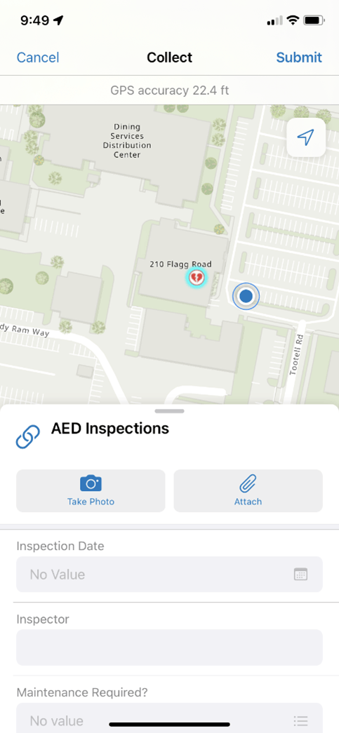

When not at their desks, public safety staff can access their GIS data using ArcGIS Field Maps on their mobile devices. Staff use ArcGIS Field Maps to inventory and inspect their automatic external defibrillators (AEDs), the red and white boxes seen on walls in public spaces. Inspection records are not spatial features, and do not appear as points on the map, but are maintained in a related table linked to the AED feature layer. Every AED has a global ID, a string of numbers and letters unique to a single feature. When the data collector selects an AED to inspect, that AED’s global ID is automatically recoded in the inspection table, linking the inspection to the device, and maintaining past inspections in the database.

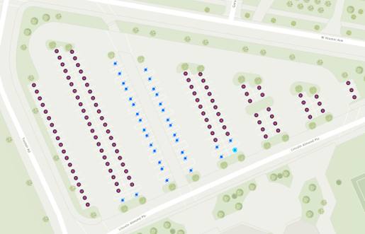

While AEDs, emergency phones, and security cameras are valuable public safety assets, there is no hotter commodity on a college campus than parking. The parking space inventory at URI is maintained in ArcGIS Enterprise and can be edited with ArcGIS Experience Builder and ArcGIS Field Maps.Parking spaces are symbolized as point features , colorized by use restriction—Americans with Disabilities Act (ADA), motorcycle, electric vehicle, or service vehicle—and further classified by user—commuter student, resident student, faculty/staff, visitor, or multiuse.
Transportation and parking staff use this data to decide how many and what kinds of parking permits to sell and inform the public of ADA parking accommodations. URI contributes data to Esri’s Community Maps program, so the ADA spots featured in the database are also incorporated into ADA spots on Esri’s publicly available basemaps. The parking data also serves the planning and real estate staff at the university to answer questions such as how many parking spots will be lost if the university constructs a new residence hall in a specific location.
URI's parking space inventory overlaid on the university-maintained community basemap.
