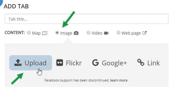

Once exported, the easiest and best way to add the slide images to your story map is to upload them from your local drives to the Esri Story Map Series app. When you use this method, the images are automatically resized and optimized and stored within your story map.
To add a slide image to your story map from a local file, first add a tab or bullet, click Image, and then click Upload. Browse for the image or drag it into the story map.

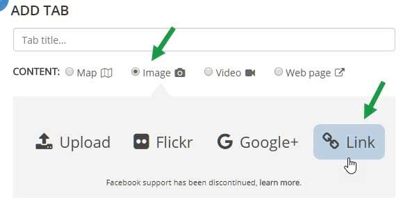

Add a Slide Image from a URL Location
To add a slide image to your story map from a URL location, add a tab or bullet, click Image, then click Link. Paste the URL into the link input.

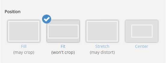

Position the Image
After adding your slide image, choose Fit rather than the default option, Fill.
Learn How to Give Presentations Using an Esri Story Map Series App
This provides the best results for slides with text; the entire slide will be displayed, ensuring that no text will be cropped. Fit also ensures that slides will display well on any projection resolution or aspect ratio.

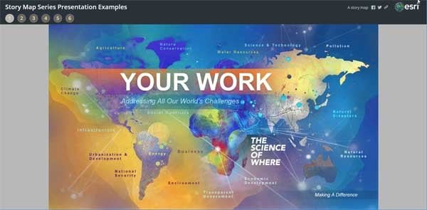

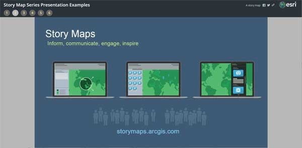

View a Esri Story Map Series Presentation Example
In this Esri Story Map Series example, a PowerPoint slide has been exported and added to the first entry. When adding slides, the text panel can be left blank—you won’t need it, since your slides will include all the necessary text.

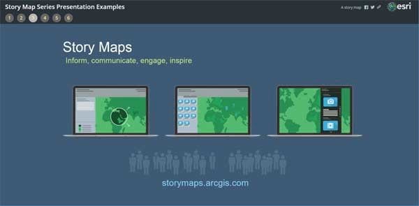

Take the Main Stage Background into Consideration
The main stage of Esri Story Map Series has a background color. When you use Fit, the main stage background may be visible around the slide edges.

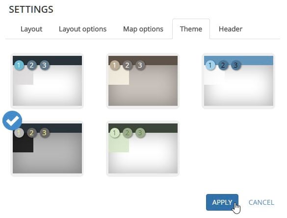

You can choose a different theme that will complement your slide background. Click Settings.
Then click Theme and choose the color scheme that works best with your slides. Click Apply when finished, then click Save.

Hide the Borders by Using Center
In some cases, you may know the exact display resolution for your presentation in advance. If you do, you have the option to determine the size needed to fill the main stage, add a few pixels on all sides to ensure that the slide completely fills the space, then use the position of Center.
Note: This technique only works when you build a presentation for a specific event and know the exact display size, since when you use Center, your slides can be cropped when displayed at different resolutions.
Eliminate the Background by Using a Web Page
You can eliminate the background completely by using a web page to display your slide, then adding the web page to the main stage. This method requires that you use a single-color slide background and display the slide on a web page that sets its background color to match the slide background. This is an effective technique for any display resolution or aspect ratio.
Below is a slide image inserted on the main stage using a position of Fit, as described earlier. View the example.
Below, the slide has been added using a web page that sets its background color to match the slide background color. View the example.

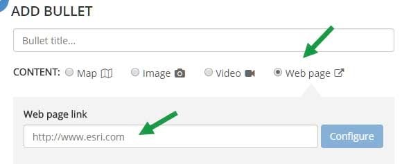

Create the Web Page
Copy and paste the markup below into a new HTML document and make the necessary edits for the background color and slide URL. Host the HTML document, then add it to your story map as a web page, using the default Fill option. The HTML will display the slide responsively so that it fits any size or aspect ratio. Remember that if your story map uses HTTPS, all your other media must use HTTPS.

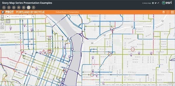

In addition to your slides, you may want to add web maps, apps, and other media. When adding a web map to use in a presentation, you may want to add the map using the ArcGIS Online Map Viewer to enable interactive demonstration capabilities. You can also add 3D scenes using Scene Viewer. Add them as a web page by using the URL of the web map or app.
Use the default Fill position. Since Map Viewer and most apps and app templates are responsive, they’ll fill the entire main stage area.

Tab 4: Embedded Map Viewer
By embedding Map Viewer using your organization’s URL, you have complete access to all the Map Viewer capabilities.
