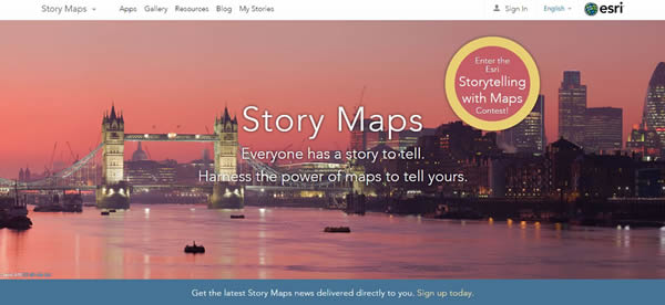

Step 1—Go to the Esri Story Maps website. At the top of the page, click Apps.
Scroll down the page until you reach Presenting a Series of Maps. Story Map Series has three layouts to choose from: Story Map Series—Tabbed Layout, Story Map Series—Side Accordion Layout, and Story Map Series—Bulleted Layout.

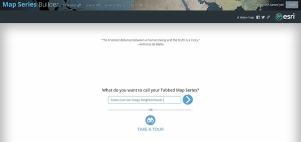

Step 2—When the Map Series Builder opens, enter a name for your story, such as “Some Cool San Diego Neighborhoods”.

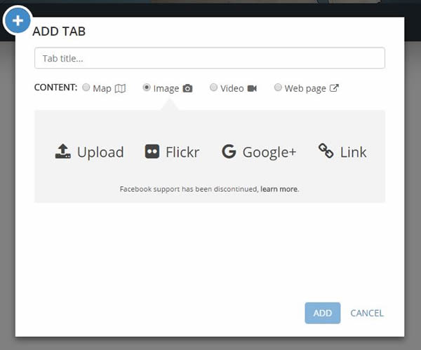

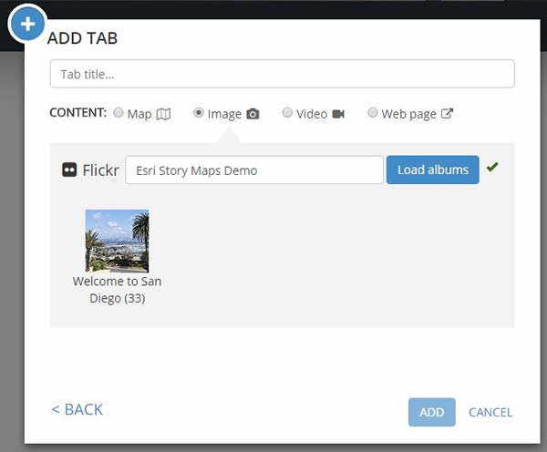

The ADD TAB dialog box opens, letting you add the first tab to your story map. Since this will be the cover of your story map, choose Image.
Next, select the Flickr option and type Esri Story Maps Demo in the search box. Click Load albums.
You will see the Welcome to San Diego album.

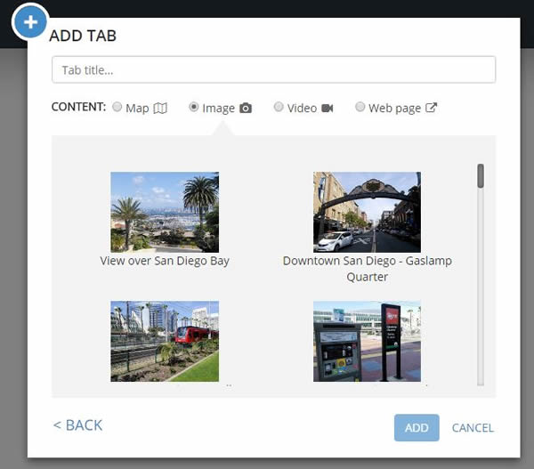

Step 3—Click on the Welcome to San Diego album and then on the photograph Downtown San Diego – Gaslamp Quarter.
Make sure that the Position default is Fill. This will fill the first tab of your story map with your image. If you use an infographic or other image that you want to make sure doesn’t get cropped at different browser widths, you would use Fit instead of Fill. Enter Intro as the title of your tab.
Click ADD. Below you will see an image of what your story map should look like at this stage.

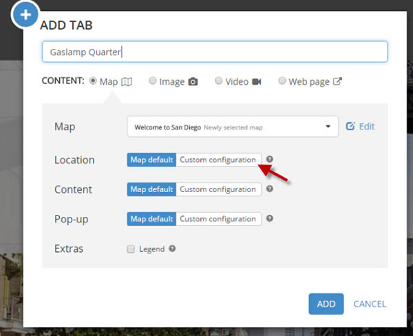

Step 5—Now click ADD to create a new tab title called Gaslamp Quarter. Select Map as the CONTENT option, then click the Map drop-down arrow and choose Select a map.

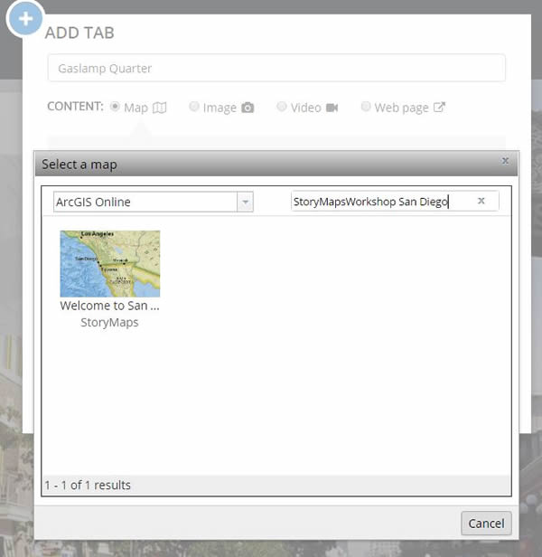

Step 6—Choose ArcGIS Online from the drop-down menu. This lets you find a publicly shared web map that someone else has created. Search for StoryMapsWorkshop San Diego and choose the Welcome to San Diego map.
On the ADD TAB dialog box, type Gaslamp Quarter as the tab title. Next to Location, click Custom configuration (rather than Map default).

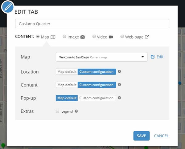

Write some descriptive text about your map. You can also include extra layers to your map if you wish. Click EDIT on the Map Series Builder toolbar. On the EDIT TAB dialog box, go to Content and choose Custom configuration.
Under MAP CONTENT, you will see a list of layer choices: Fun, Food, Design, Trolley Stations, Trolley Lines, Ferries, and Neighborhoods. Fun, Ferries, and Neighborhoods are already checked. Check off other layers you wish to add.
After making your choices, click SAVE MAP CONTENT. The EDIT TAB dialog box for the map will reappear. Click SAVE.
