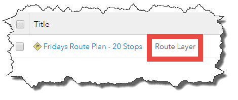

A route layer is an item type within ArcGIS Online. Route layers can be created from the ArcGIS Online Directions pane and by using the ArcGIS Online tools with network analysis capabilities: Find Nearest, Plan Routes, and Connect Origins to Destinations.

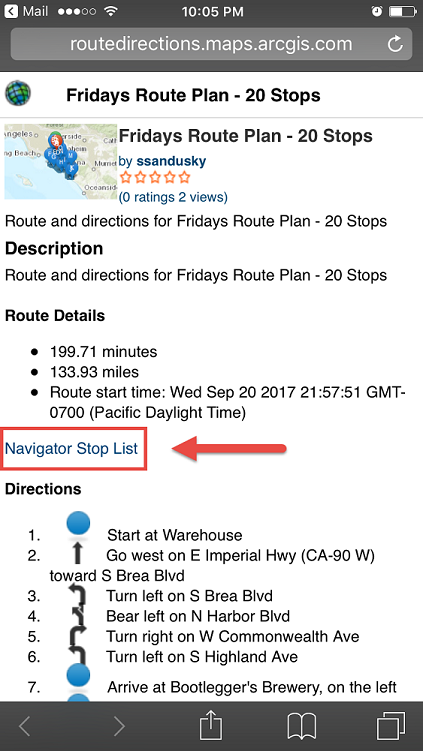

You can then view the route layer item on your mobile device and click the Navigator Stop List link. This automatically loads all your route’s stops into Navigator for ArcGIS.

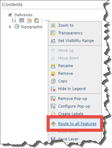

Step One: Create a route.
Using the Directions pane, build a route. Refer to the Directions pane help documentation for details.

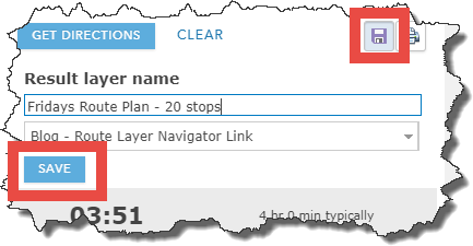

Step Two: Save your route.
Give your route a useful name and store it in a folder so that you know where to find it.

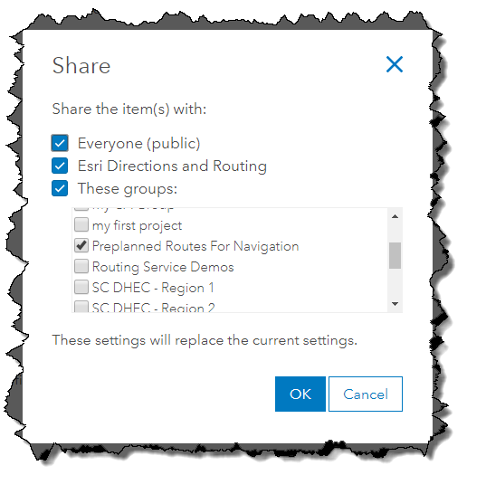

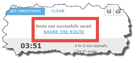

Step Three: Share your route.
The SHARE THE ROUTE link takes you to the route layer item details page where you can choose to share the route with everyone, your organization, or a specific group in your organization. For this example, we’ve shared the route publicly (so it’s available to you) and with a dedicated group for fieldworkers (to show how a group can be used within your organization).

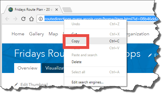

  • Copy and paste the URL from your browser and email or text it to your driver. An example would be this public route item.

Step Five: Open the link using a mobile device. Note that you must have Navigator installed and a map of the area downloaded, showing your stops. The map must be opened in Navigator. Enjoy!

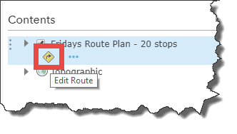

    • Any route layer item created before the September 21, 2017, release of ArcGIS Online will not contain the Navigator app link within it. If you want to add the Navigator link to an existing route layer item, you can edit the route using the Directions pane and resave it. To do this, add the route layer to the Map Viewer, choose Edit Route, then resave the route.
