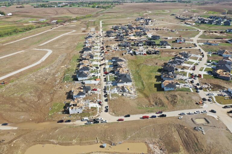

Finally, on the evening of April 26, nine tornadoes touched down near Omaha, Nebraska. They tore across the landscape for almost five hours and destroyed nearly 200 homes across eastern Nebraska and western Iowa, often leaving behind only basements. Almost 1,000 homes in total sustained some level of damage.
The tools Schonlau and his team had prepared went into effect as first responders sprang into action, assisting injured residents and collecting information on the tornadoes’ impact.
Nearly 1,000 homes across Nebraska and Iowa sustained damage from the tornadoes.

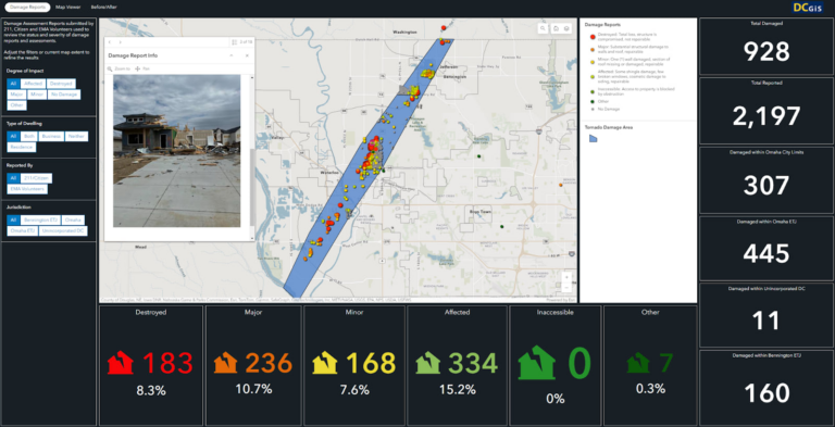

As residents began to call into the county’s 2-1-1 emergency line to report damage over the course of the day, operators input this data into the ArcGIS Survey123 form that Schonlau and his team had set up before the tornadoes struck. This was linked to the web app so that damage assessments would automatically populate within the affected area, allowing the GIS department and first responders to manage access to damaged areas and property. The app also included information—such as the types of structures damaged and the severity of the damage—and photos from the field, if available.
“In addition to [residents] and 2-1-1 call takers, we started to get emergency volunteers and inspectors from the city and county who were actually doing more formal damage assessments,” said Schonlau. “They were doing this through mobile apps we’d built, and all of that information started to show up in our web [app].”
Dashboards within the web app populated automatically with damage report information.

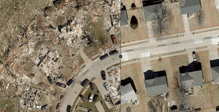

One of the most valuable features communicating the extent and nature of the damage was a swipe tool Schonlau and his team built into the web app. The tool showed what the tornado-affected areas had looked like just before the storm compared to immediately afterward. Luckily, aerial imagery of the whole county had been collected only a few weeks before the tornado, making the comparison especially valuable when the City of Omaha began to issue permits for rebuilding.
On April 30, just a few days after the tornadoes struck, Schonlau and his team presented the web app to the Omaha City Council and Douglas County officials, supplying an overall picture of the damage that had occurred. The web app was also critical in communicating with FEMA, which provided recovery assistance in the wake of the storm.
A swipe tool provides a stark visualization of the extent and nature of the tornado damage.
