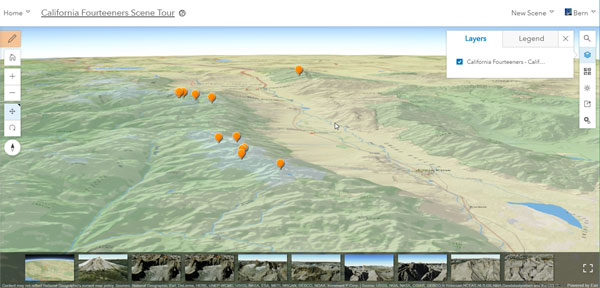

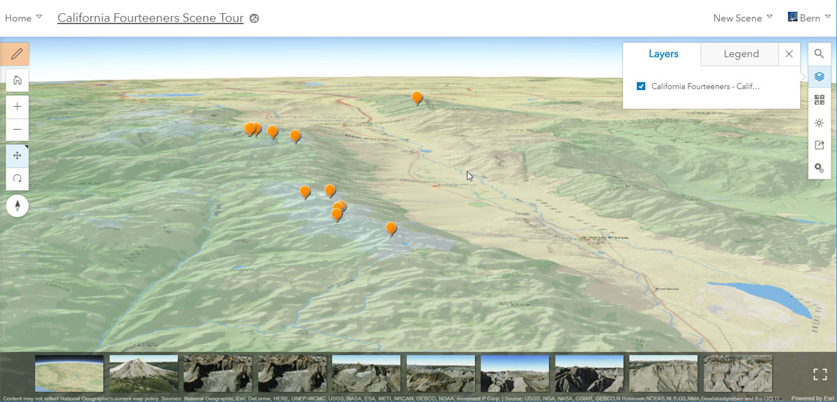

This example shows a scene using the full user interface:

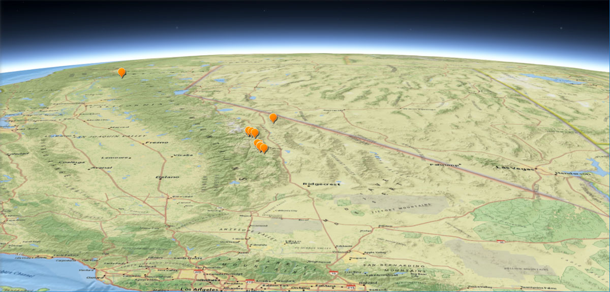

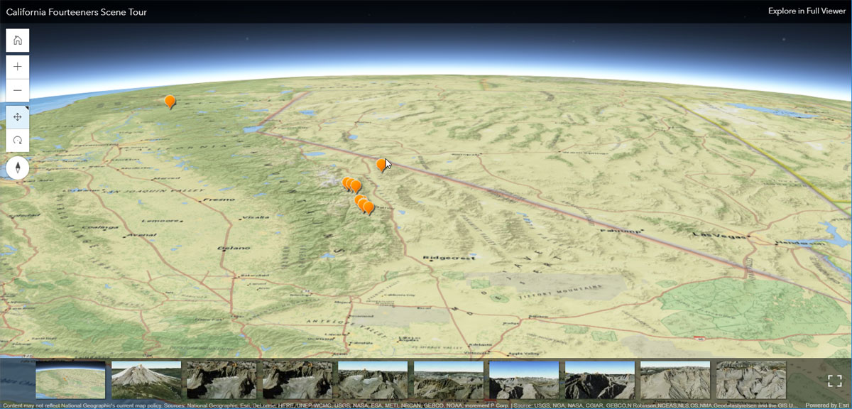

The URL below opens the scene with a minimal user interface:
http://www.arcgis.com/home/webscene/viewer.html?webscene=3e0a9746178e43688875720f9a9fa4c3&ui=min
When you mouse over the scene, additional UI elements will appear, such as the slide gallery and basic navigation tools.

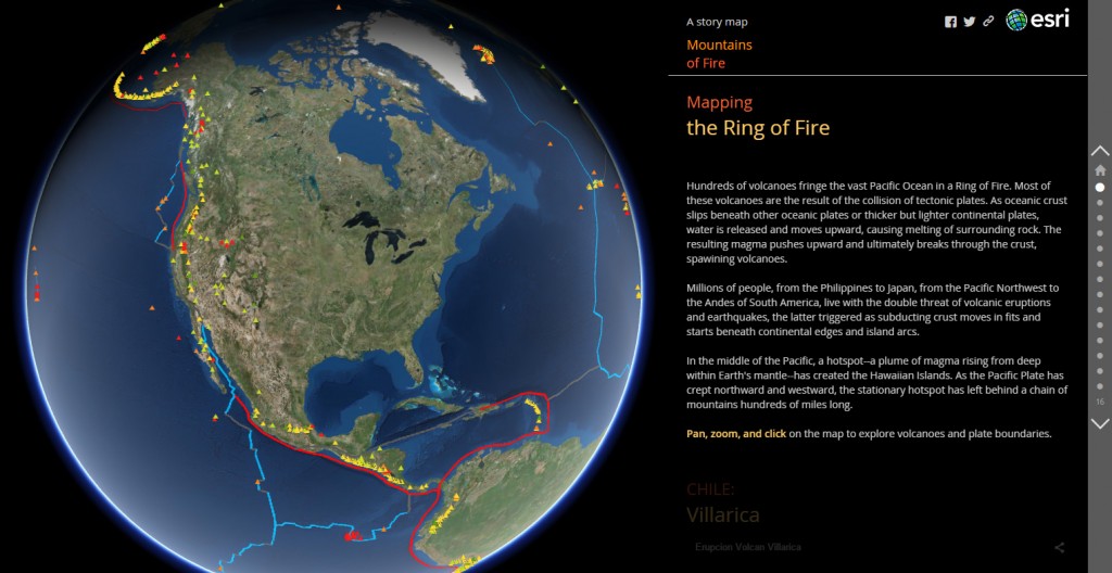

The minimized UI is useful when embedding scenes in web pages, or when using scene URLs in story maps, like the Story Map Journal shown below.
