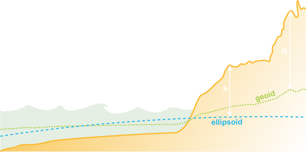

The vertical coordinate system defines the origin for height and depth values. Without the correct vertical coordinate system defined, you may see your data incorrectly shifted vertically, this is especially relevant when working with datasets with different vertical coordinate systems.
Whether you are working with an ellipsoidal or gravity-related vertical coordinate system, there are 4 main properties of a vertical coordinate system; datum or vertical datum, vertical shift, direction, and linear unit.
- The datum in an ellipsoidal VCS or vertical datum in a gravity-related VCS, is the reference point for elevation values.
- The vertical shift sets a built-in vertical offset, automatically adding or subtracting from each Z-value.
- The direction determines if z-values represent height or depth.
- The linear unit defines the unit of measurement for Z-values, generally in meters or feet.

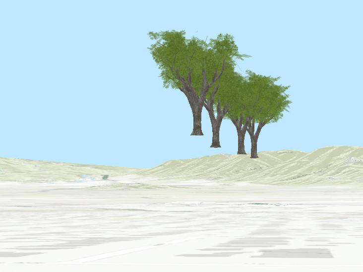

Just as with horizontal coordinate systems, transformations provide accuracy when working with multiple vertical coordinate systems. But because scenes can easily switch between local and global view and global scenes support fewer vertical coordinate systems (details below), transformations may be required even when all of your data is in the same vertical coordinate system.
For example, authoring a scene in local view using the vertical coordinate system EGM 1984 (a gravity-related vertical coordinate system is not supported in global view), and switching to global view will drop the vertical coordinate system and your data will shift. Specifying a valid vertical coordinate system, such as EGM 1996 and a transformation between them will rectify the shift.
To convert from ellipsoidal to ellipsoidal vertical coordinate systems, the standard horizontal coordinate system transformations are used. To convert from ellipsoidal to gravity-related vertical coordinate systems or to go between two gravity-related vertical coordinate systems, file based VERTCON, geoid models, or equation based transformations not included by default are needed. Because of the complexity and size of these transformations, they must be installed separately – available as the ArcGIS Coordinate Systems Data installation through myesri.com. These transformations must be installed anywhere they will be used, including your server if you share web layers that require a transformation.
Although the number of transformations available continues to grow, there are far fewer transformations to go between vertical coordinate systems than for horizontal coordinate systems. In the case that there is no transformation available, the linear unit will still be converted. For example, if your data is in feet but you set your scene in ArcGIS Pro to be a VCS that uses meters, the elevation values will be converted on the fly to meters – you may still see a shift but it will not be related to a mismatch in linear unit.
