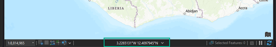

The default order to display geographic coordinates in ArcGIS AllSource map’s coordinate display is first longitude (the horizontal coordinate) and then latitude (the vertical coordinate).
Map display showing longitude and latitude in the coordinate display

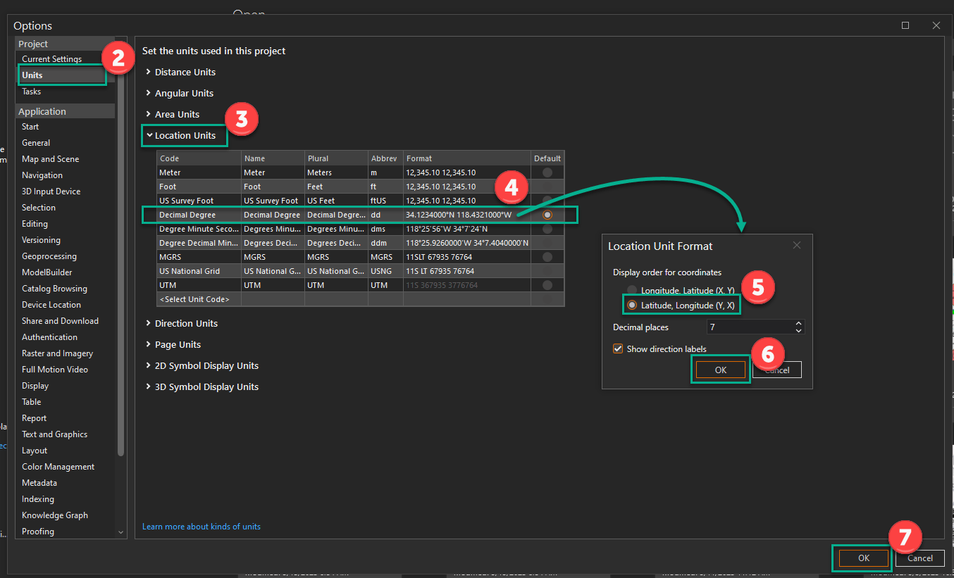

To change, or swap, the order in which they are shown in the map display, do the following:
Steps for changing coordinate display in the map
  1. Open the Options dialog box by doing one of the following:
    • Click the Project tab in an open project.
    • Select Settings in the ArcGIS AllSource start pane.
  2. Click Units in the Options.
  3. Expand Location Units.
  4. Click the coordinate values in the Format field in the Decimal Degree.
    • The Location Unit Format dialog box appears.
  5. Select Latitude, Longitude (Y,X).
  6. Click OK to close the Location Unit Format dialog box.
  7. Click OK to close the Options.

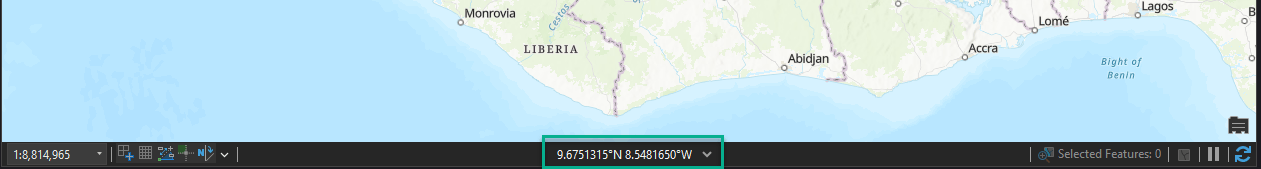

In your map, you should now see the coordinates displayed as latitude and then longitude. This will make it easier to read the coordinate display if you are used to reading latitude and longitude coordinates.
Map display showing changed latitude and longitude in the coordinate display
