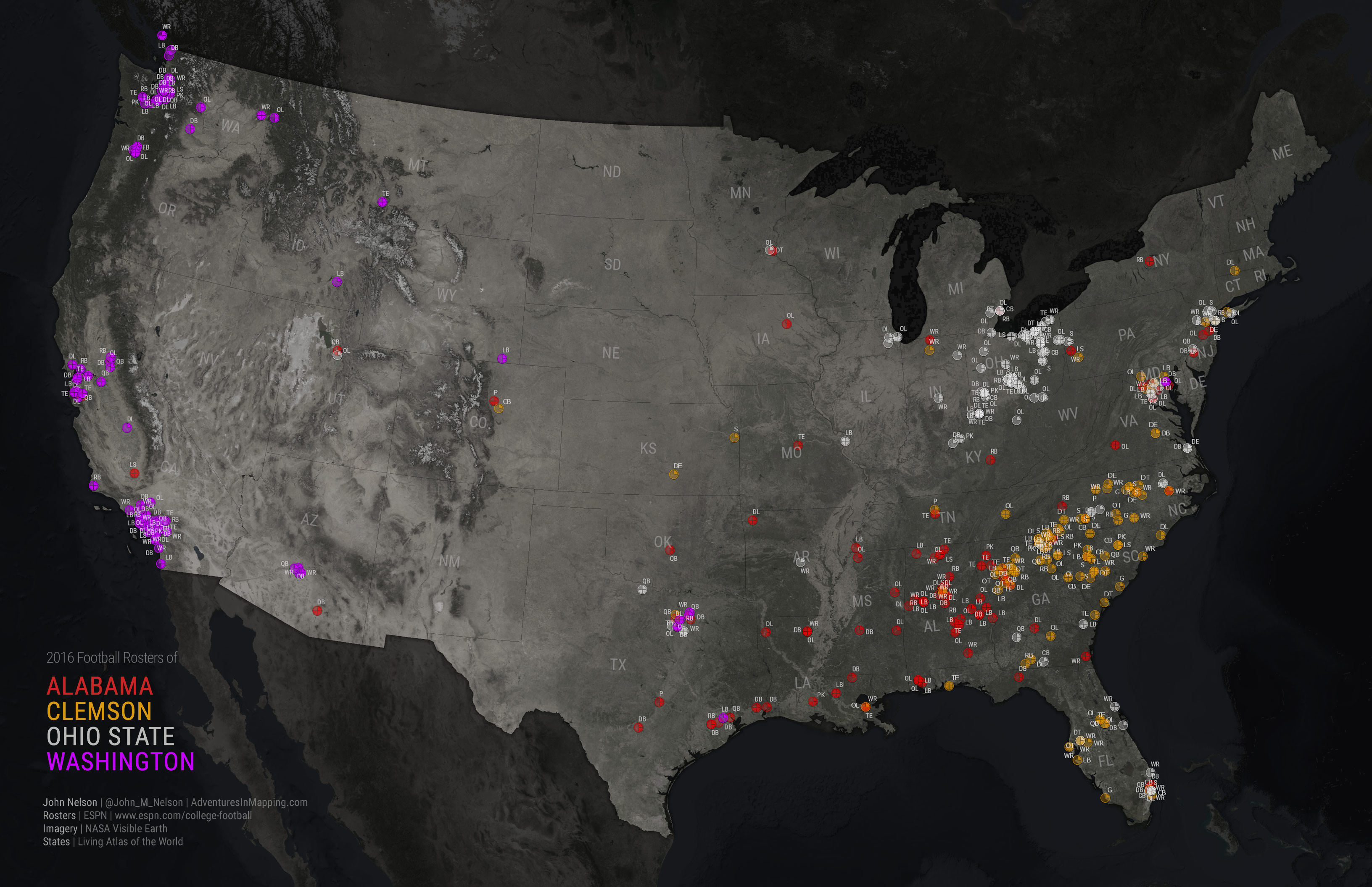

Geography also plays a massive role in the recruitment of players to these football programs. Local kids tend to draw the attention of nearby schools. Occasionally standouts from far flung locations get recruited, but it becomes rarer with increased distance. It’s the first law of geography. How do the recruitment footprints of the top four teams compare? Here’s a look…
Wow, that is actually a really well-distributed constellation of players!  Let’s take a closer look at each team’s players, and quantify their hometown footprint with something called the Air Mile Index.

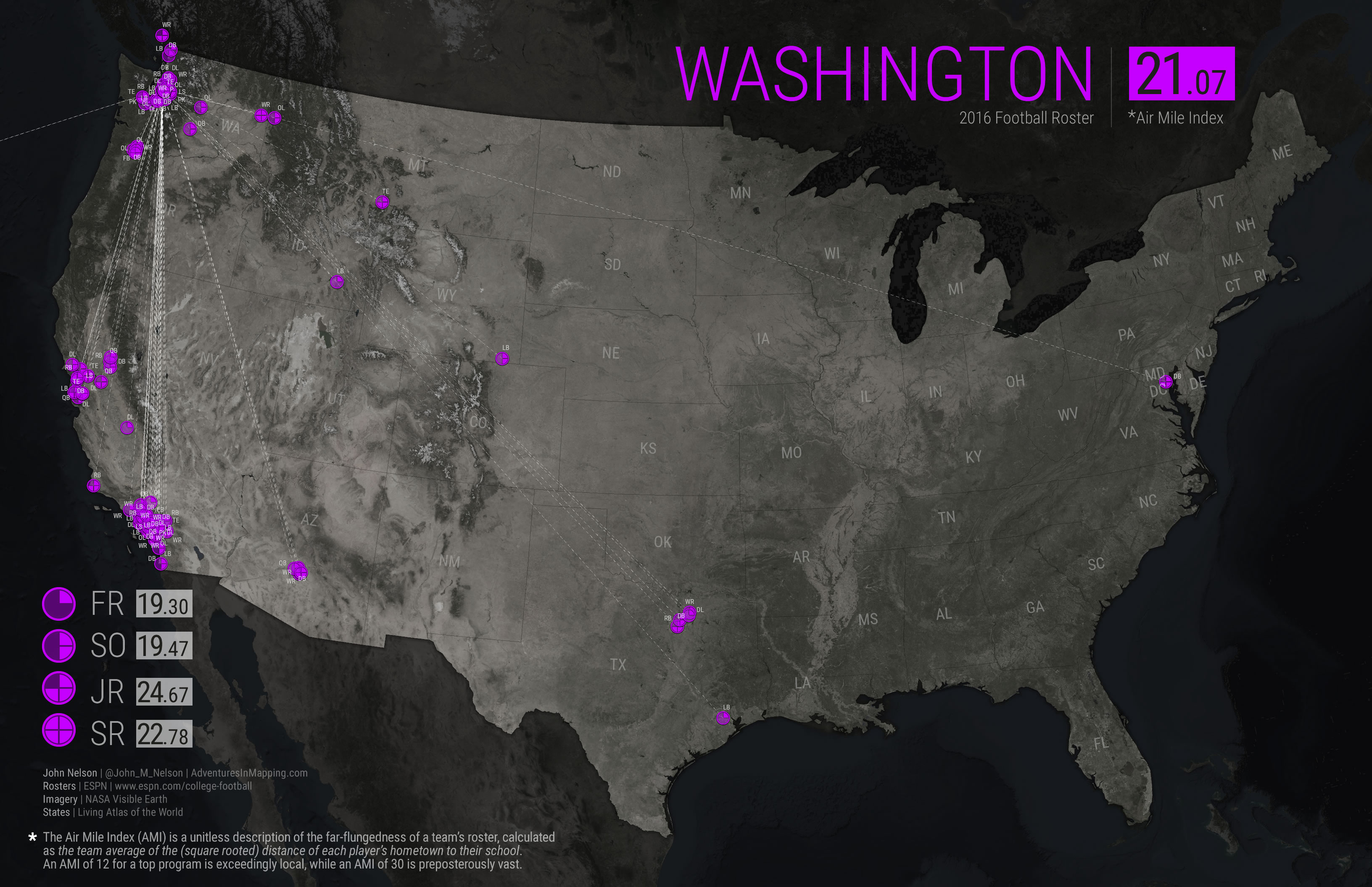

Washington
Washington, having the highest AMI of the tournament teams, is comprised almost exclusively of recruits coming from local towns and the two major population centers of California. Only one player has a hometown east of the Mississippi. There would have been essentially no overlap in the Friday Night high school football games attended by Washington assistant coaches and the coaches from the other three tournament teams, except perhaps a couple times in Dallas. But everybody recruits from Dallas.

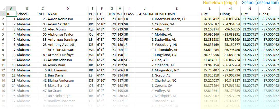

These maps started out as the team roster pages at ESPN. I copy/pasted the top ten football teams into a good old spreadsheet. I added a unique “ID” field so that I could join this data to spatial data, later on.
I geo-coded the hometowns of all the players, and the stadiums of each team. When we make the lines in a bit, we’ll use them as the start and end inputs.

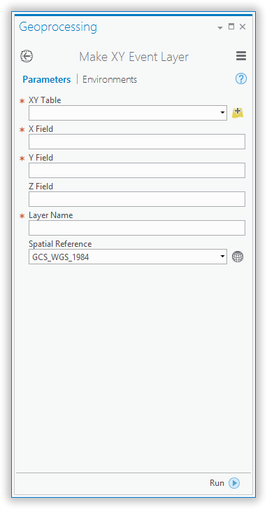

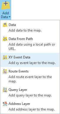

Back to it! Next, we’ll bring in the same spreadsheet data again, but this time as a point file -to mark the locations of all these player hometowns. There’s an option to add “XY” data…
…which launches a little form asking you where the data table lives, and which parts are latitude and longitude.
Boom. The table is added to the map once again, this time as the hometown points. In addition to a web of lines converging at top national programs, we see a constellation of proud towns, the launching points of over four hundred players.

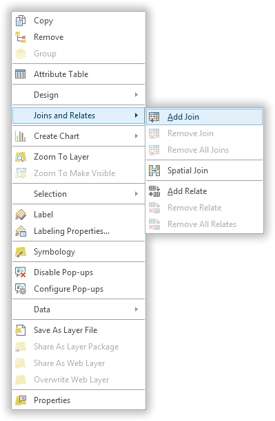

Thankfully, you can just borrow the attributes of the hometown point file you just added, by joining it using the ID field. Right-click the line layer, and choose “Add Join”.
Then you just Join your line file to your point file’s attributes, using their common ID field. Now it’s inherited all that good information about each player.

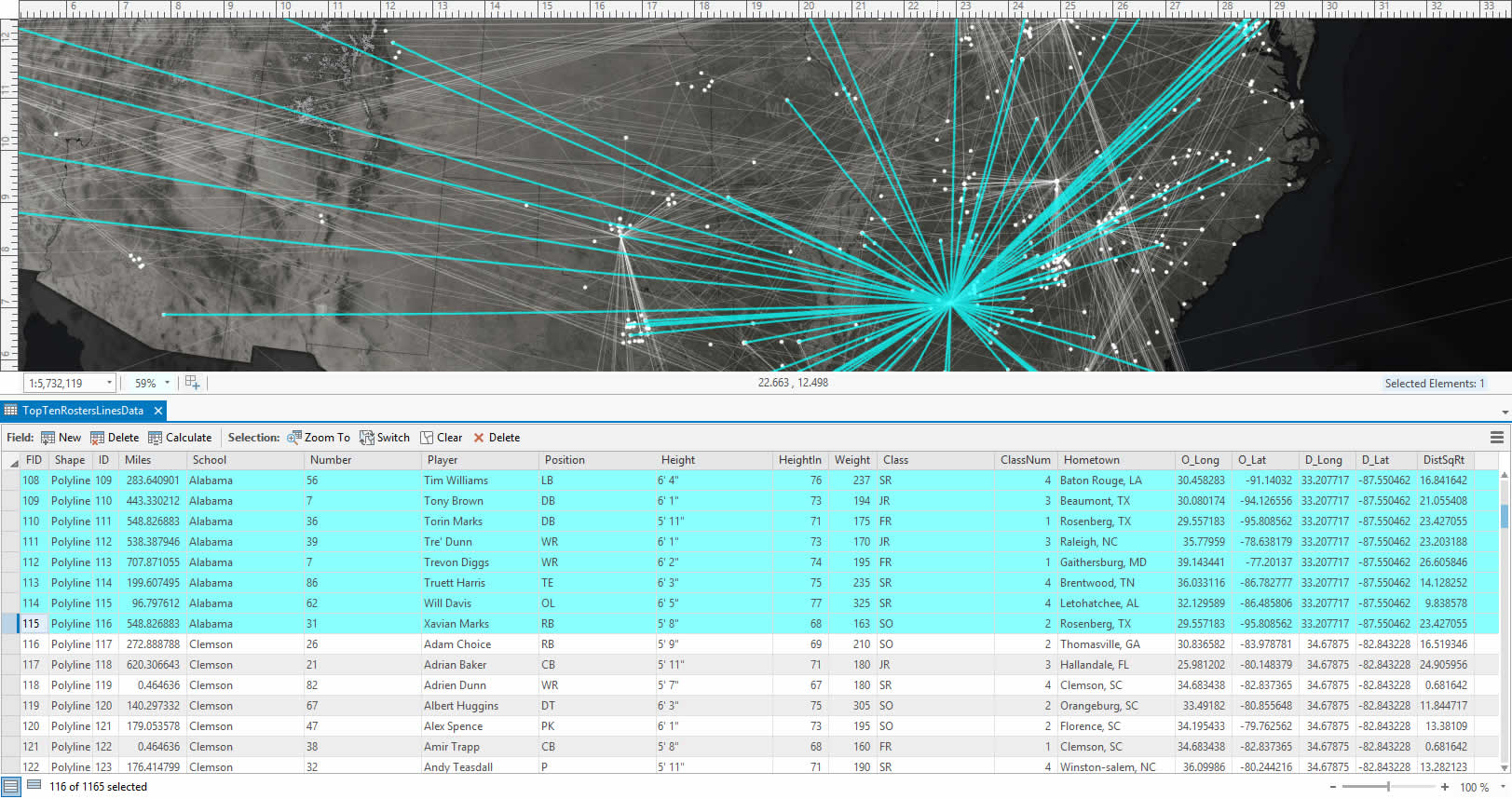

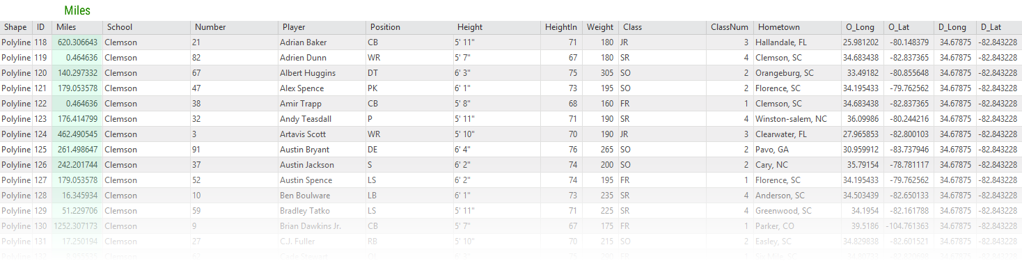

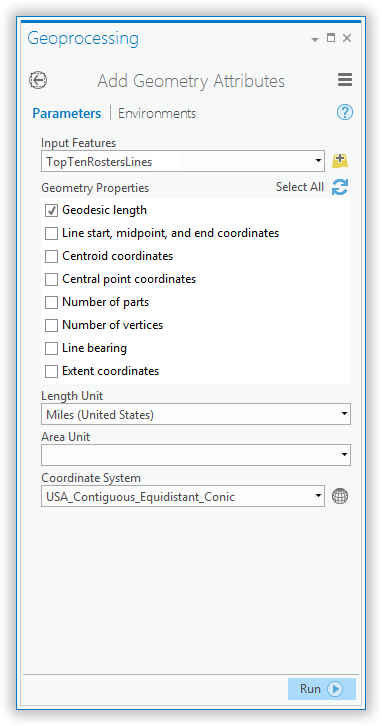

Time to measure the distance of each line -we use that to calculate the Air Mile Index. There’s a tool called “Add Geometry Attributes”. We’ll use that to measure the length, in miles, of each line connecting a hometown to a school.
There it is. The (exquisitely precise) length of each line.

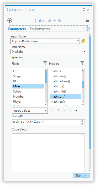

To spatially normalize this a bit, tamping down the influence of cross-country kids or international kids, we’ll need to calculate the square root of the mileage. So, make a new field, and use the field calculator to get the square root of the mileage.
There it is. The square root of each player’s traverse to school. Take the average of this for each team and you have the Air Mile Index.

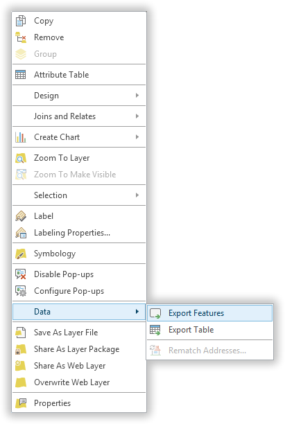

But look what a mess it is showing all those team lines at once. You’re better off separating the spaghetti map into ten separate school maps. In the attributes table for the lines, just manually select the rows for a team (or do a select by attribute).
Then, when those guys are selected, right-click the line layer and export them as their own file.

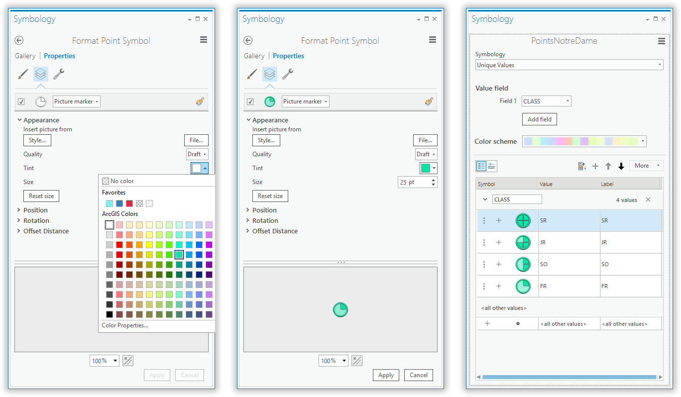

After this, all there is to do is apply some symbology to the player hometowns, thematically representing what class they are. You can use my images as point symbols if you want. And here’s how you can shade them by their school color…
And there it is! A picture marker for each player, showing what class year they belong to, tinted by team. In these maps I also labeled the points by player position.
