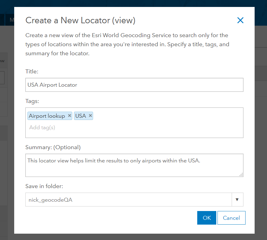

Step 1 – Create a Locator View
Navigate to your My Content Tab, and create a new “Locator (view)” Item.   Fill in the relevant details for the locator view that you want to create to filter your geocoding.

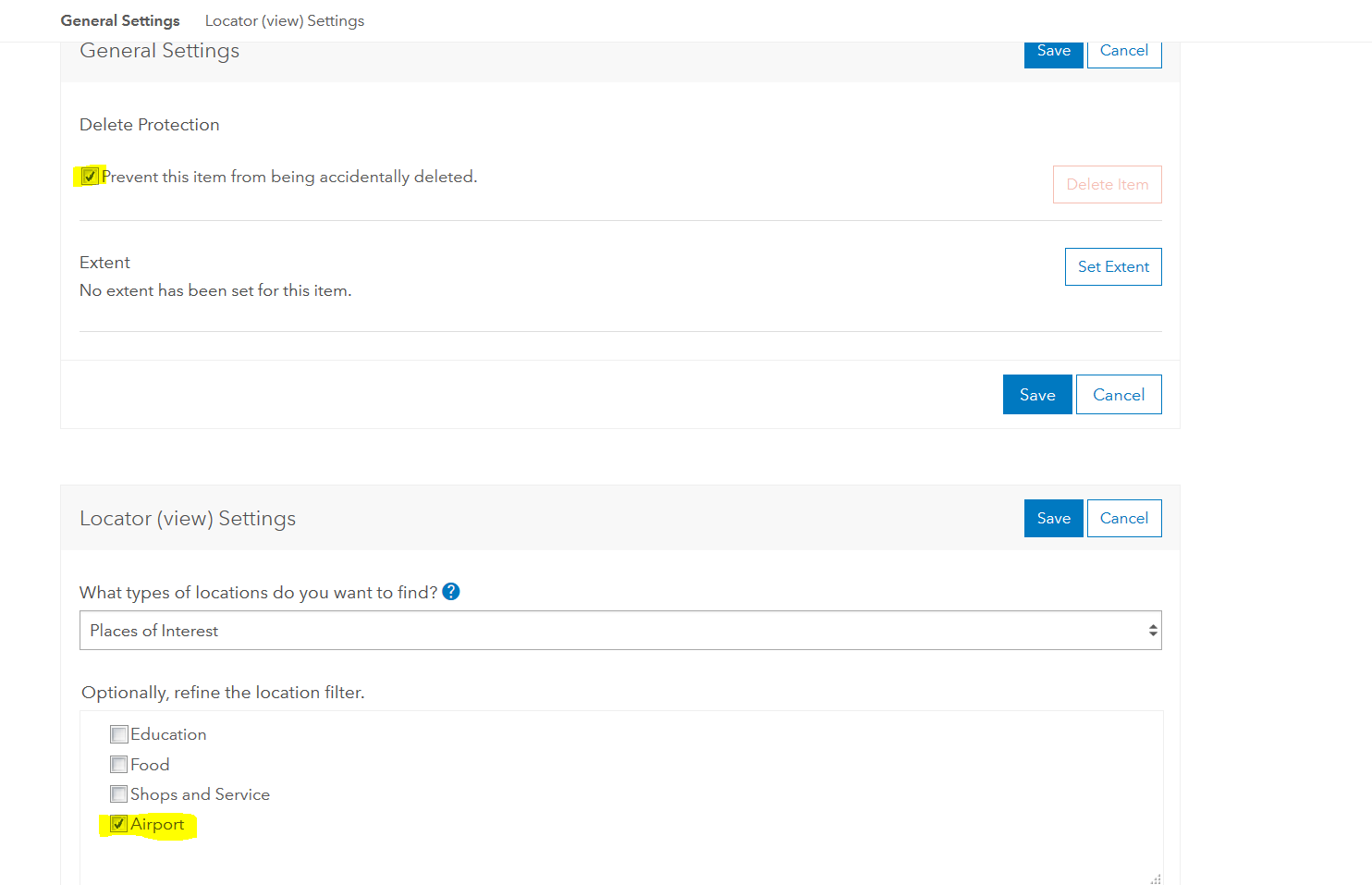

Configure your Locator View to search for only specific types of locations within the area you’re interested in using the settings page for the Locator View item you just created.
You can protect the Locator View item from accidentally being deleted.
Next, you can define the types of locations you want to find, whether it is 1) Addresses, Postal Codes, or Populated Places, 2) Coordinates (e.g. MGRS, USNG), or 3) Places of Interest (e.g. Education, Food, Airport).  A complete listing of supported categories and coordinates are provided in the documentation: http://arcg.is/2wigsR3.  In this scenario, I will select ‘Airport’ for our Locator View.

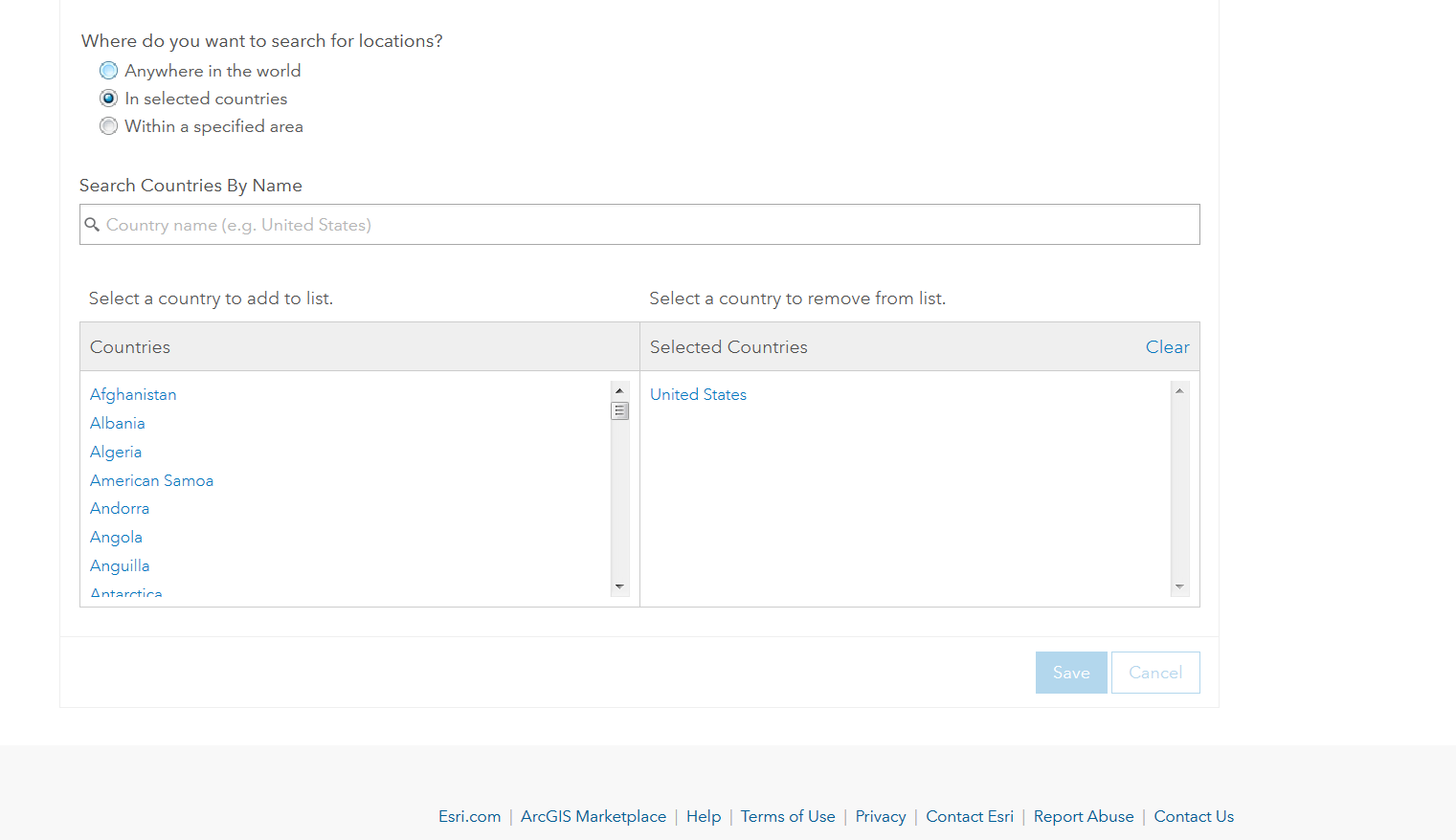

Within Settings page, you can define where you want to search for the location type you’ve selected.  You can select Anywhere in the World, limited to Select Countries, or define a specific area of interest based on a rectangular extent that you define.  I will select the country mode and choose ‘United States’.
Finally, click the save button to update the Locator View item with the settings you’ve selected.

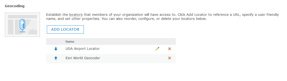

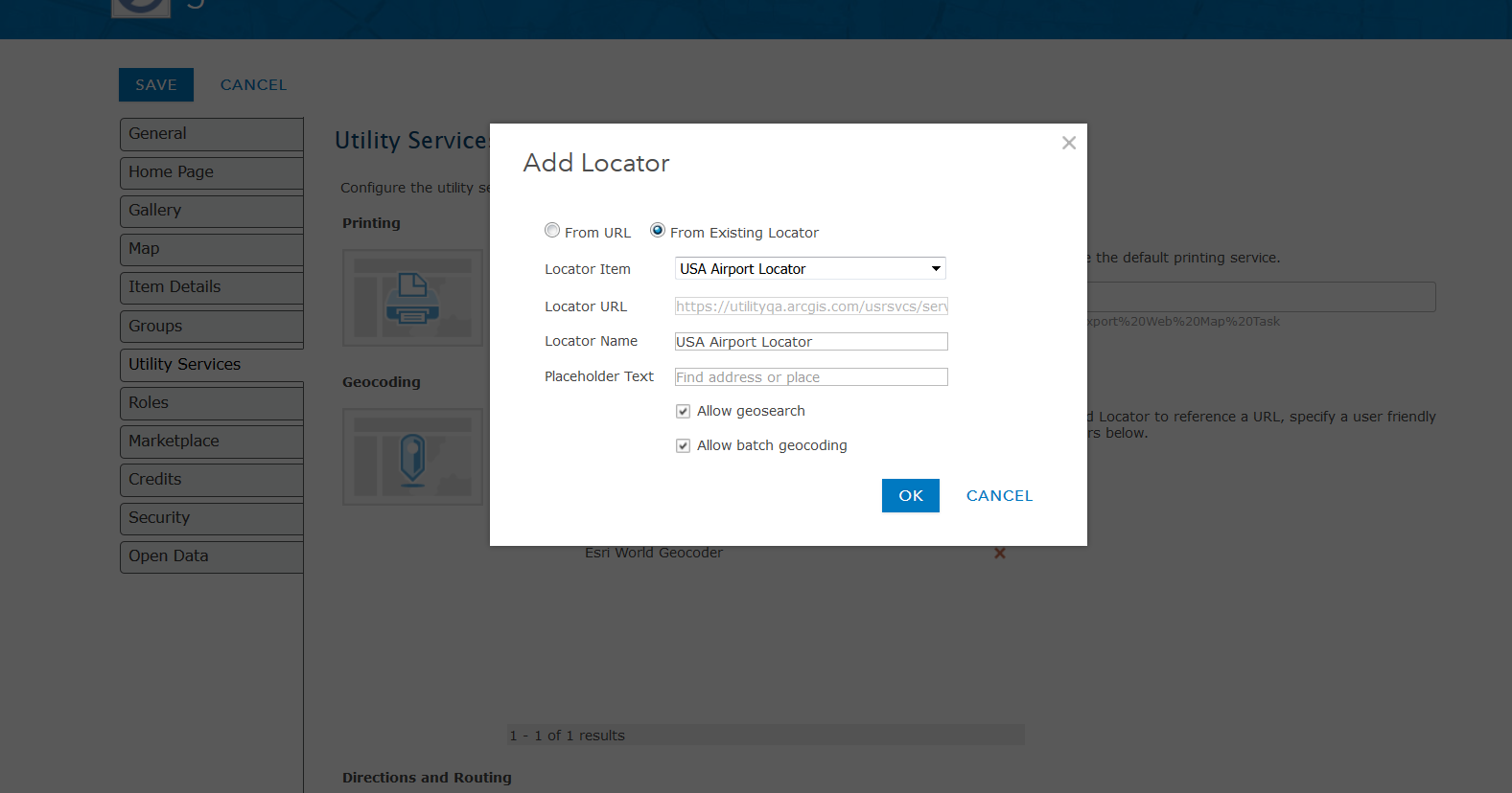

Once it is shared, have your administrator go to the Organization tab, and select Edit Settings, and under the Utility Services menu.  The admin can add the USA Airport Locator view that you’ve created.
In this step, the administrator can also limit this locator for GeoSearch only or configure it to allow both, GeoSearch and Batch Geocoding.  This is especially important for administrators that want to limit the batch geocoding operation as it consumes service credits, while the GeoSearch does not consume any.
Keep in mind that with batch geocoding, the same service credit rates apply regardless of whether you are batch geocoding through the locator views or through the Online World Geocoding service.
You can adjust the search tree by putting the Locator View on top of the Esri World Geocoder or after it.  The benefit of putting it before the Esri World Geocoder is that your search requests will locate to airports first and then through the Esri World Geocoder.

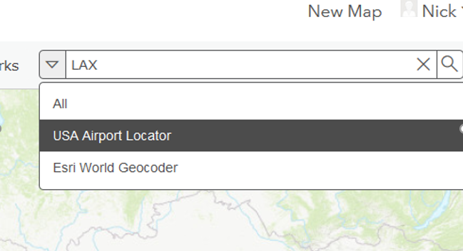

Your new locator view is all set up.  Open the map viewer and select the drop down button in the search pane to bring up the locators you want to search against.  You can select the newly created Locator View, “USA Airport Locator” to limit your searches to USA airports.
Also, it is worth pointing out that once the admin configures your newly created locator view in the utility service settings, the locator is available for use in any ArcGIS application that uses the organization’s locators configured in the utility services settings.  For example, a user using ArcGIS Maps for Office will be able to geocode against the locator view you’ve created to geocode their airport codes in Excel.
Happy airport searching!  Try searching for ‘LAX’ and an international airport such as ‘CDG’ and you’ll notice that only airports in the USA are found with the Locator View you created.
