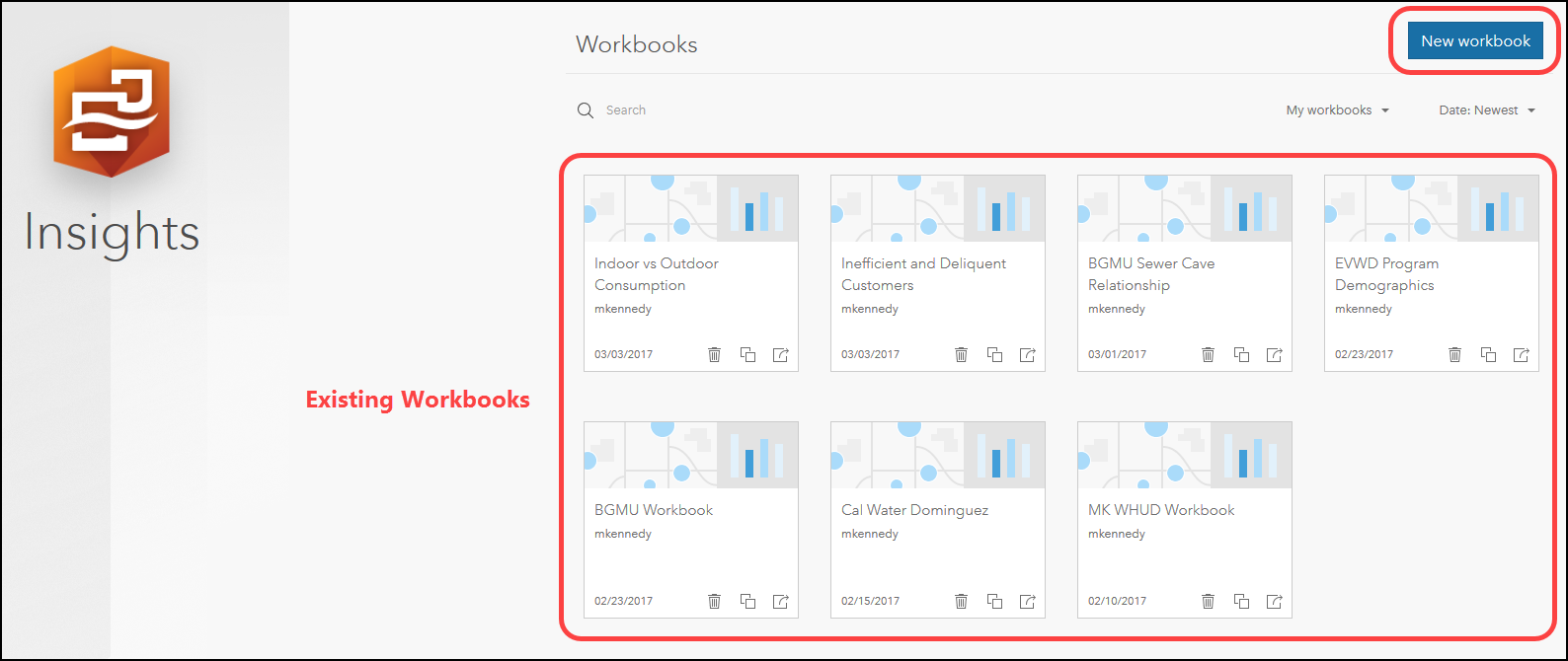

Signing into Insights for ArcGIS brings you to the landing page where you can access existing workbooks or start new ones.

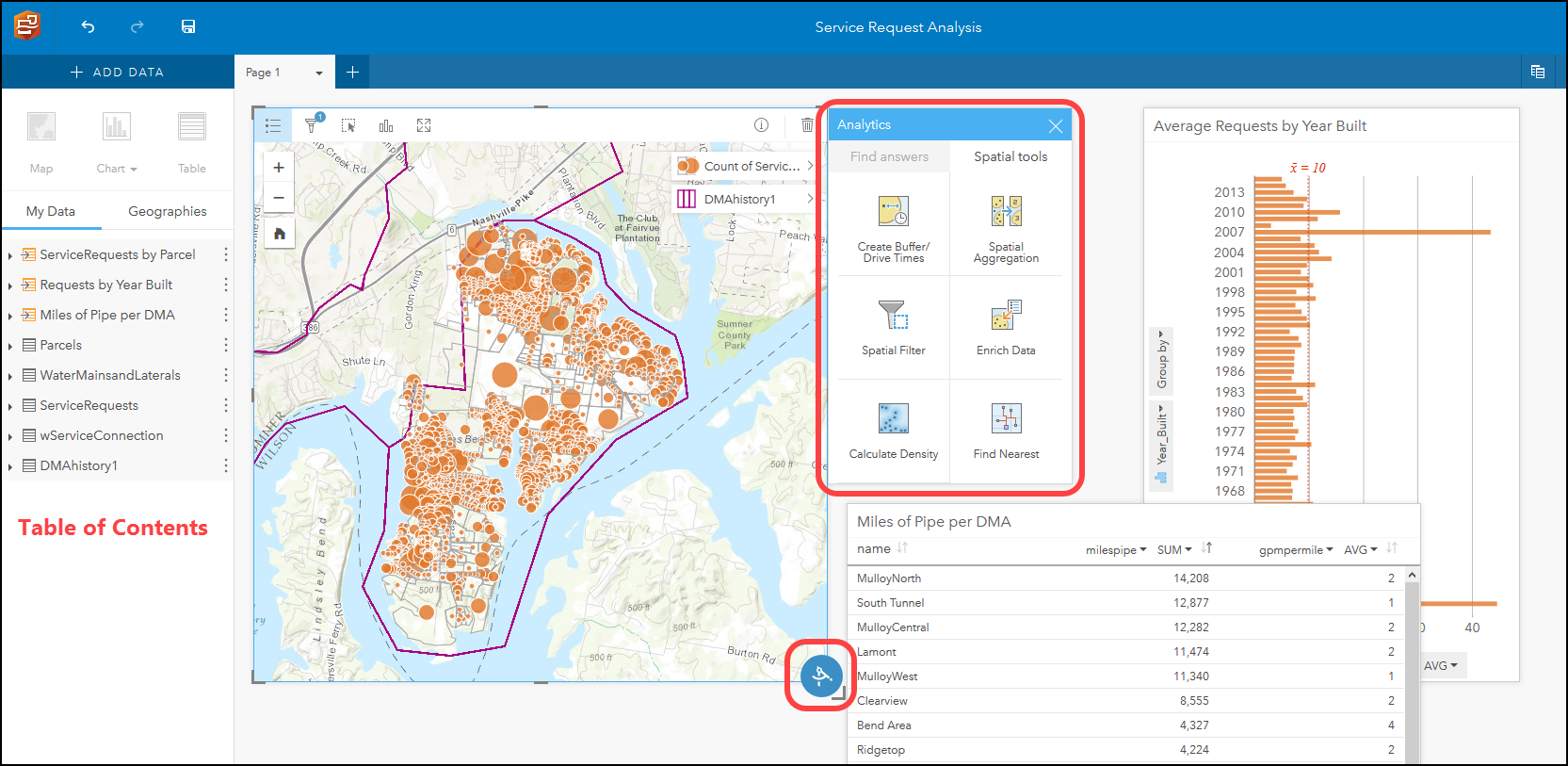

Use the Action Button on map cards to access powerful spatial analysis tools or to ask your data questions such as “How are these datasets related?” or “How has this aspect changed over time?
The three cards you see; a map, a table, and a chart, were created by dragging data from the workbook’s table of contents onto a page. The Action Button and its analysis options are accessed from the map card.

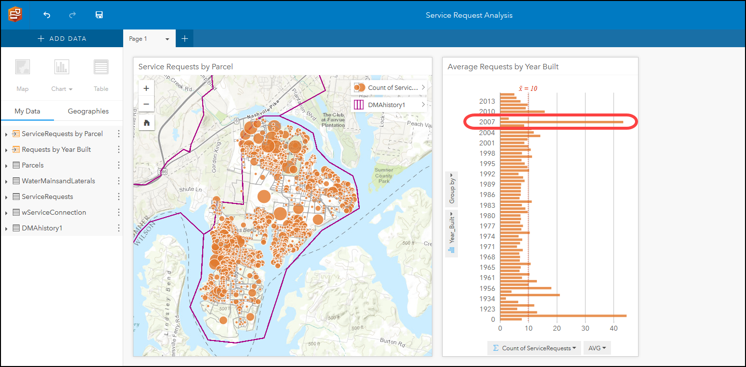

 Because it is so easy to just dive into your data and ask questions, you can quickly arrive at results that inspire the next round of questions that may need asking.  For example, the question “How does the age of a housing development relate to the number of leaks?” is quickly answered by examining the relationship between service request and parcel data.  Aggregating the number of service requests to each parcel and then graphing the number of requests by parcel age might show an expected pattern—that older parcels generally receive more service requests.  However, during your exploration you might also discover an outlier that does not fit the trend, such as the existence of one or two newer property developments with much higher than expected rates of service requests.  That reveals the next question: Why are these new properties reporting more service requests than developments that are far older?
The chart on the right shows an abnormally high number of service requests for developments built in 2007. This outlier may have been difficult to spot with traditional analysis techniques.

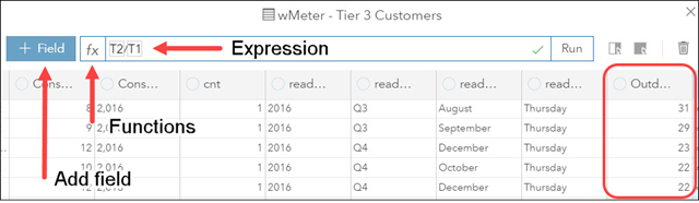

The Action Button has more than just spatial analysis tools.  There are also tools that help you generate new data to work on.  For example, let’s say you needed to find all the customers who use ten times or more water outside their homes than inside.  Insights can help you figure out how outdoor and indoor water use are related by calculating a ratio on the fly.
The new field, outlined on the right, was created using the Add Field button and functions to create the desired expression. In this case, field ‘T2’ was divided by field ‘T1’ to compute a ratio of outdoor vs. indoor water use.
You will find there are several string, numeric, and date functions available to help derive data on the fly, and keep your data exploration going in whatever direction it may lead you.

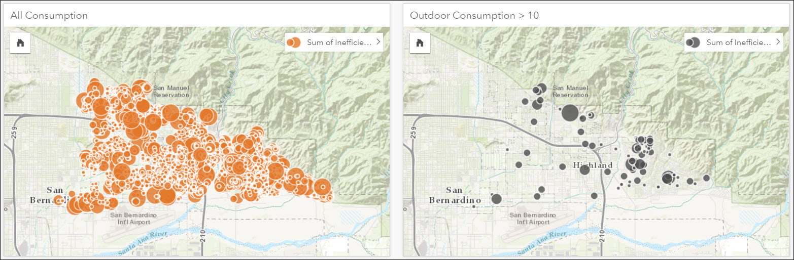

Using the Action Button, to create a ratio of outdoor vs. indoor water consumption, made it possible to single out the customers who use ten times or more water outside their homes than inside (right).
