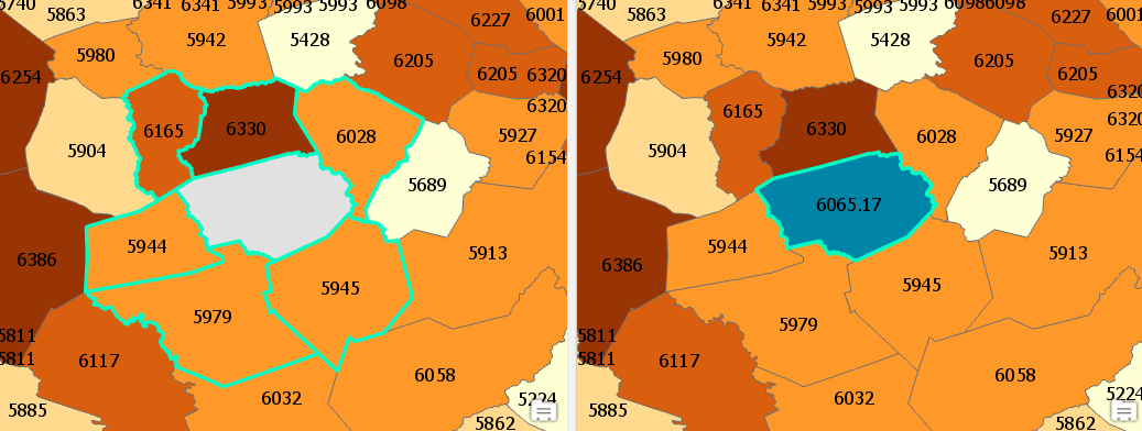

Fill missing values lets you select a ‘fill method’ which includes average, minimum, maximum, median and temporal trend. You also define neighborhoods used to find the values for the fill method calculation. You can use fixed distance, k nearest neighbors, contiguity edges, contiguity edges corners or a spatial weights file. An example below shows the tool using 6 nearest neighbors and the average fill method. The grey polygon on the left has a null value and the light blue highlighted polygons represent its 6 nearest neighbors. After running fill missing values, we can see that the polygon is given the value of 6065.17, the average of its 6 neighbors.
Fill Missing Values with the average of the 6 nearest neighbors

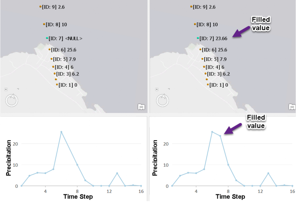

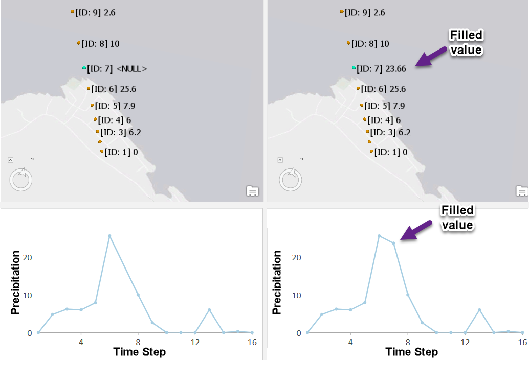

Fill Missing Values also lets you use a temporal trend if you have time series data (if you have station data each location will need to have a unique ID). In the example below [ID: 7] is missing a reading for precipitation from a weather station. Fill missing values will interpolate the trend of the data at that location and return the value at the missing time.
Fill Missing Values using Temporal Trend
