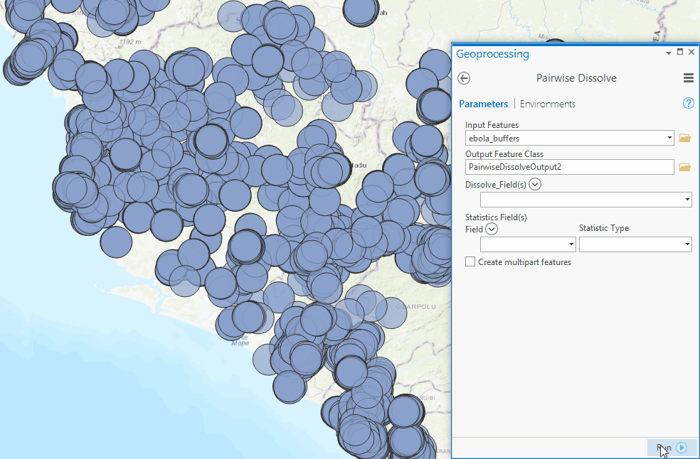

Example
I was recently running a Dissolve operation on 20,000 overlapping polygons. While this isn’t a huge process, it still took several minutes to complete. I was wishing it could run faster by splitting the operation up and using all 4 cores on my desktop machine. While the Dissolve tool does not support parallel processing, the Pairwise Dissolve tool does. Using the Pairwise Dissolve tool with it’s default Parallel Processing Factor setting (full parallel processing–the tool distributes the work to all machine cores), the same dissolve process took less than 3 seconds.
Now that’s unparalleled performance!
