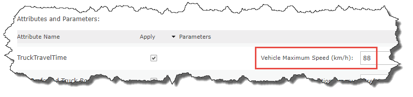

First, create a new travel mode in your organization.  To do this, you must be an administrator of your organization.  Details are in the travel mode help documentation.  In the example below, we’ve chosen to make a copy of the Trucking Time travel mode.  In your travel mode, under “Attributes and Parameters”, there is a new parameter on TruckTravelTime for the Vehicle Maximum Speed (km/h).  By default, this value is set to zero, meaning that there is no maximum speed specified.  In the image below, we’ve updated the parameter to be 88 km/h (which is equivalent to 55 mi/h).  After updating this value, save your travel mode.

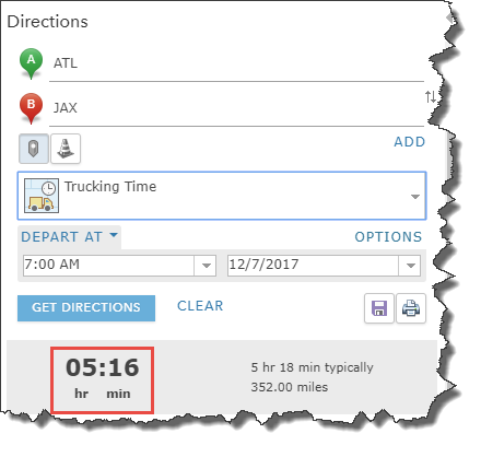

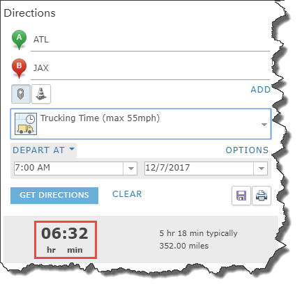

Next, test your travel mode.  In the Map Viewer, open the Directions pane. Use the Trucking Time travel mode to create a route, from ATL airport to JAX airport.  Solve it with the original Trucking Time travel mode, and then with the newly created travel mode with the maximum speed.  Notice how the total times vary.  In this case, it’s a difference of 76 minutes!  With the vehicle maximum speed set to 88 km/h it takes about 6 hours 32 min, whereas if this isn’t specified it takes 5 hours 16 min.
