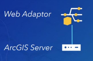

Standalone ArcGIS Server installations
Are you upgrading a standalone ArcGIS Server installation (no portal or data store)? Then follow the steps outlined in the Upgrade ArcGIS Server help topic.
A few key highlights:
  • All ArcGIS Enterprise 10.5 components needs shiny new licenses to get up and running. If you’re upgrading from ArcGIS for Server versions 10.1 through 10.4.1 you will need to go to My Esri and get new license files. If you’re upgrading from 10.5 to 10.5.1? No need for new license files, you’re all set.
  • You can upgrade ArcGIS Server in-place when going from 10.1 or higher to 10.5.1. No need to uninstall the existing software first or make any architectural changes. Smooth sailing!
  • Upgrading a multi-machine site? Upgrade one machine at a time. During the upgrade your site will be offline, so a good strategy is to shut down all machine except one, perform the upgrade in-place on that first machine, and then upgrade the rest one by one.

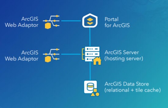

ArcGIS Enterprise deployments
If you’re upgrading a deployment that has the full ArcGIS Enterprise stack of components – that’s Portal for ArcGIS, ArcGIS Server, and ArcGIS Data Store – then the upgrade process has some additional steps. Each of the components must be upgraded together and in a certain order. Follow the steps from the Steps to perform an upgrade of your portal deployment help topic.
Be sure to follow the detailed steps and in the prescribed order (it matters!), but a simple summary is:
  1. First upgrade the Portal for ArcGIS component including the associated web adaptor.
  2. Next upgrade any federated ArcGIS Server sites (including your hosting server site) and again the upgrade includes also upgrading any associated web adaptor(s).
    1. Follow the upgrade steps for ArcGIS Server mentioned above, including how to upgrade multi-machine sites.
    2. Important: don’t unfederated your ArcGIS Server sites before the upgrade. It’s unnecessary and breaks important functionality. Don’t do it.
  3. Finally upgrade ArcGIS Data Store that was configured with your hosting server site.
