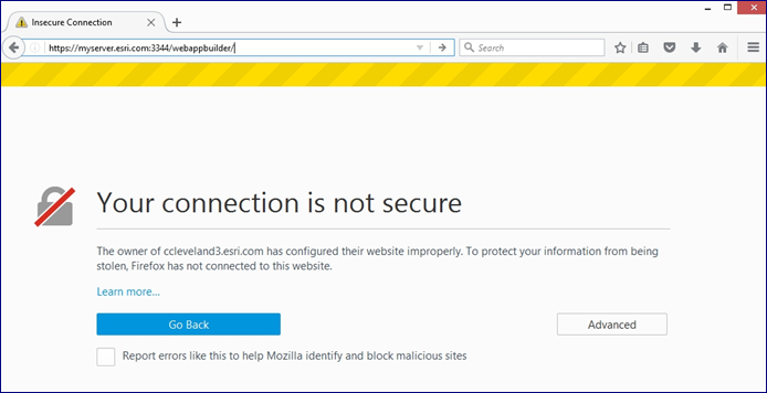

For those of you working with Web AppBuilder Developer Edition, you may have noticed the first time you browse to the site in a session you’re presented with a message from your web browser that looks something like this:
The reason this happens is because Web AppBuilder Developer Edition is using a self-signed certificate when communicating over the HTTPS protocol. FYI: trusted security certificates are used to create secure connections to a server via the Internet. Many of us will add the web browser exception, move on and not think about it again. However, this is not a security best practice, and in some environments can be a “showstopper”.

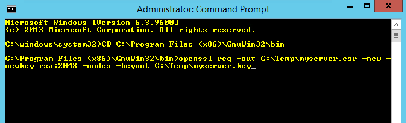

  1. The first step is to generate a new private key and Certificate Signing Request.  Open a command prompt as administrator on your local machine by right clicking on Command Prompt in your Start Menu. Navigate using cd to the install location of openssl (e.g. C:Program Files (x86)GnuWin32bin) and run the following command, replacing “C:Tempmyserver” with your desired filename:
    • openssl req -out C:Tempmyserver.csr -new -newkey rsa:2048 -nodes -keyout C:Tempmyserver.key

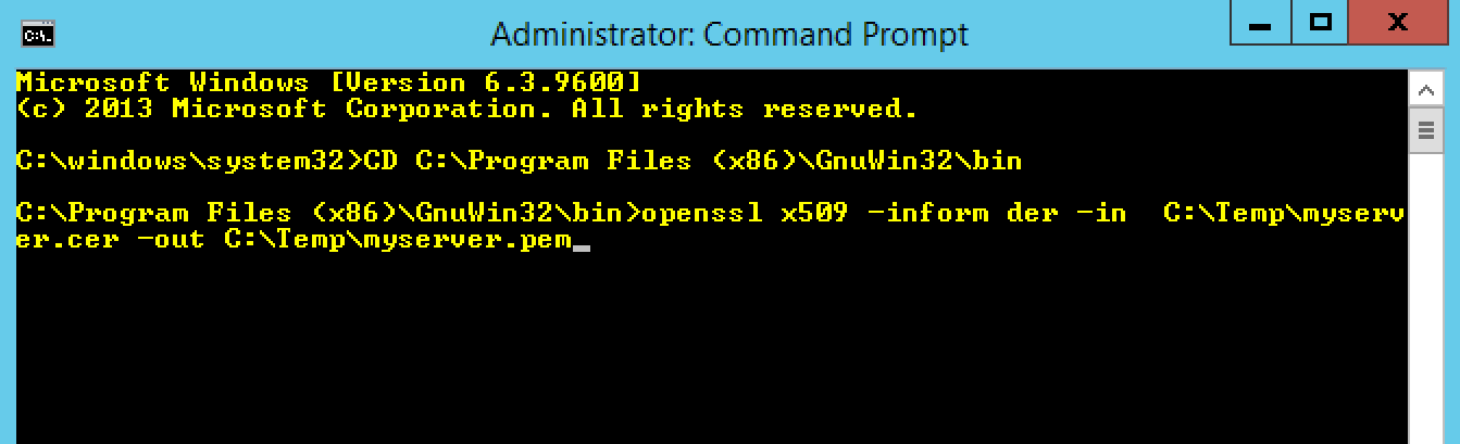

  3. The signed server certificate will most likely be returned to you in the form of a .cer file, and since we need it in .pem format we’ll need to run it through a conversion process using openssl. Once again open a command prompt as administrator, navigate to the install location of openssl (e.g. C:Program Files (x86)GnuWin32bin) and run the following command:
    • openssl x509 -inform der -in  C:Tempmyserver.cer -out C:Tempmyserver.pem

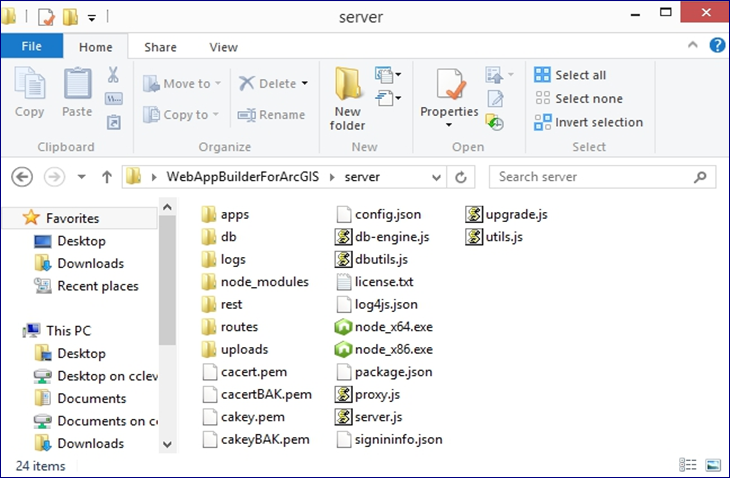

  5. Replace the cacert.pem and cakey.pem files in the the Web AppBuilder Developer Edition server directory install with the two files created above. The files need to have the exact same names as the ones you’re replacing so make the following changes:
    • The file created in step 3 (myserver.pem) will need to be renamed to cacert.pem, and the file created in step 1 (myserver.key) will need to be renamed cakey.pem.
    • Once renamed, place them in the Web AppBuilder Developer Edition server directory.
    Note:  Be sure to back up the self-signed certs prior to replacing them with the ones created just in case!
