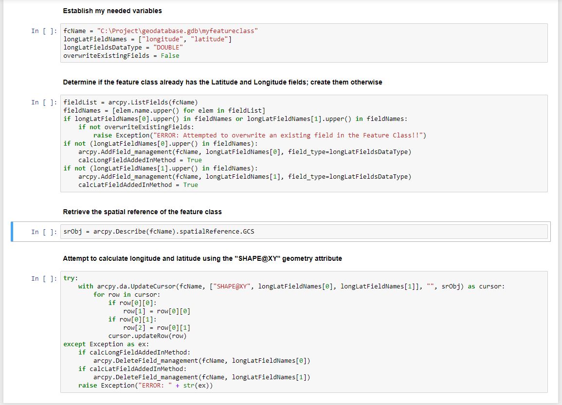

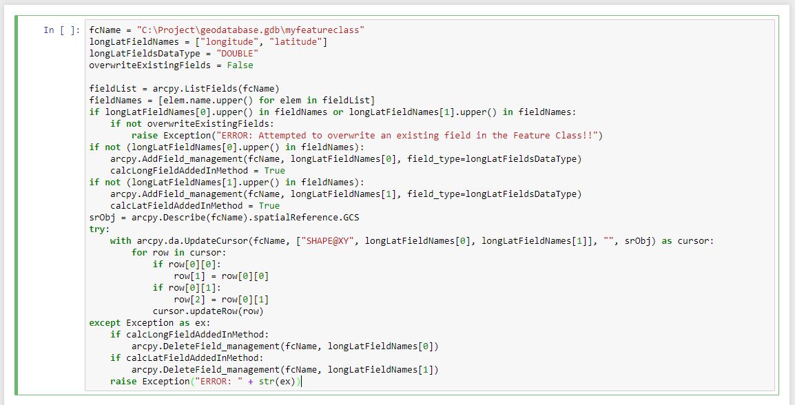

Here’s an example where a script calculates a longitude and latitude for every record in a table:
The entire script is place in a single cell. Yuck!
Doing this erodes many of the benefits that this tool provides!
Consider instead where your process contains logical breaks and create a cell for each component of your process. Not only is this more visually compelling and easier to understand but it allows you to test each step of your process independently without re-executing the entire script.
Here’s the same script from above, separated into individual code cells for each step of the process to calculate longitude and latitude:
Ah, much better.
Splitting the script into cells allows you to test each component and ensure every step is acting in the way you expect. Additionally, you can document each component with a markdown cell, which takes me to the next tip…

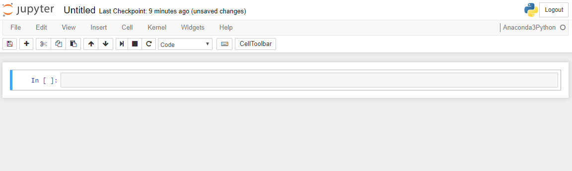

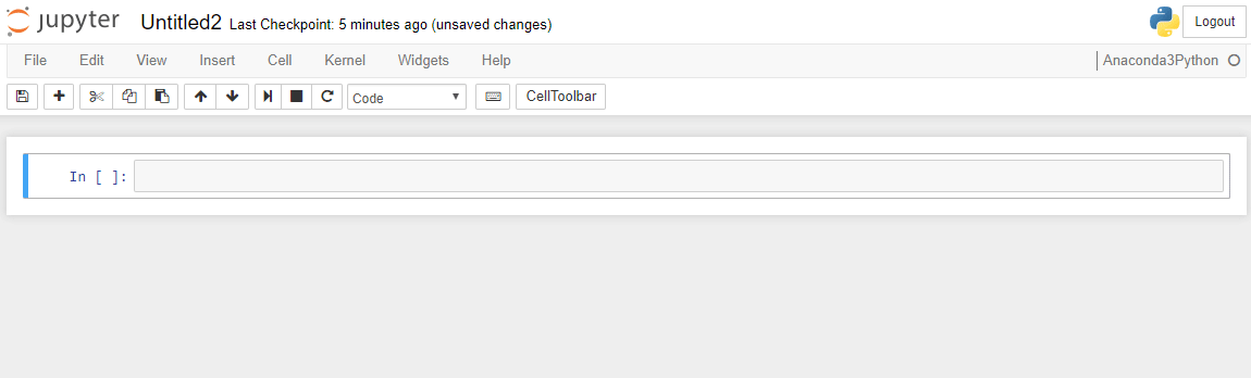

All cells start as “Code” cells by default, but take a moment to explore the different types of cells available to you:
You can designate cell types through the Jupyter Notebook toolbar
Markdown cells are an excellent way to document your scripted process.

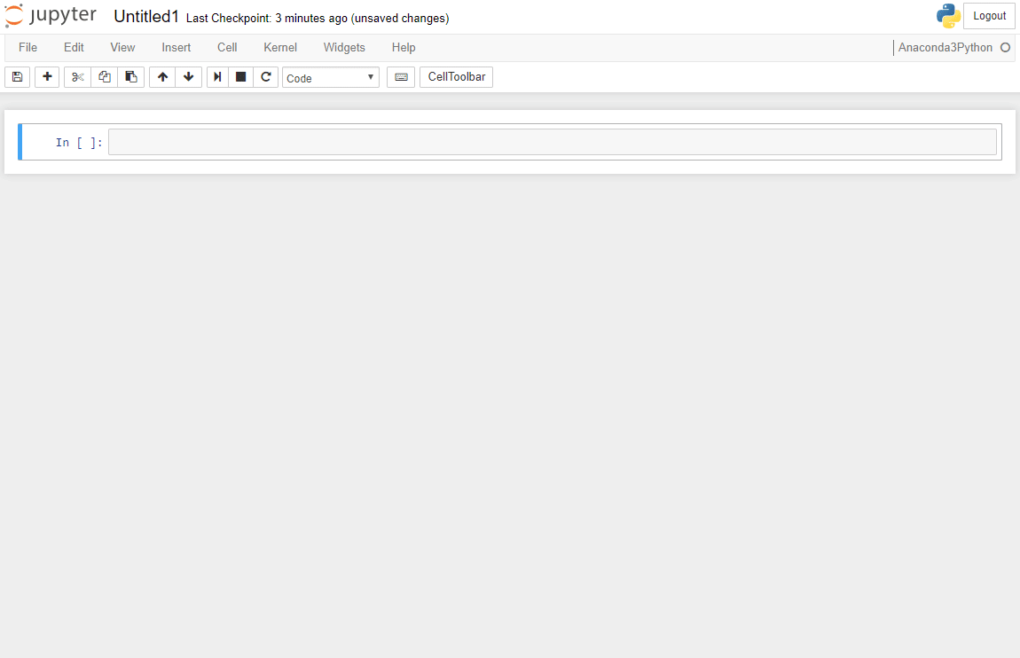

3. Executing Cells (shift + enter)
If you’ve taken steps to segment your code into separate cells, you may come across another mistake I did on my first notebooks: forgetting to execute all cells to run the entire process.
The following example highlights a common mistake I did in my first notebook:
Coming from using traditional Python IDEs where the code executes from start to end, I simply executed the cell that I finished writing, but forgot to execute the first cell which imports the ‘os’ module, triggering the error.
My advice:
Get used to pressing Shift + Enter when you are done writing a cell to execute it.
The Shift+Enter keyboard shortcut executes your cell and creates a new cell below to continue to your work. The smooth flow that it provides has resulted in this shortcut becoming my most frequently-used keyboard shortcut in the entire tool.

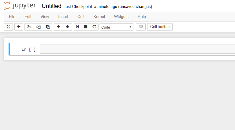

Another way to manually execute all cells in your notebook is the “Run All” command in the “Cell” tab of the toolbar:

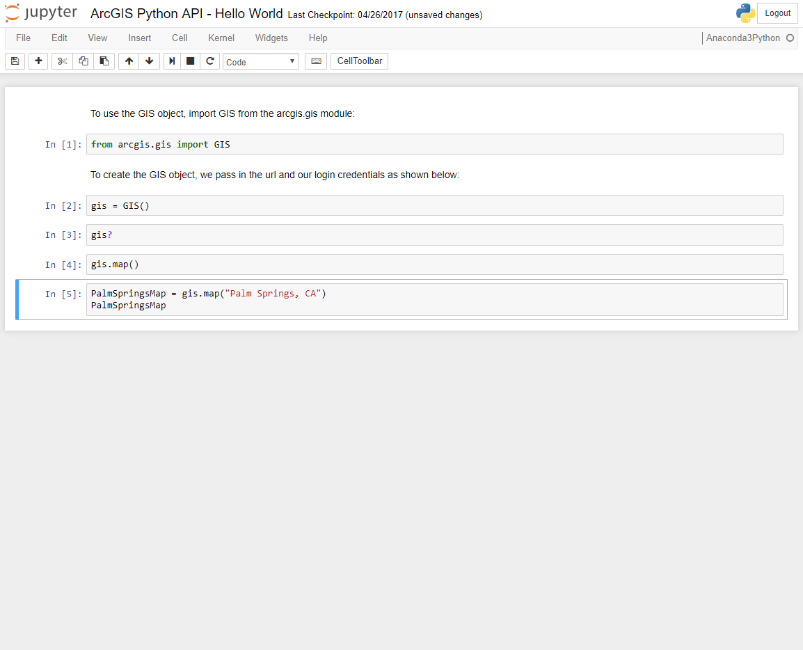

4. Explore Interactive Mapping Options!
Did you notice the map in the example above? That’s the ArcGIS API for Python in action!
I briefly mentioned some of its benefits in the previous post, but let’s take a few steps to start exploring it.

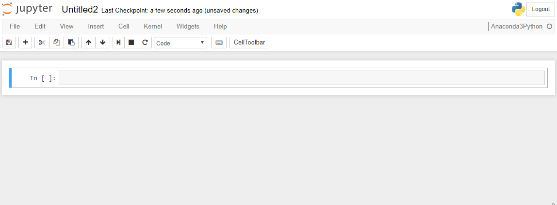

The “Hello World” equivalent in the ArcGIS API for Python is the following:
The documentation does an excellent job of getting you started, but you can also explore some of its capabilities from within your notebook. This takes me to my final tip…
