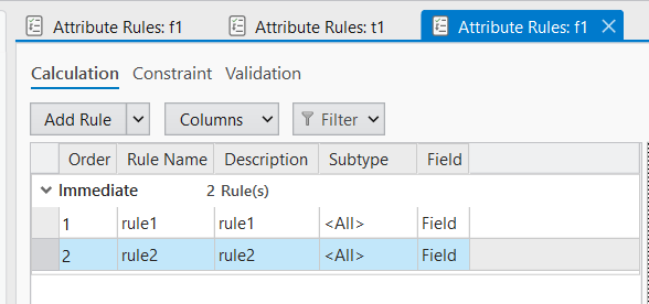

Attribute rules are part of the geodatabase schema, just like fields, subtypes, domains etc. This means when attempting to update an attribute rule in a table, you will need to make sure the table is not opened by other applications or services. Stopping all services and applications using that table will release any shared lock that has been acquired and allow attribute rules to be changed (by acquiring an exclusive lock). Locks are a common practice in the geodatabase to maintain the consistency and integrity of the data definition in the geodatabase model. Attribute rules can be updated from the grid view in ArcGIS Pro, GP tools, or Python.
The attribute rules grid view
