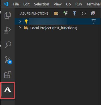

  1. Once VS Code and the appropriate extensions are installed, you should see a new Azure icon in the Activity bar. Select this icon and sign into your Azure account in the Azure: Functions area.
Azure icon outlined in red after installing the Azure Functions extension.

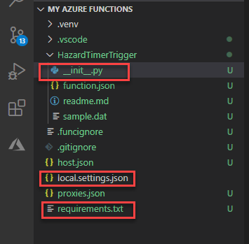

3. VS Code will automatically generate the required files including a template for your code. We will only be focusing on three files in particular.
Files generated when creating a new Azure Function. Three files are outlined in red.

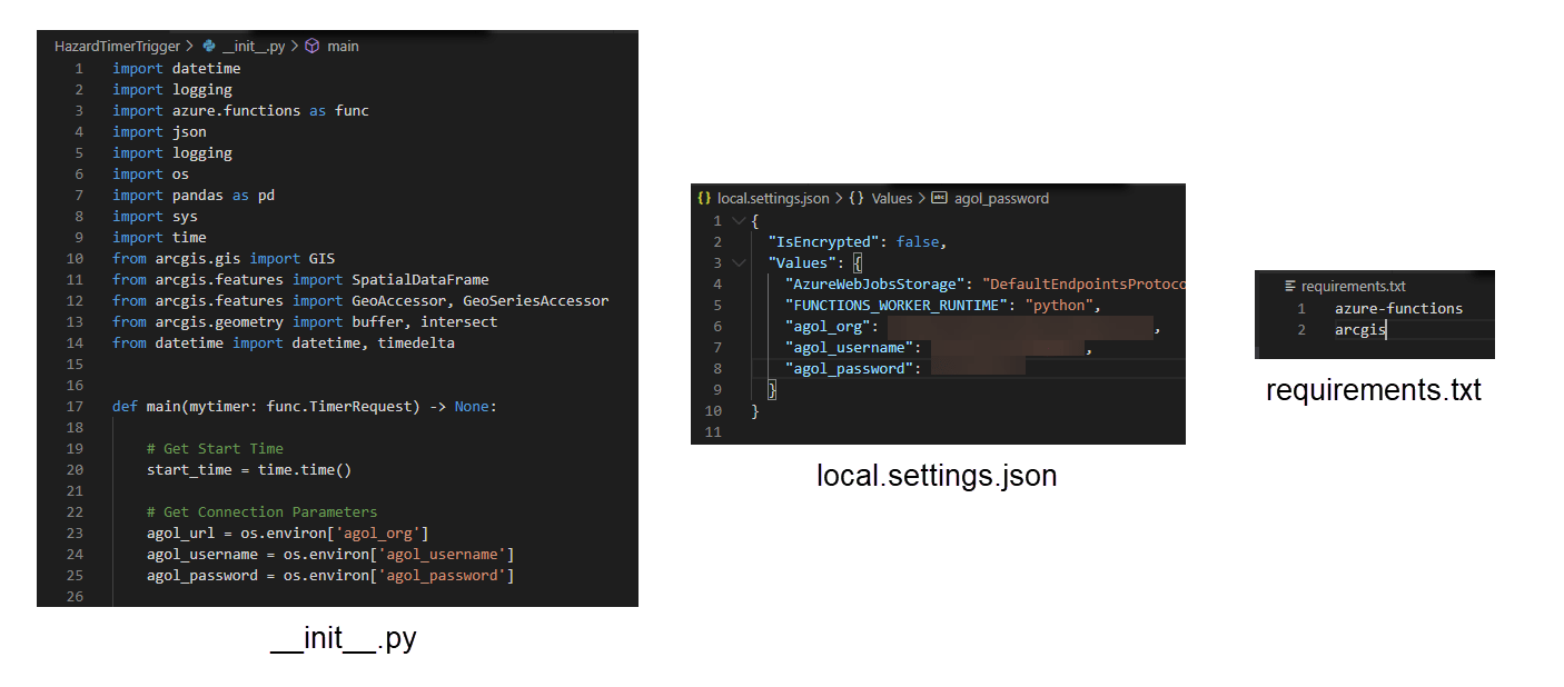

  • __init__.py is where the function code is placed. The hazard alert script will be copied in this location under the main function.
  • local.settings.json is essentially an application configuration file. This is where you will place credentials for authentication to ArcGIS Online (the values are being referenced via os.environ[‘key’] in the function code). It is only important for testing your script locally before publishing to Azure.
  • requirements.txt is used to specify the list of packages your script requires in order to run successfully. In order to use the ArcGIS API for Python, all you must do is enter the word arcgis.
Displays example code blocks of the three files.

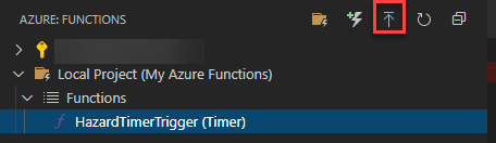

5. It is now time to publish your function to Azure. Select Deploy to Function App and follow the prompts to create the function and any other resources in your Azure account.
The Deploy to Function App button outlined in red.

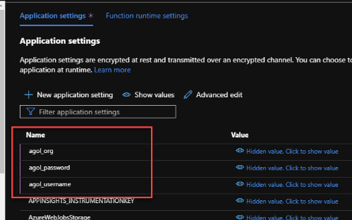

6. Once the resources have been created in your Azure account, we need to add authentication credentials for ArcGIS Online to the application configuration settings under the App Service in Azure.
  • Go to the Resource Group that was created and select your App Service
  • On the left-hand side under Settings, select Configuration
  • We will add three new application settings (key/value pairs) for our organization, username, and password following the same pattern as we did locally.
  • Click Save (this will restart your service)
The three application settings (outlined in red) added to the function in Azure.

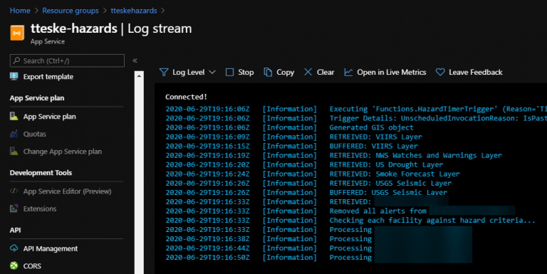

7. Verify the service is working
  • On the left-hand side of your selected App Service, navigate to Log stream under Monitoring. This is where you can view the logs as the service is running.
Example output of the Log stream when successfully running the function.

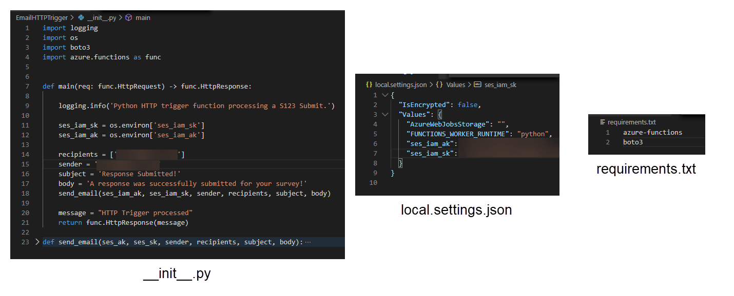

1. In VS Code, select Create Function, and proceed through all the steps as you did for the Timer Trigger, except select HTTP Trigger as your project’s template. VS Code will automatically generate the required files including a template for your code. Again, we will only focus on the same three files as we did above.
  • __init__.py is where the email script will be copied under the main function.
  • local.settings.json is where you will store credentials for the email script.
  • requirements.txt is where the boto3 library will be called.

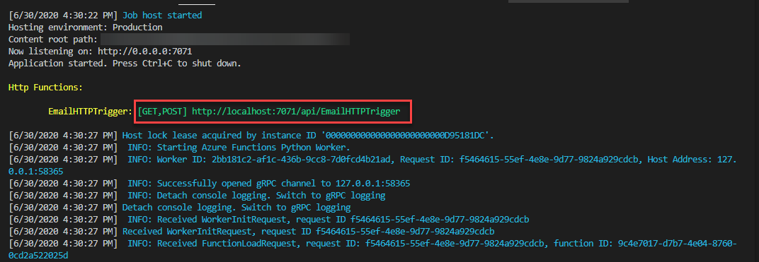

2. Next, let’s simulate the test locally following the same steps as above, except this time you will see a URL endpoint of your HTTP trigger in the Terminal. Navigate to the URL provided in the console to execute a GET request.
URL endpoint outlined in red in the console when running the function locally.
The URL endpoint copied into the browser to simulate the webhook.

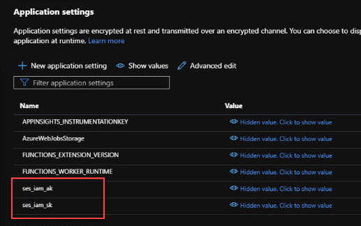

4. After the service has been deployed, navigate to the application configuration for the service and add our authentication credentials.
The two application settings (outlined in red) added to the function in Azure.

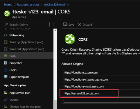

5. Next, we must add the Survey123 website as an allowed origin for our service. This will ensure that only requests coming from https://survey123.arcgis.com will initiate the callback. In the left-hand side of the app service, select CORS under API and add the URL.
The Survey123 CORS entry outlined in red in Azure.

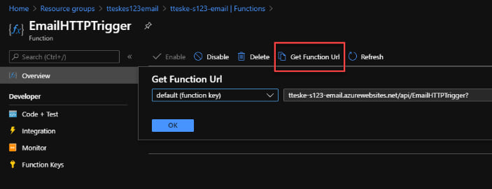

  • In Azure, navigate to the Function tab under the Functions section for your service and select your function. You should be routed to an overview page for the selected function. On this page, select Get Function URL and copy the URL to your clipboard.
The Get Function URL outlined in red in Azure.

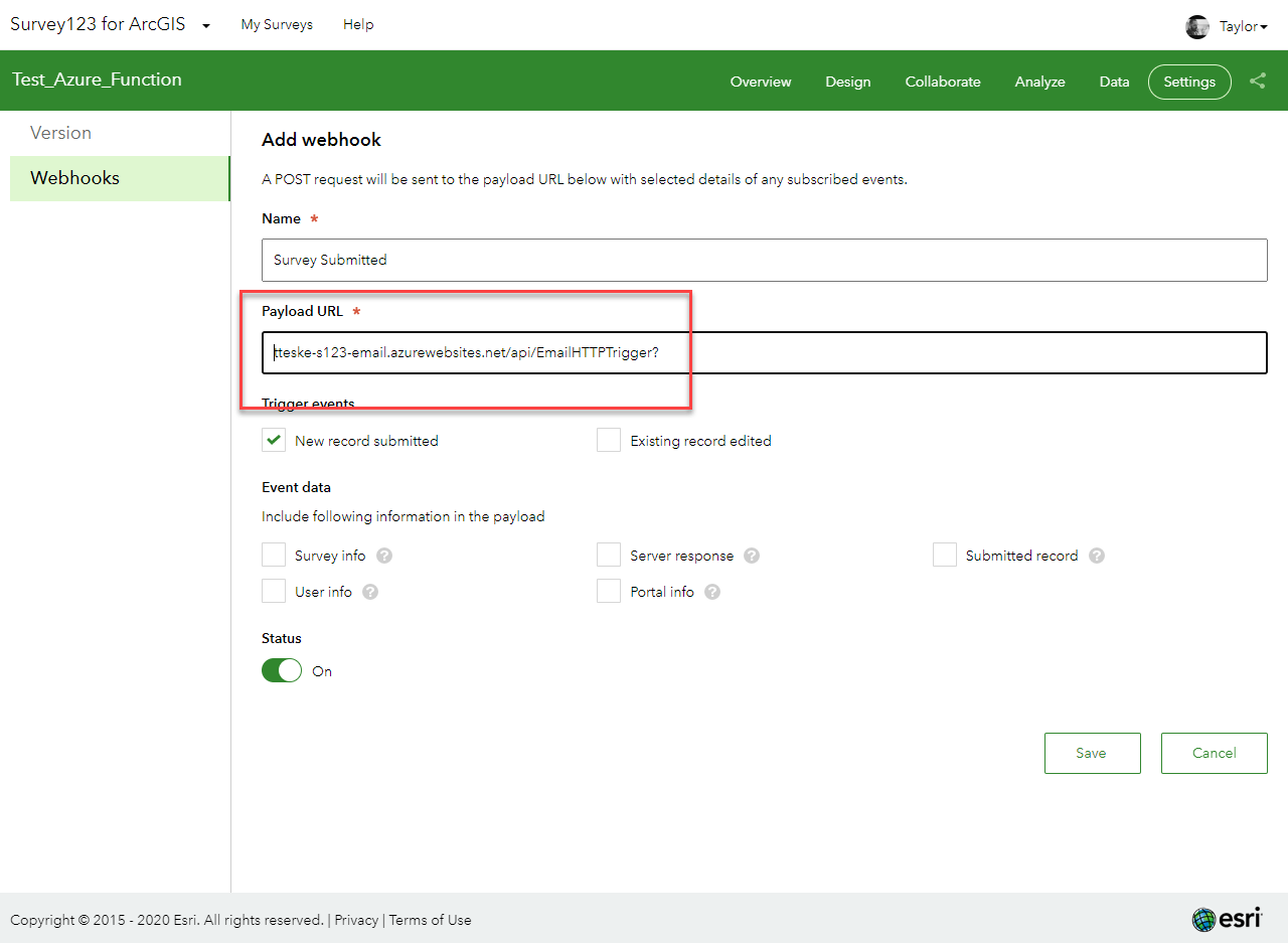

  • Select your published survey, go to the Settings tab, and select Add Webhook.
  • Provide a Name for the webhook and paste the URL you copied into the Payload URL.
  • Select Save.
The Payload URL section outlined in red in the Survey123 Web Application

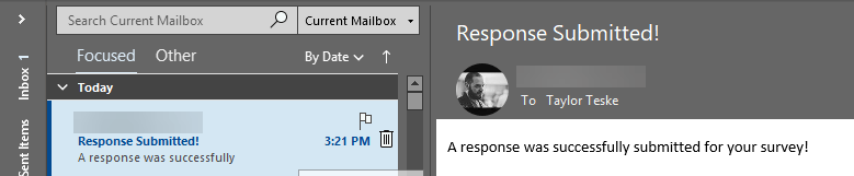

7. If everything was successfully configured, you should now receive an email notification when a survey is completed! You can also verify the trigger was successful by viewing the Log stream, like we did above for the Timer Trigger.
The email notification after a survey has been completed.
