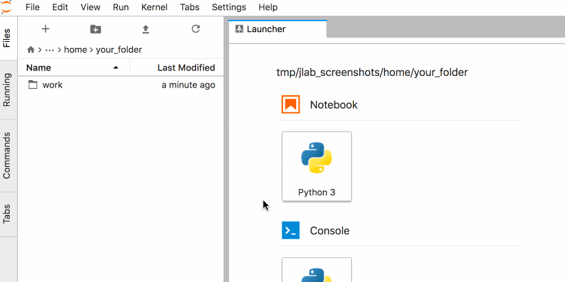

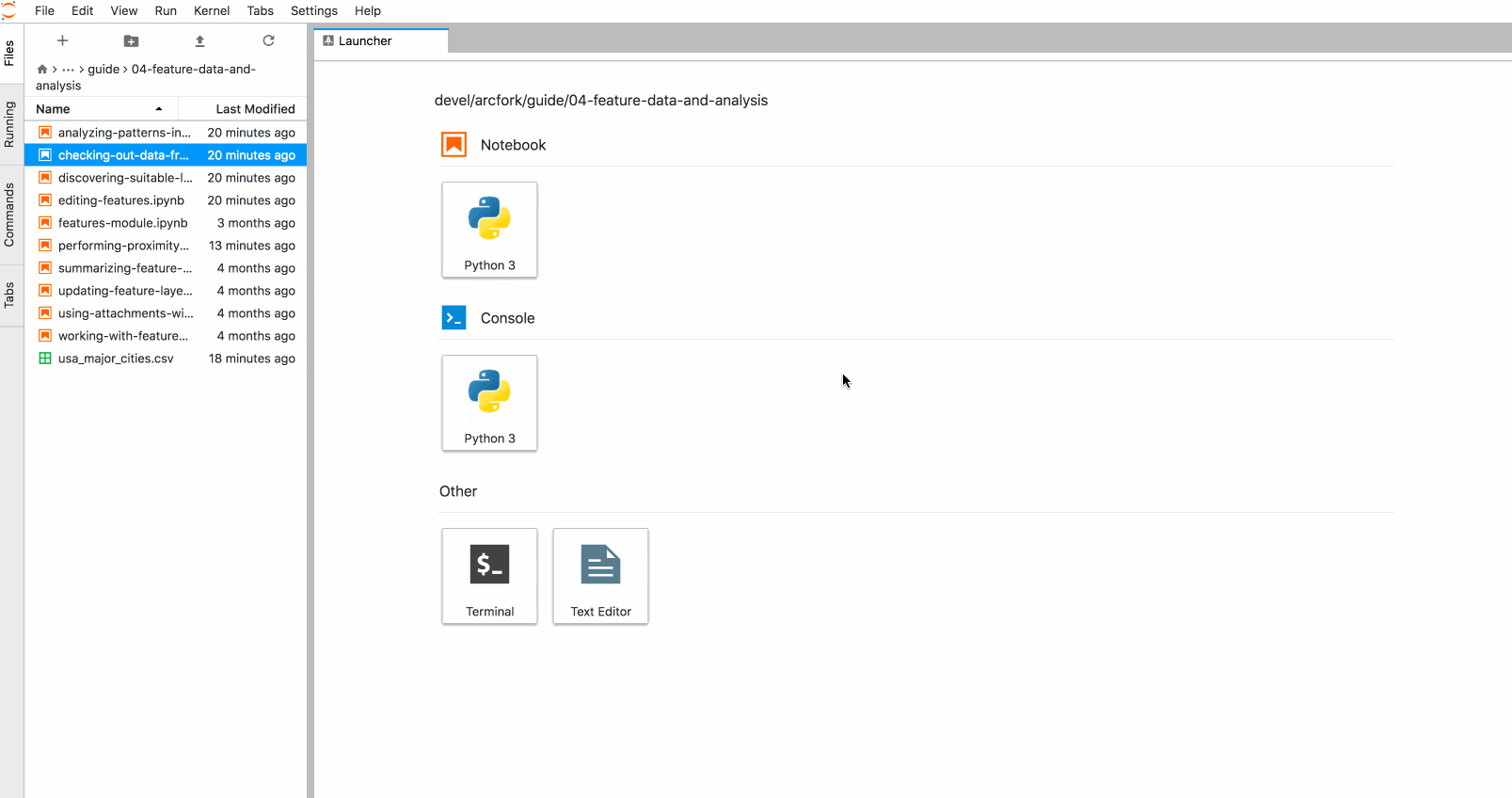

After running jupyter lab, you will notice a file explorer on the left pane of the main view. You can navigate through your filesystem for Jupyter Notebook files (.ipynb), JSON files (.json), CSV files (.csv), etc. You can also create new Jupyter Notebooks.
You may noticed that a notebook opened from the file explorer will appear in a new window or a new tab. JupyterLab can manage these windows powerfully: you can place notebooks side by side, resize windows, and organize notebooks by tabs by simply clicking and dragging.

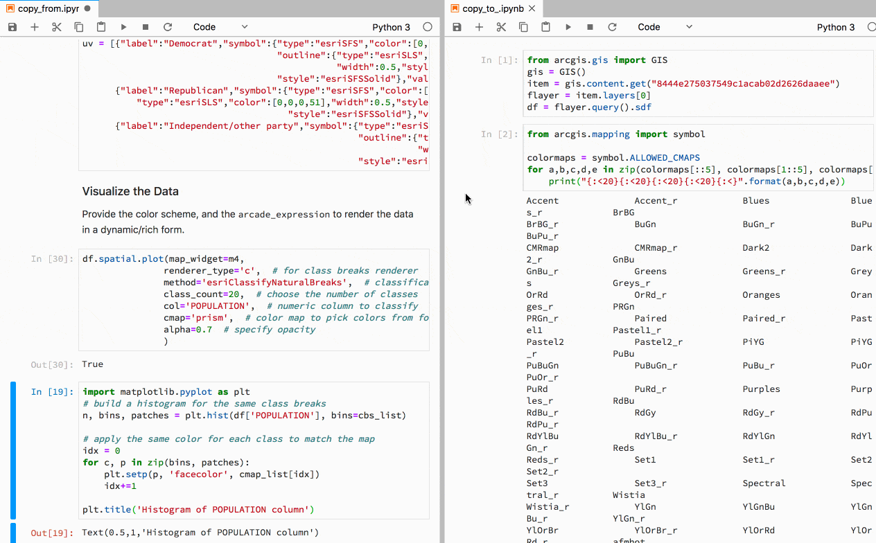

Similar to the windows, JupyterLab allows users to move cells in a notebook by dragging and dropping them. JupyterLab supports dragging cells in the same notebook, as well as dragging cells from one notebook to another notebook. Open a sample notebook in JupyterLab, click the area to the left of a code cell, and drag it around.
JupyterLab offers some additional code cell features, such as
- Selecting multiple cells by holding the Shift key
- The right click context menu for ‘Copy Cells’, ‘Cut Cells’, etc.
- The right click context menu for ‘Create New View For Output’. This context menu option will take any cell output and duplicate it in a new window, allowing you to stack it, split it, etc.
