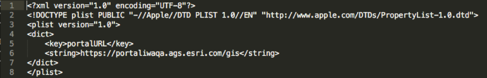

  3. To create the PLIST file, create a text file with the following text (see picture below). Replace the value in the portalURL key (<string>value</string>) with your organizations portal url. Save this file as a “.plist file (ie explorerAppConfig.plist).

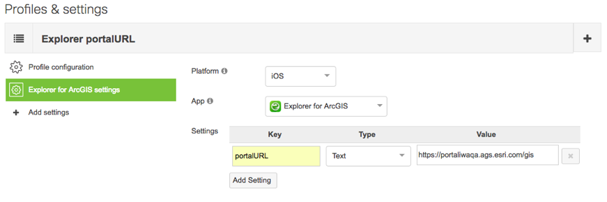

Here is how it works with Cisco Meraki, the following steps can be used to push the Portal URL:
  1. On Systems Manager, go to Apps > Add New > iOS app > Add App (Enter “Explorer for ArcGIS”) > Add.
  2. Within the Systems Manager, go to Settings > Add  > New Meraki managed profile > Create New Profile > Add settings > Choose an app / Settings (see picture below) > Add Setting.
