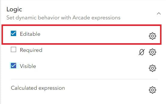

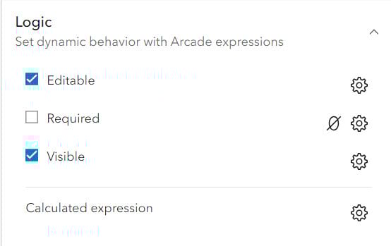

Logic section of Properties pane

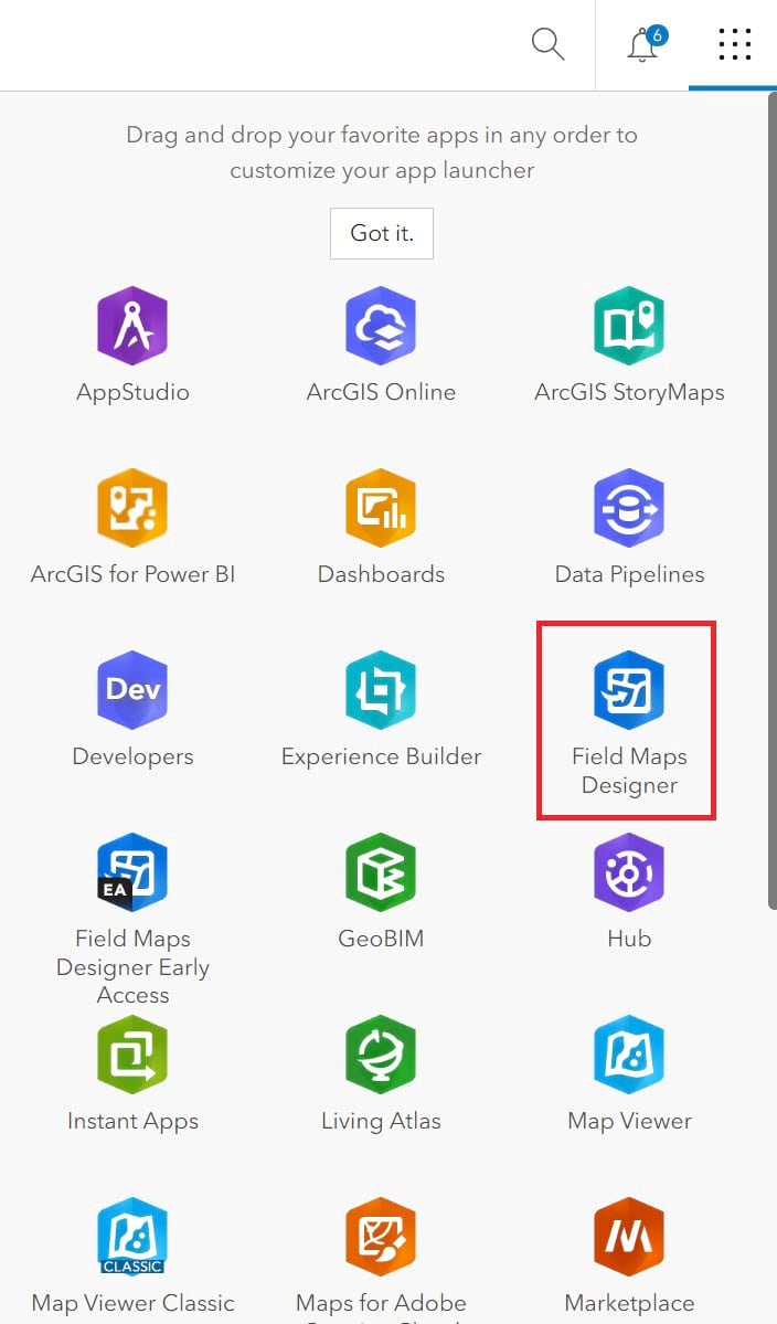

In Field Maps Designer, once you have either added your fields to the form manually or convert your pop-up into a form, select one of your fields and the Properties pane will open on the right side of the screen. The upper portion of the pane focuses on formatting the field with elements like display name, input type, and placeholder. The lower portion of the pane is where you will find the logic section, where you can add your Arcade expressions. For more information on how to set up your fields in Field Maps Designer, check out the Get started with Field Maps Designer tutorial. Open Field Maps Designer using the app launcher in the upper right corner of ArcGIS Online or ArcGIS Enterprise.
App launcher apps with Field Maps Designer highlighted

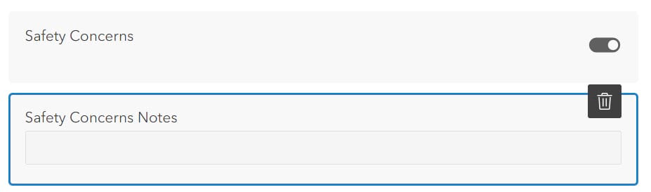

The example below shows two fields from a trail inspection form. The first is Safety Concerns, which is a switch. The second is Safety Concerns Notes. Using Arcade, the following only shows the Safety Concerns Notes field when the Safety Concerns field is equal to yes.
Safety Concerns fields from form

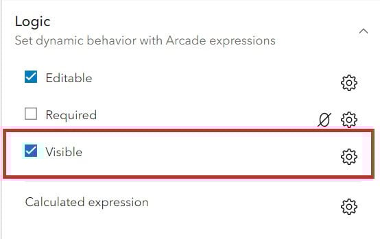

Since this is a fairly simple expression, you can use the Arcade Expression builder window or the Arcade editor; it’s a matter of preference. This example shows both cases. First, select the Safety Concerns Notes field. When it’s selected, it will show a blue rectangle around the field. Next, click the settings button next to the Visible logic option in the Logic section and click New expression.
Logic section of Properties pane with Visible logic highlighted

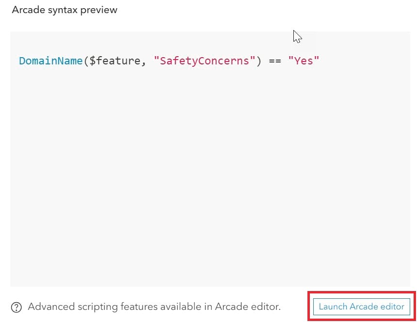

You’ll notice that in addition to the Expression builder window showing the conditions in drop-down menus, it also gives you a preview of the Arcade syntax. You can add conditions in the Expression builder window using either the AND or OR option. You don’t need any additional conditions in this case. If you do use additional conditions for an expression, there is one limitation you should know: You can only select one or the other for all the additional conditions. If you select AND, all of the conditions will need to be true for the expression to run. If you select OR, if any of the conditions are true the expression will run.
For more complex expressions or if you want to practice your Arcade skills, you can launch the Arcade editor. Below the Arcade syntax preview pane is the Launch Arcade editor button.
Safety concerns expression in Arcade syntax preview pane

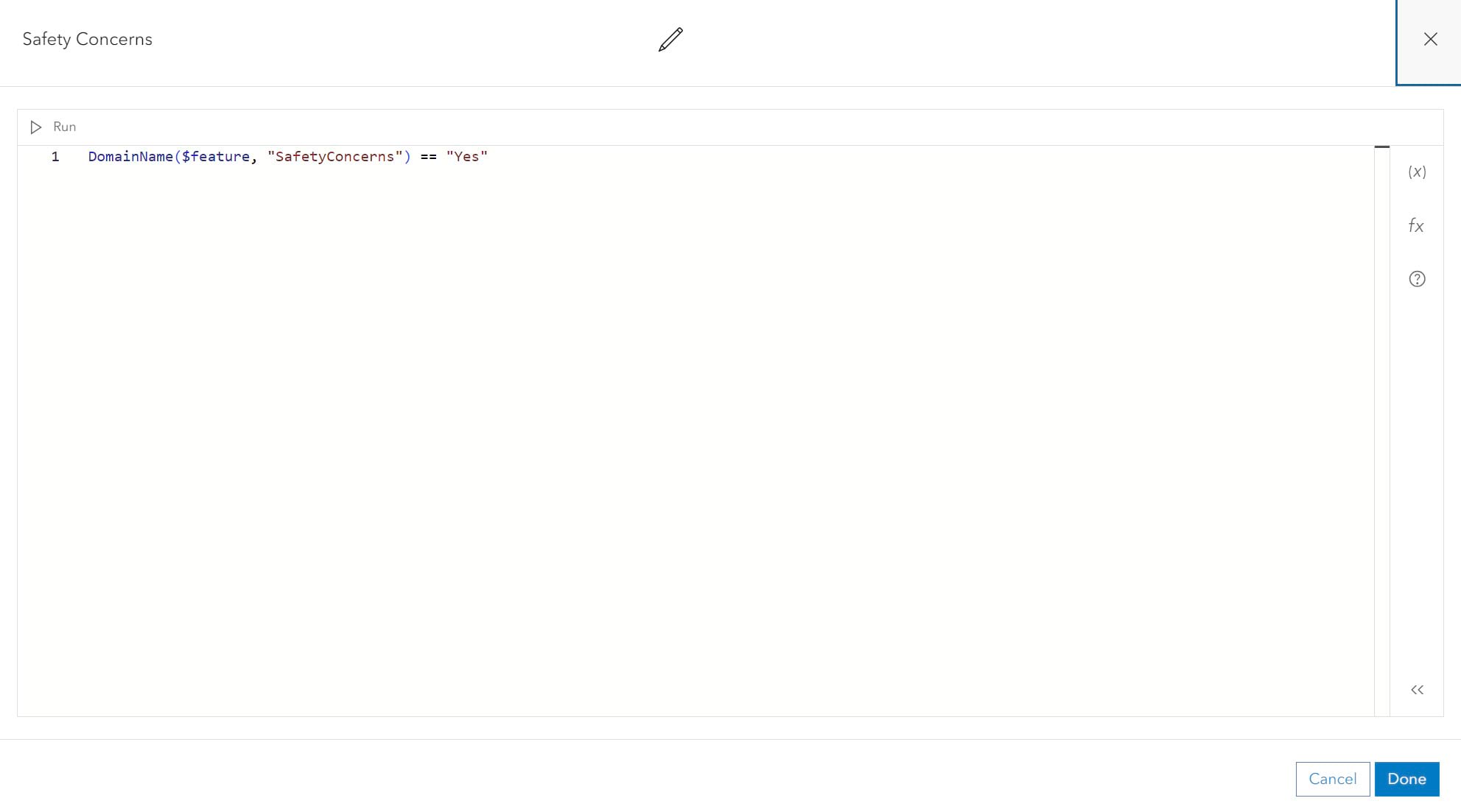

If you have already created an expression in the Expression builder window, it will show in the Arcade editor. Otherwise, it will be blank.
Safety concerns expression in Arcade editor

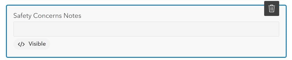

Now that the Arcade expression is complete, click the Done button in the lower left corner. Back in the form builder, the Safety Concerns Notes field now has a new label showing that it has visibility logic. And the field will remain hidden in the form unless the Safety Concerns field is equal to Yes. The last step in the process is to click the Save button in the upper right corner of the form to save your changes.
Safety concerns notes field with visible label

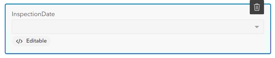

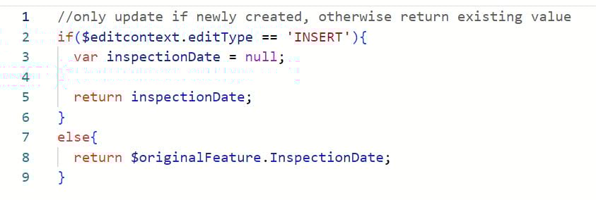

Using Arcade on the Inspection Date field in the form, the field will be editable when adding a new inspection record and will show as read only with the existing date if the record is edited in the future. First, select the Inspection Date field. Next, click the settings button next to the Editable logic option in the Logic section and click New expression. This time, you will launch the Arcade editor to create an expression.
Logic section of Properties pane with editable logic highlighted
This Arcade expression is more complex, so you can add a comment at the top. Adding comments to your expressions can help if you need to reuse or edit them later. You can add a comment by typing // in front of a line of text. For example, comments can describe what the expression does as a whole, or for a larger expression, comments for each section can give context on what that part of the expression will do.
Arcade expression for inspection date
You added the expression to the Arcade editor, gave it a title, and clicked Done. Now the Inspection Date field has an Editable label, which tells you that there is editable logic on that field. Click the Save button again to save the changes to the form.
Inspection Date field with editable label

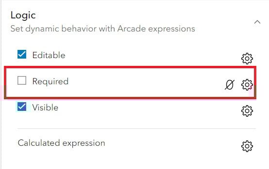

Required logic allows you to set a field to be conditionally required. If a field is required, it must be filled in before the form can be submitted. But what if that field isn’t always necessary? You could set the field to Required and users would need to fill in something in order to submit the form. Or if you don’t set the field to Required, someone may forget to fill out that field and then you end up with a hole in your data. That’s where Arcade comes in, to help make sure you don’t have any holes in your data.
Logic section of Properties pane with required logic highlighted

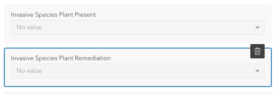

In the form, use required logic on the invasive species fields. If Invasive Species Plant Present is set to Yes, the Invasive Species Plant Remediation field will be required.
Invasive species plant fields from form

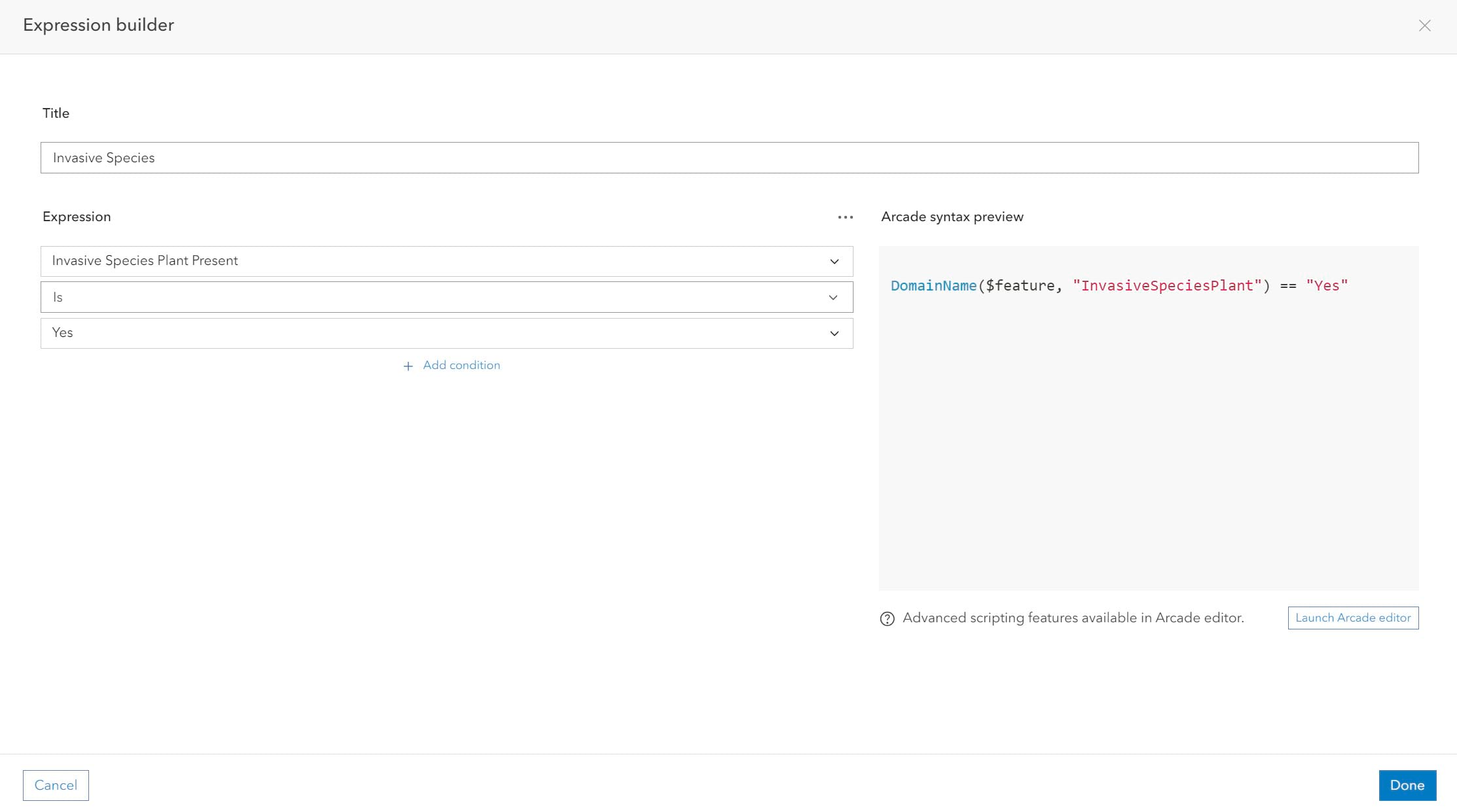

Since this is a short expression, use the Expression builder window to create an expression. Then title it and create the expression that Invasive Species Plant Present is Yes and click Done.
Arcade Expression builder window with invasive species expression

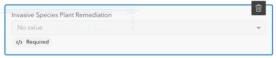

The field now has a required logic label on it. Save the form again, so you don’t lose the changes.
Invasive Species Plant Remediation field with required label

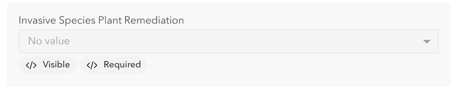

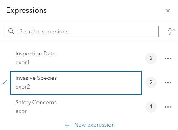

In the case of the Invasive Species Plant Remediation field, you could also use the Visible logic option on that field. The field will only show when there are invasive species present and it will be required. You can use more than one type of logic on a field at the same time. This time instead of creating a new expression, use an existing expression. Click the settings button next to Visible and click the Invasive Species expression you just wrote. A check mark will appear to the left of the expression name, and you will see the number 2 now in the gray circle. That means that you are using that expression twice in the form.
Existing expression list with checked Invasive Species expression
Now looking at the field again, it has a label for visible and required. Save your work.
Invasive Species Plant Remediation field with required and visible labels

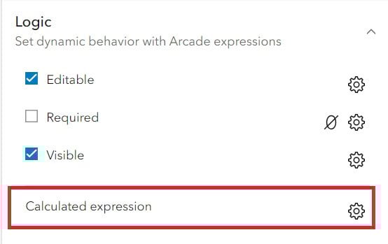

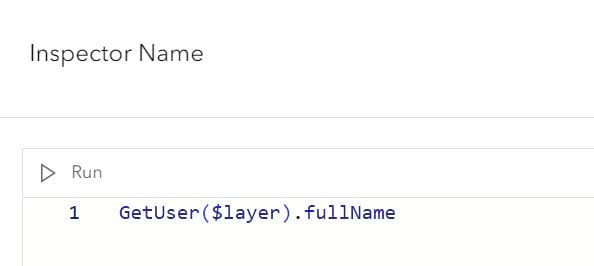

Lastly, you will use calculated expressions. Calculated expressions will calculate the value of the field, and in the process, the field will be made read-only. In this example, use the GetUser function to populate the Inspector field with the inspector’s full name. Start by clicking the settings button next to Calculated expression and create an expression.
Logic section of Properties pane with calculated expression highlighted
Unlike the previous examples, there is no expression builder for the calculated expressions. It will open the Arcade editor automatically. Give the expression a name and then add the expression to the Expression window and click Done. Once the form opens again, save the changes.
Arcade expression for GetUser function

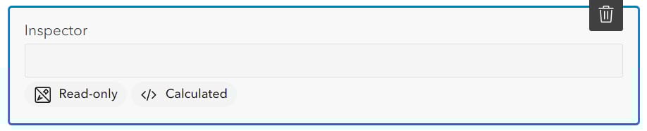

In this expression, the GetUser function is using properties from your portal or server and pulls the full name of the user. When a new record is added, the inspector’s name will be filled out automatically. Using the GetUser function, you can also populate other information such as user ID, username, email, and more.
After adding the calculated expression, you now have two labels for the Inspector field: Read-only and Calculated.
