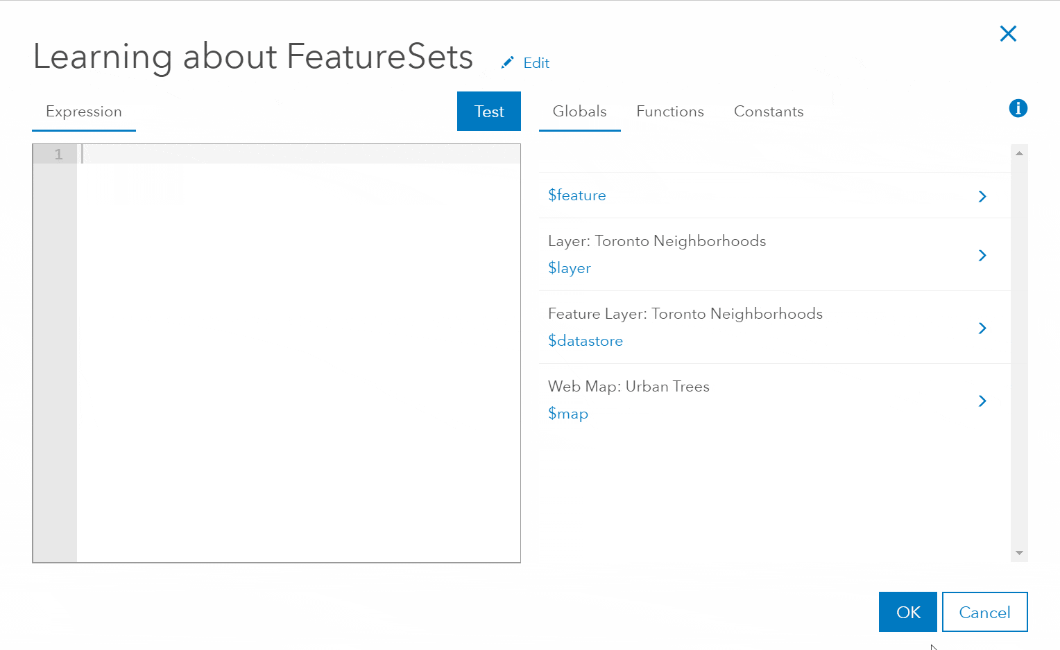

Crack open the Arcade editor for the Neighborhoods layer by configuring the pop-up and adding a new expression, give the expression the name “Number of Trees”, paste in the following code, and then click Test.

The expression above tells you how many trees are in the neighborhood when you open the pop-up. First it defines a FeatureSet called trees using the name of the layer in the web map ($map). On the next line, we define a variable that stores the number of trees that intersect the polygon ($feature). Arcade allows you to chain functions together for convenience. The last line returns the count value to be used in the pop-up. Properly referencing the layer for a FeatureSet can be tricky to type out by hand. The good news is you don’t have to; you can browse to the layer from the Globals tab and just insert the snippet.
		You’ll notice in the video above that there are two ways to define a FeatureSet: by Name or by Id. Both are identical in functionality, and how you refer to the layer is up to you. If you expect your layer’s name to change, then I would recommend using the Id instead.
