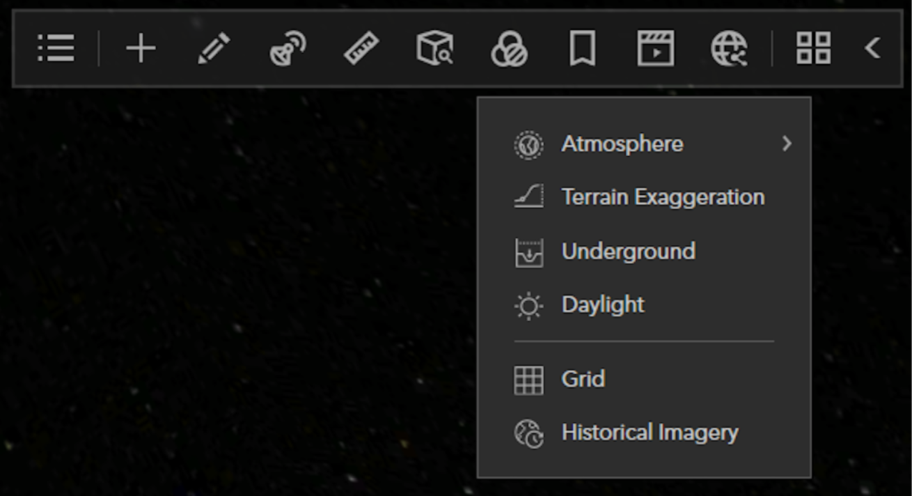

How to access the Historical Imagery Explorer
You will find the  Historical Imagery Explorer under  3D Effects in the main toolbar. The Historical Imagery Explorer is only supported when the spatial reference is set to Web Mercator. If the current scene is set to WGS84 the Historical Imagery Explorer will be unavailable.
ArcGIS Earth interface showing a settings menu with options: Atmosphere, Terrain Exaggeration, Underground, Daylight, Grid, and Historical Imagery.
Tip: For quick access, pin the Historical Imagery Explorer to your custom toolbar in Settings.

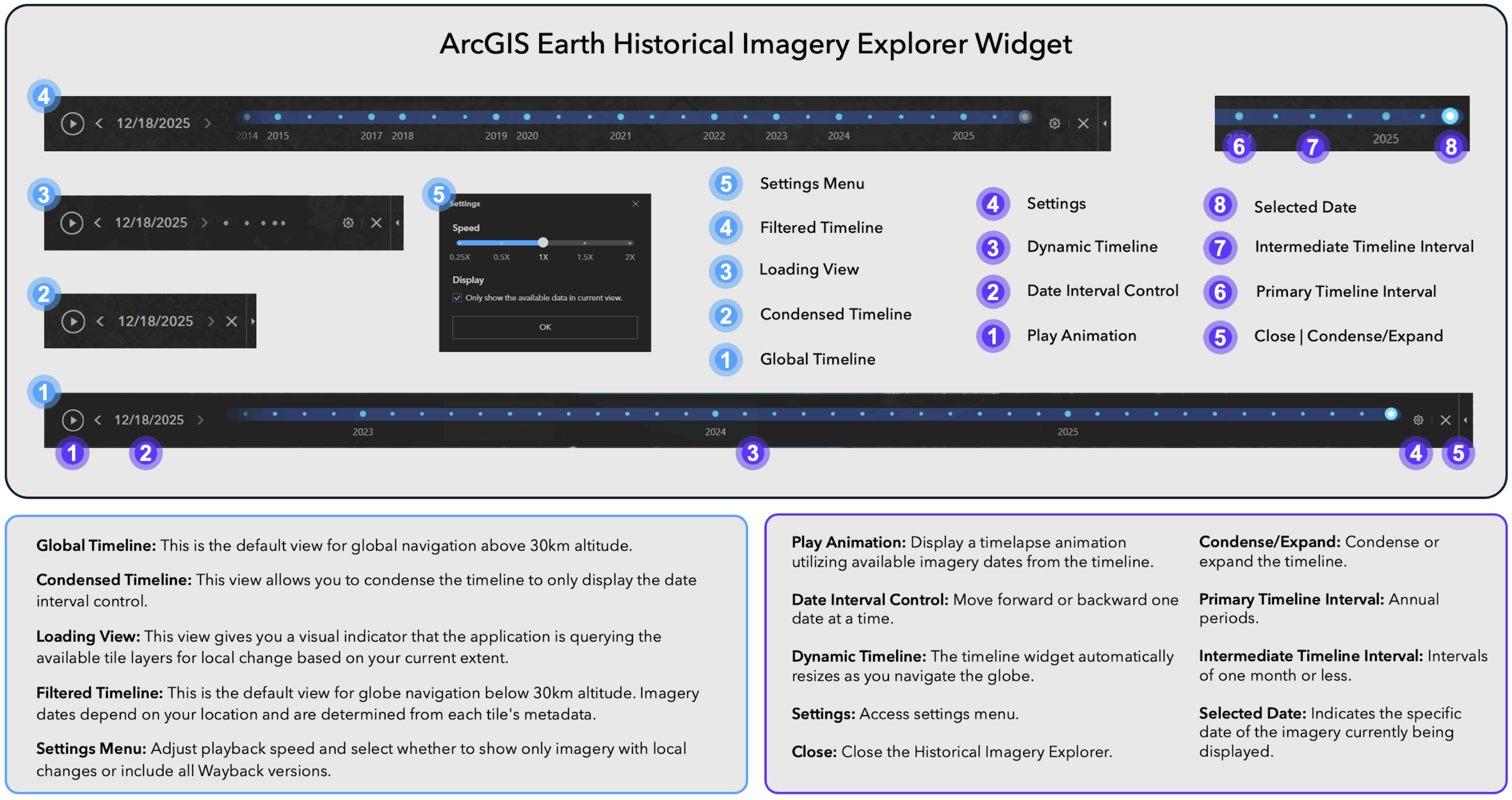

Historical Imagery Explorer Interactive Timeline Widget
The Historical Imagery Explorer utilizes a dynamic timeline widget to simplify the identification of available imagery and enable efficient navigation across different dates.
See the diagram below for an overview of the user interface elements:
ArcGIS Earth Historical Imagery Explorer widget interface showing timeline controls and settings. Various element of the widget are labeled to note features and functionality like the play button and filtered timelines
The Historical Imagery Explorer widget makes it easy to identify available imagery and navigate dates in ArcGIS Earth. Click the image to view it full screen.

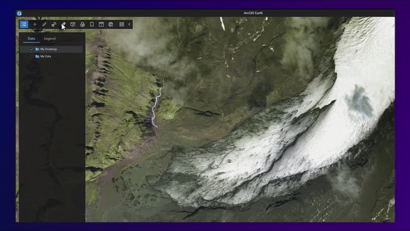

Measure Glacier Retreat (Solheimajokull Glacier, Iceland)
The Solheimajokull Glacier in Iceland has experienced a retreat of several hundred meters in recent decades, serving as a clear example of the rapid impacts of climate change. With ArcGIS Earth’s Historical Imagery Explorer and line measurement tool, we can track changes in terminus position over time.
Visualizing Solheimajokull Glacier’s rapid retreat using ArcGIS Earth Historical Imagery.

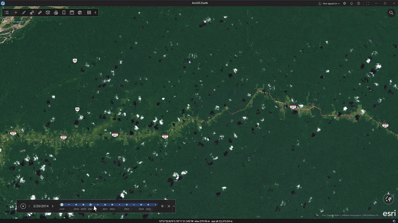

Monitor Deforestation and Illegal Mining Activity (Madre de Dios, Peru)
Since the 1980s, Madre de Dios has experienced a loss of over 130,000 hectares due to illegal gold mining. This activity has resulted in the destruction of pristine Amazon rainforest, mercury contamination of rivers, and significant threats to biodiversity hotspots. Using the Historical Imagery Explorer, you can clearly see the rapid growth of man-made gold mining plunge pools in the region.

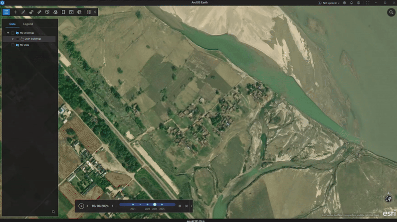

Track Flood Impact Over Time (Khagaria/Bihar, India)
Bihar is India’s most flood-prone state, where seasonal floods often damage farms, uproot communities, and destroy infrastructure worth billions. Using ArcGIS Earth’s Drawing tools, combined with the Historical Imagery Explorer, you can collect buildings affected by flooding and save the layer as a KML/KMZ.
Click video to expand

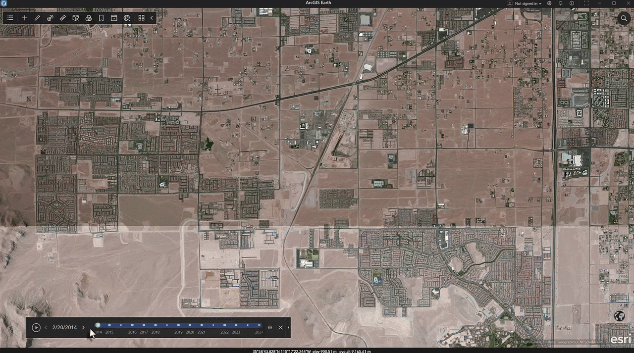

Visualizing Urban Sprawl (Las Vegas, NV)
Las Vegas ranks among the fastest growing metropolitan regions globally. The expansion into desert areas alters the arid landscape and places significant pressure on available water resources. ArcGIS Earth’s Historical Imagery Explorer enables users to measure impervious surface area, monitor desert encroachment, and evaluate patterns of development within this water-limited environment.

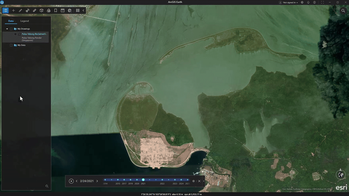

Land Reclamation (Pulau Tekong, Indonesia)
Pulau Tekong has seen major land reclamation efforts, using engineered fill to enlarge its coastal areas. These projects convert marine environments into land suited for infrastructure, military, or commercial use, causing significant changes to coastlines and marine ecosystems in Southeast Asia’s fast-growing regions. With ArcGIS Earth’s Historical Imagery Explorer you can create evidence of the pace and scale of engineered coastal changes, so that decision-makers can make informed decisions.

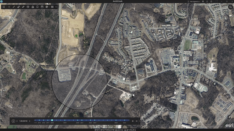

Monitor Construction Projects (Courthouse Rd – Stafford, VA)
Stafford County’s Courthouse Road diverging diamond interchange uses an innovative design to ease congestion and boost safety. The intersection shifts traffic temporarily to the opposite side and demands careful planning for smooth construction. ArcGIS Earth’s Historical Imagery Explorer lets you quickly see images of the area before, during, and after construction.
