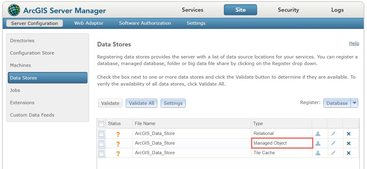

Checking for the object store
To check to see if your hosting server has an object store registered, sign in to ArcGIS Server Manager for the hosting server and click Site > Data Stores. If an entry shows Managed Object for the type, then your deployment has it.
The object store as it appears in ArcGIS Server Manager
A data store type listed as a Managed Object is the object store.
You can verify that the hosting server and the object store can communicate with one another by checking the box next to that data store entry and clicking Validate. If all is well, a green check mark appears in the Status column.
The file name for the object store identifies the type of object store. If the file name for the Managed Object entry shows ArcGIS_Data_Store, the deployment uses the ArcGIS Data Store. If any other file name is listed, it is using a cloud object store. Again, using a cloud object store is only recommended for deployments running in the cloud.
If the hosting server has no managed object store registered, use the information and links shared in the previous sections to add one.

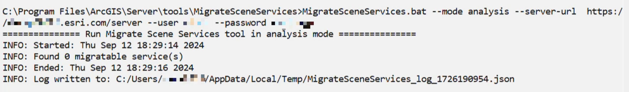

Identify the scene services eligible for migration
It is easy to determine which scene services have their caches stored in the tile cache data store. This is thanks to the new MigrateSceneServices utility, which is included as part of ArcGIS Enterprise 11.4 and 11.5 releases. This utility, which comes installed with ArcGIS Server, has two modes: analysis mode and execution mode.
When run in analysis mode, the utility provides a list of all services that are eligible for migration. It lists details about all hosted scene services that have caches in the tile cache data store. These details include the service name and the estimated size of each cache in megabytes. The size estimate helps you ensure that you have ample disk space and memory on the object store machine if you’re using the ArcGIS Data Store object store. (If you use a cloud object store, such as Amazon S3 or Azure Blob Storage, disk space isn’t a concern.)
Knowing the cache sizes also helps you decide when to run the migration and whether to migrate certain services separately. For example, if all the caches are gigabytes in size, migrate them when the system is not under heavy load. If you have a few caches that are terabytes in size, migrate those separately, perhaps outside of normal business hours.
When caches are migrated, you may see a spike in CPU on the machines running the tile cache data store and object store. Because of this, we recommend you perform the migration outside of business hours to minimize resource contention-related issues. This is especially important if you have caches that are extremely large.
The following is a screenshot of running the MigrateSceneServices utility in analysis mode:
MigrateSceneService utility run at command prompt
Run the utility in analysis mode to understand what scene services, if any, need to be migrated.

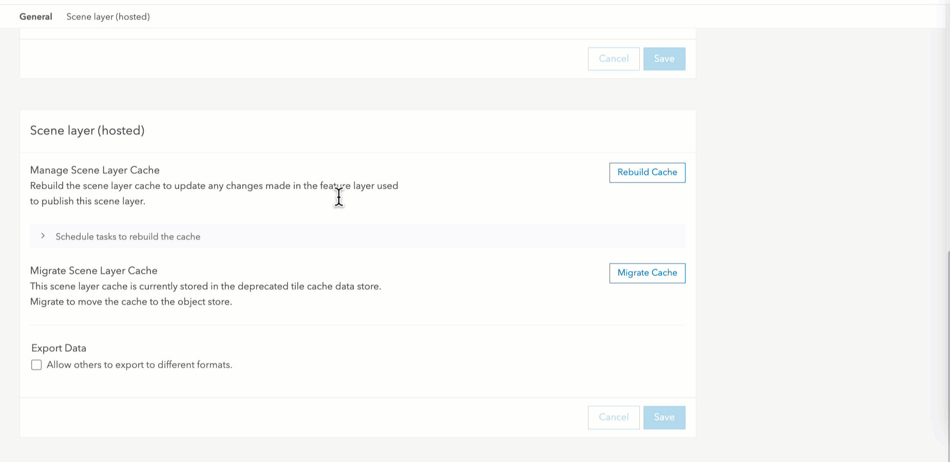

Migrate caches for individual layers from the Enterprise portal
Alternatively, you can migrate caches by initiating the migration from the Settings tab of the hosted scene layer’s item page in the Enterprise portal. Migrating caches from the item page is a good approach if you do not have many services to migrate.
The option to migrate the cache is present on the item’s Settings tab if both of the following are true:
  • You sign in to the Enterprise portal as the owner of the hosted feature layer.
  • The hosted scene layer’s cache has not been migrated yet.
If the option to migrate the cache is not shown, verify you are the item owner. Although this approach does not create a log file containing migration information, it does allow you to view the progress of the migration. Clicking the Migrate Cache button initiates the process, and you can view the job status and its progress, as shown below.
Checking migration status when you run the migrate cache option in the portal
When you migrate the cache of a scene layer in the Enterprise portal, you can view status while migration is running.
To learn more about migrating caches from the Enterprise portal, refer to the Manage scene layers documentation.

Here’s an example of what you the utility returns when no migratable services exist:
Running the MigrateSceneService utility to ensure all caches migrated
Your confirmation the tile cache data store is no longer being used in your deployment: 0 migratable services found.
