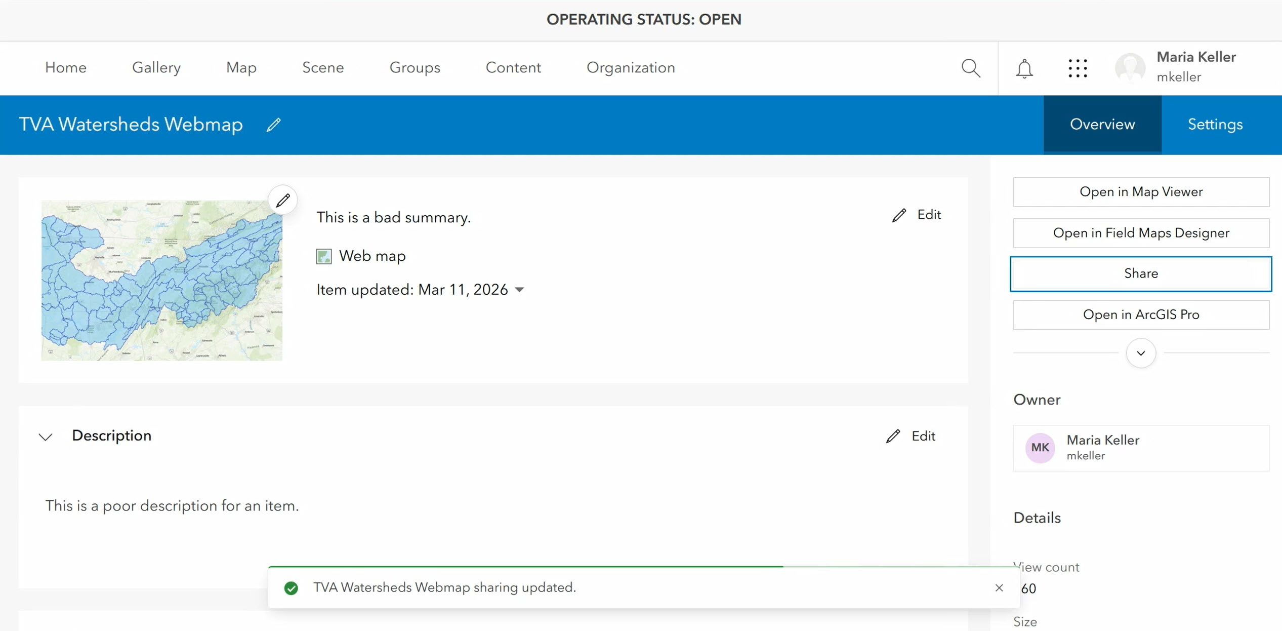

However, enforcing these standards manually can be difficult. To demonstrate the challenge, Bill simulates a user attempting to publicly share a web map that does not meet their organization’s standards.
Bad example of a web map
A web map that does not meet the organization’s standards

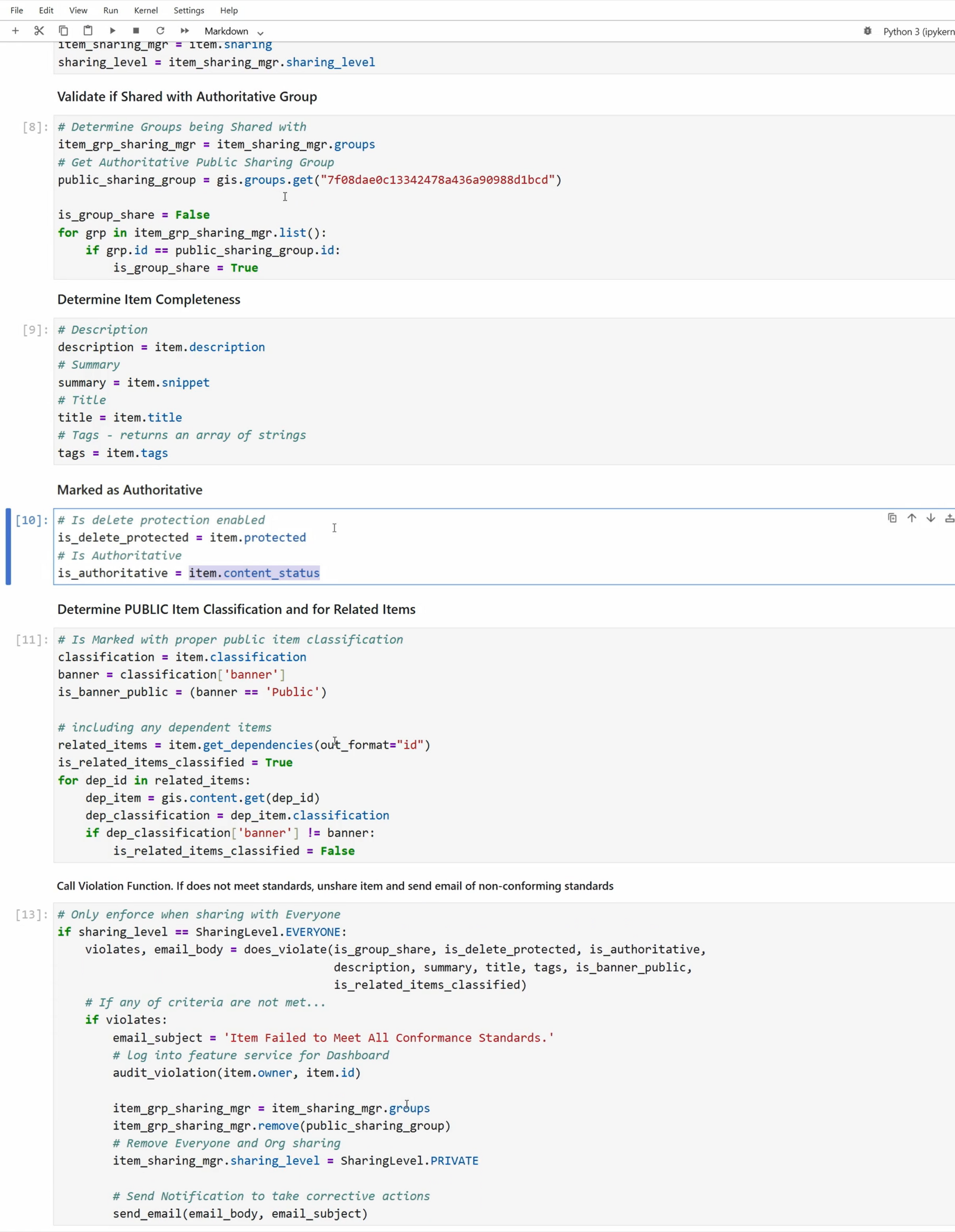

And to address it, Bill creates an ArcGIS Notebook configured to run via organization webhooks, which automatically validates every shared or updated item. The automation checks whether the item:
  • Is shared publicly with the correct group
  • Meets required item details standards
  • Is marked authoritative and delete-protected
  • Is classified correctly along with its dependent items

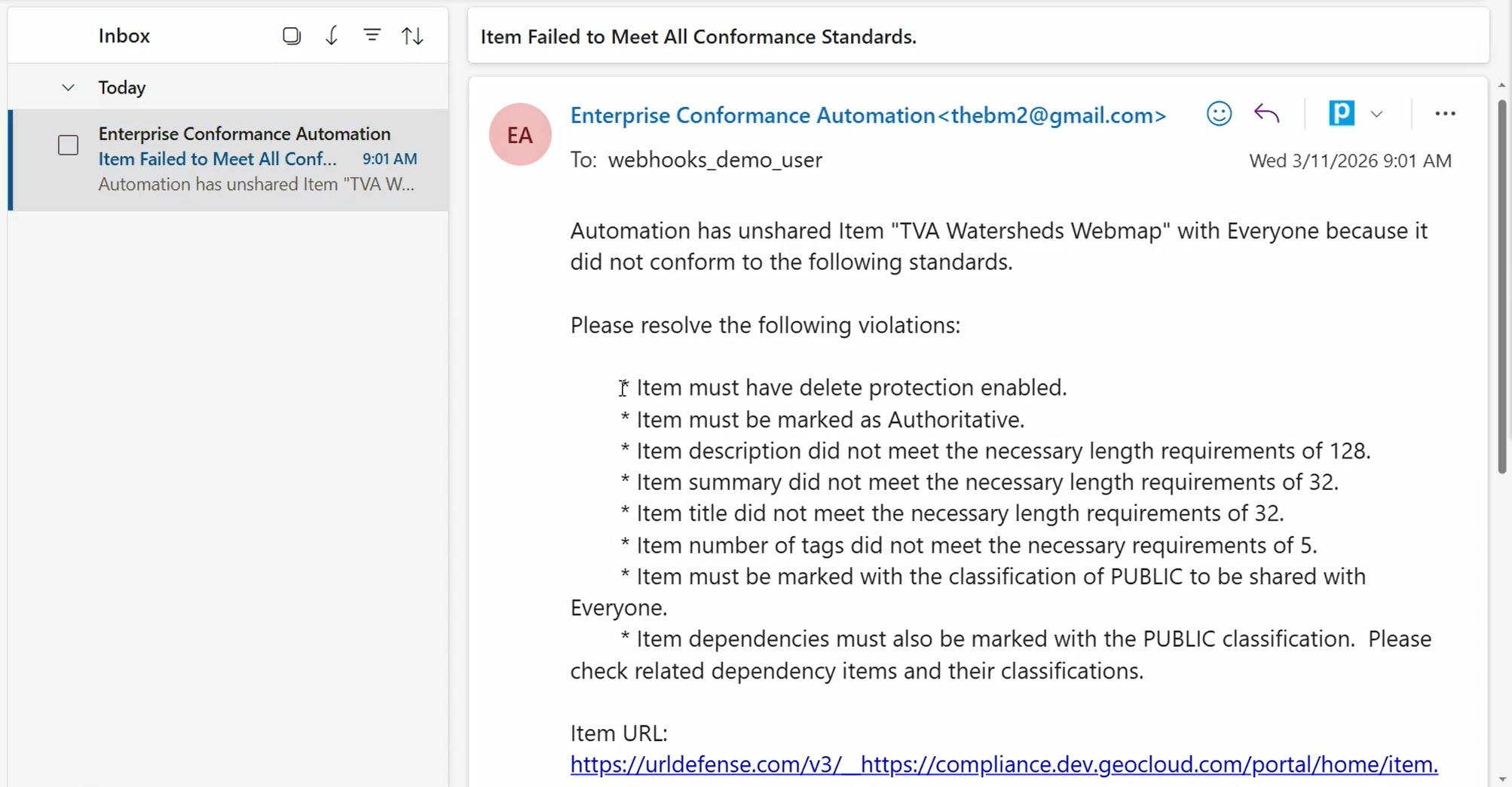

If any of these criteria are not met, the item is automatically unshared, and the user receives an email with clear instructions on how to correct each violation.
Bill's notebook automatically validates every shared or updated item.

The user receives an email with clear instructions on how to correct each violation.
